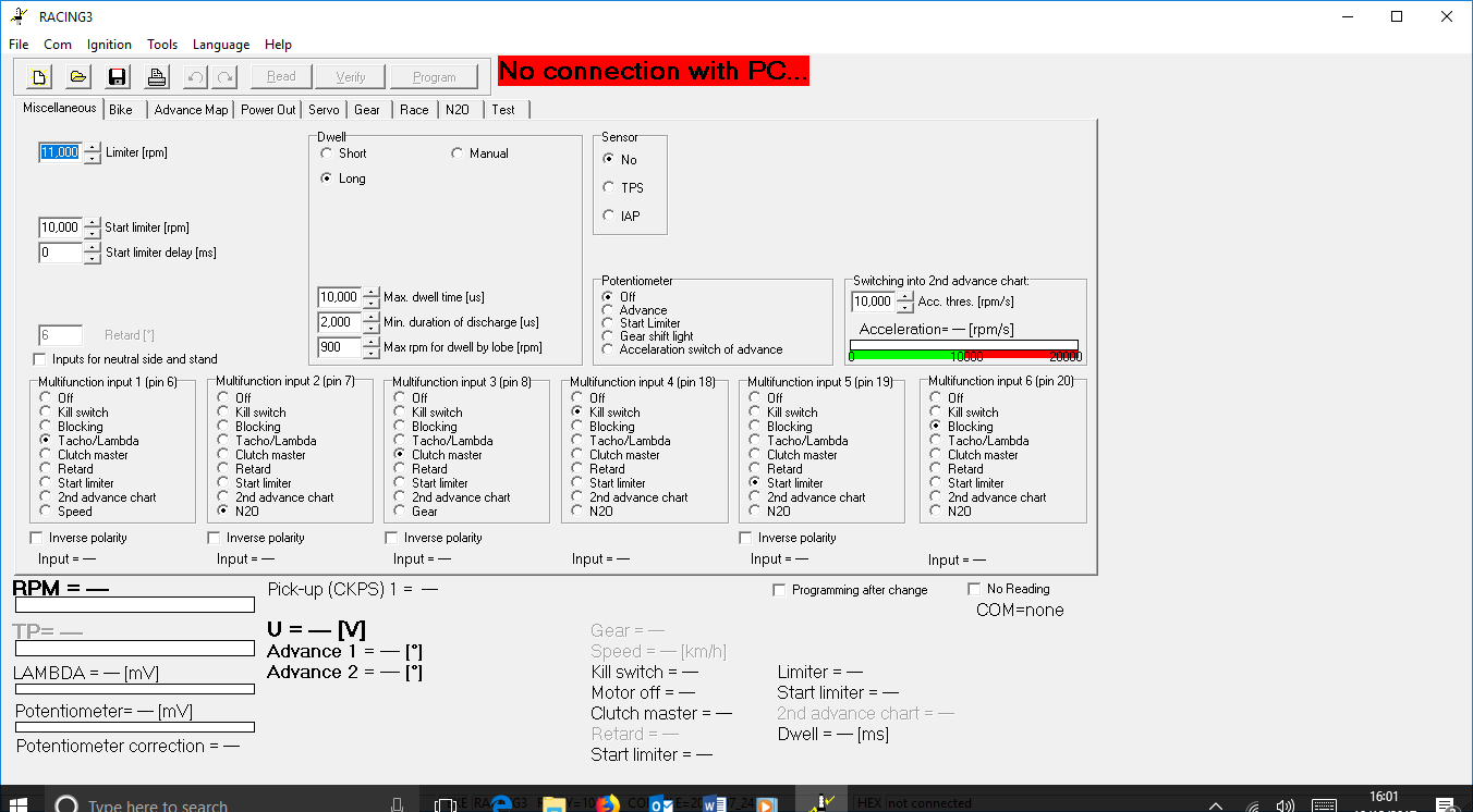

All are programmable with the ignitech as well.
the models are variable with what you can do have a look at their site and see what they do if you download the program file you can see all the parameters you can adjust.
The sparker 3 I am interested in has a setting for n2o So that once the input signal is activated (say at full throttle or as I want it at a specific gear being selected) you can then set at what revs you want it to fire and the duration at which you want it on for.
Rev limiter comes built in as well and is adjustable and it has an input for a throttle position sensor. Its approx £200 depending upon exchange rate. Dyna 2000 £362 at suzuki perfomance parts (but that includes pickups the ignitech does'nt)
Its really a 6 of one half a dozen of the other, Pay your money and take your choice.

Full price lists are there, and if you use their download section you can download the program and open it open your computer to see whats adjustable.
http://www.ignitech.cz/en/stahnout/aktualni-software
See example below.
Kev perhaps you need to type it in correctly
Their website is
See example below.
