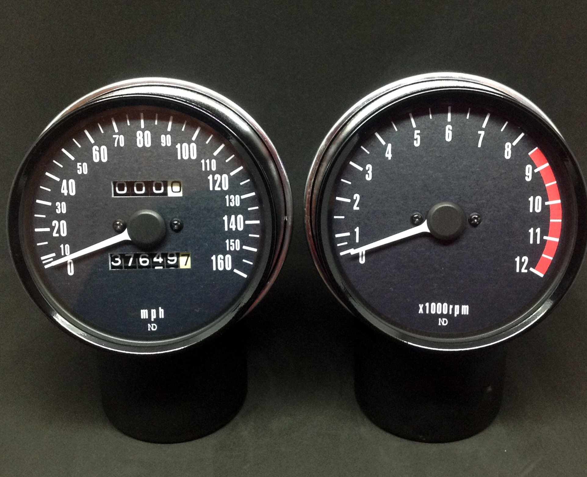

Here's a set fitted to a customers Z1000A2.
I offer them to Z1OC members at a discounted price so please feel free to PM me with your requirements.

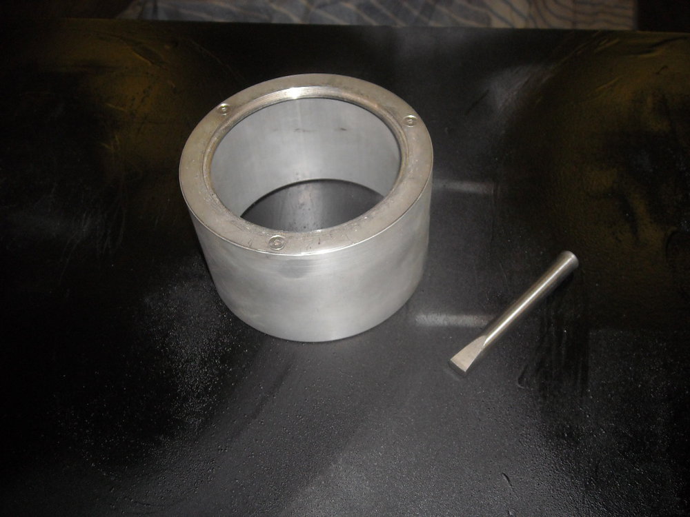

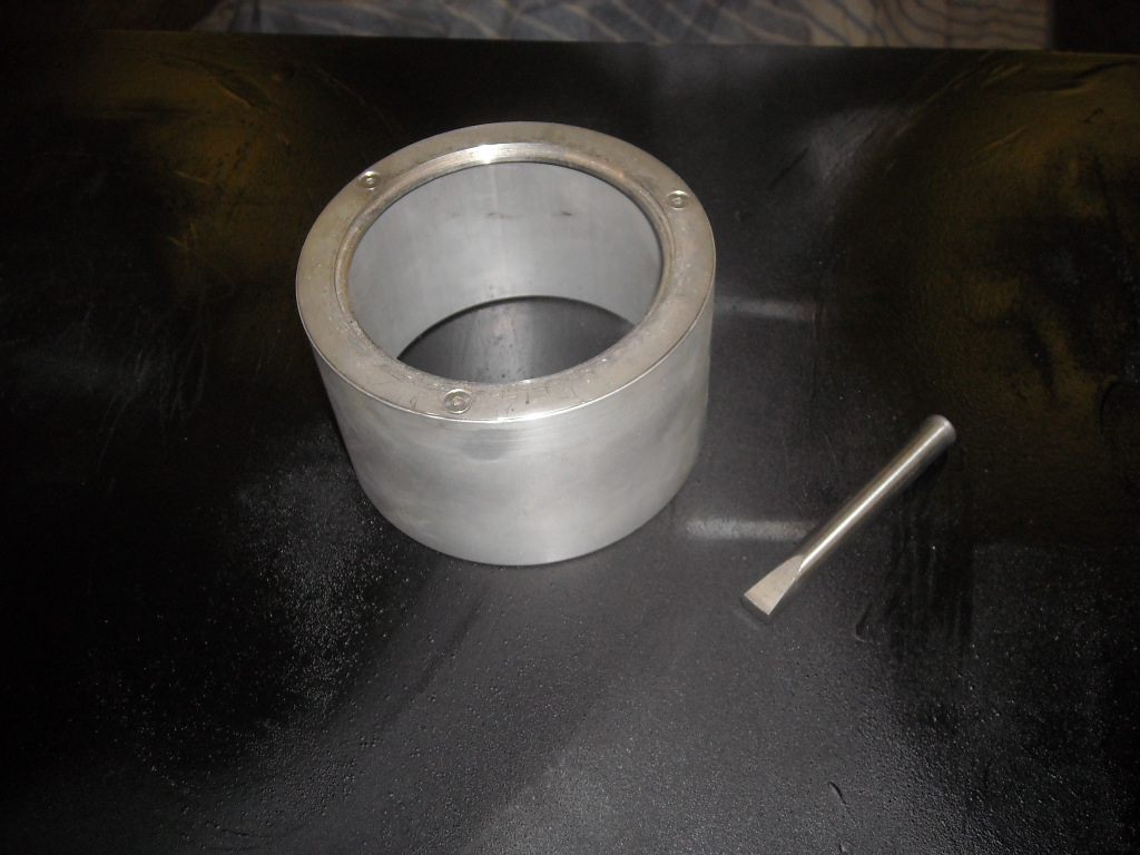

I have a device in metal for the Z1-Z900-Z1000 clocks.( as for the Z1000ST clocks I made a device in MDF board because those clocks are bigger)
I'll take some pictures and send them in my next mail.
Give me a little bit of time.

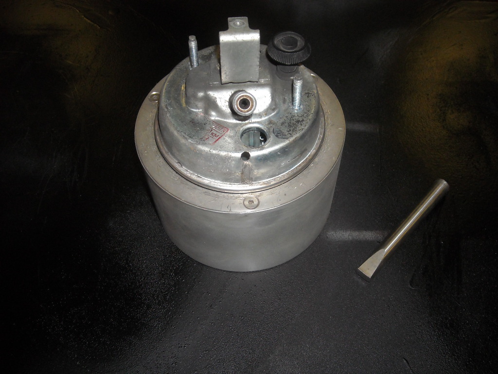

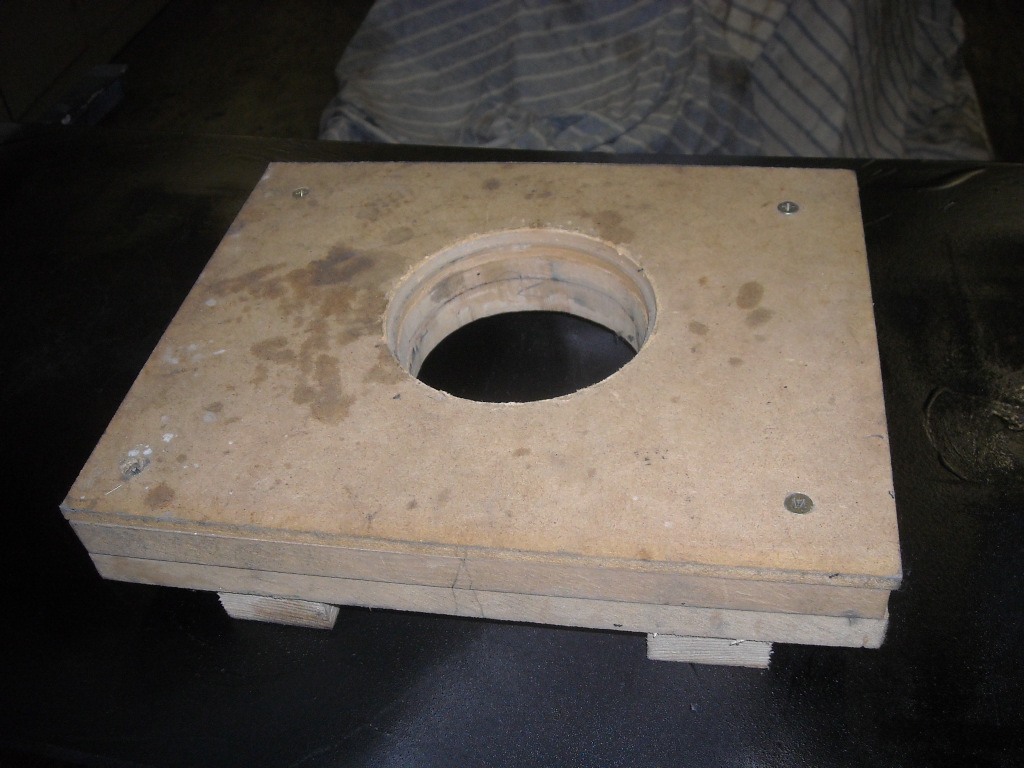

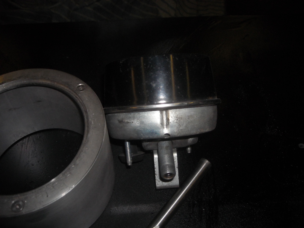

Hi Charly
I,m back with some pictures
The first 3 are the metal "tool", the 4th is the selfmade MDF tool I use for Z1000ST clocks,
If you have any questions concerning the metal tool just ask them, I'll contact the man who made it for me.

Phillipe.
Correct me if I'm wrong, but do you use the dwell to gently tap the crimp ring into position then turn the clock round and do the other side?
If you had two of the metal tools and the spacer the right size, do you thing you could press them together, with fewer tooling marks?
Well thats the theory I was looking at and was going to attempt when I have a bit of free time
Re: z900 a4 clock refurb
Hi glav666
Yes you are right!
I use the dowell to crimp the stainless steel ring around the clock body, usually it takes 3 or 4 complete rounds to get a good result.
When doing so, the clock body and the ring is more or less "pressed" into the metal ring and sits tight.
You have to turn the whole assembly 180°around to get a better access on the other side.
The main thing's are:
1 no tool marks on the upper side and on the visible side of the ring
2 that the clock parts are tightly fitted together.
The underside of the ring is covered by the clock bottoms. For me it's not possible to leave no marks on the underside.
You would be amazed if you knew how many clocks were allready opened for repair and closed again.
If you want no tooling marks at all, the whole should be mounted on a lathe and spun around and then you would need some sort of device to press against the stainless ring to bend it...in theory that is. Seems rather costly to me for the few times you have to use it.
When you do clock repairs as a profession you need offcorse a better way to close them compared to the way I described at the top.
Perhaps you don't know how spoiled you are in the UK with the cottage industry. In Belgium we don't have a cottage industry so we have to find a solution: repair it ourselves or replace it with a new one. The repro clocks look stunning but I don't know their quality. So I choose to repair the old clocks myself.
Hope you got your answer.
Good luck
