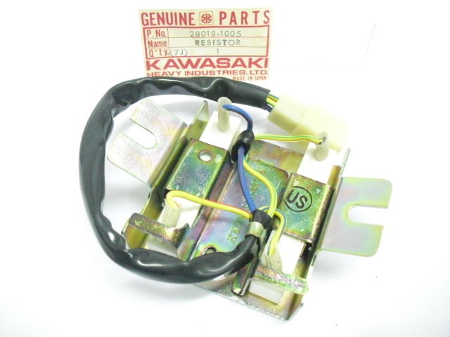

Next part. What's it do and do I need one ?
Part number 28018-1005 (RESISTOR)

Hi Steve
I think you only need one of these if you have a Z1R with an MK2 engine and electronic ignition.
I think it's the bracket to put the resistor for the ignition coils on. Allthough I'm not sure about it.

it is the resistor for the headlight circuit & reserve lighting relay
Re: What Does This Do Part 2
Pretty sure it was only fitted to the Stateside variant as uk bikes had no requirement for reserve ligthting. Paul ?

Z1Bman is right!
I made a mistake, it's the resistor for the light
Keith is right too, you only need it when you have a KZ, the US version, since the European version doesn't have a reserve lighting device.

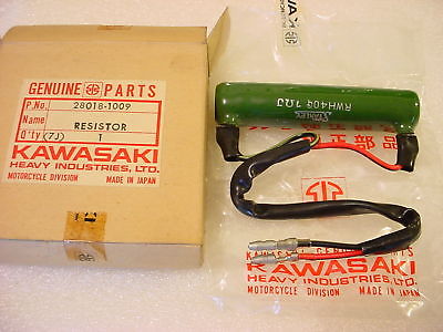

Correct me if I'm wrong but the European version had a resistor for the light , a green tubular one, attached under the fuel tank to prevent that the light bulb would fail if too much tension was transmitted to it...

Hi Steve
the reserve light is the normal light bulb and the electronic reserve lighting device switched the low light to the high light if the low light failed. You didn't have to turn the light switch from "lo" to "hi", it was done automatic by that electronic device. At the same time a white warning light went on in the rev counter to inform you that the low light failed.
It was ment to warn you that the light bulb needed replacement.
That is on the KZ, the US version. The Z, EU version, didn't have a white warning light in the rev counter.

Philippe wrote:Z1Bman is right!
I made a mistake, it's the resistor for the light![]()
you mean like this one
- Attachments
- s-l400.jpg (26.13 KiB) Viewed 5772 times

yes, something like that. Allthough I don't have an EU parts list, only one for a US version of the Z1R, so I don't know for sure if it was used.
Anyway I don't have it on my Z1R (D1, '78) and the light bulb is OK after several thousand kilometers. It's an H4 bulb, maybe that makes the difference?

the resistor is located between the ignition coils if its a us spec bike if its uk spec it will just have the green coloured one bolted to the r/h coil
