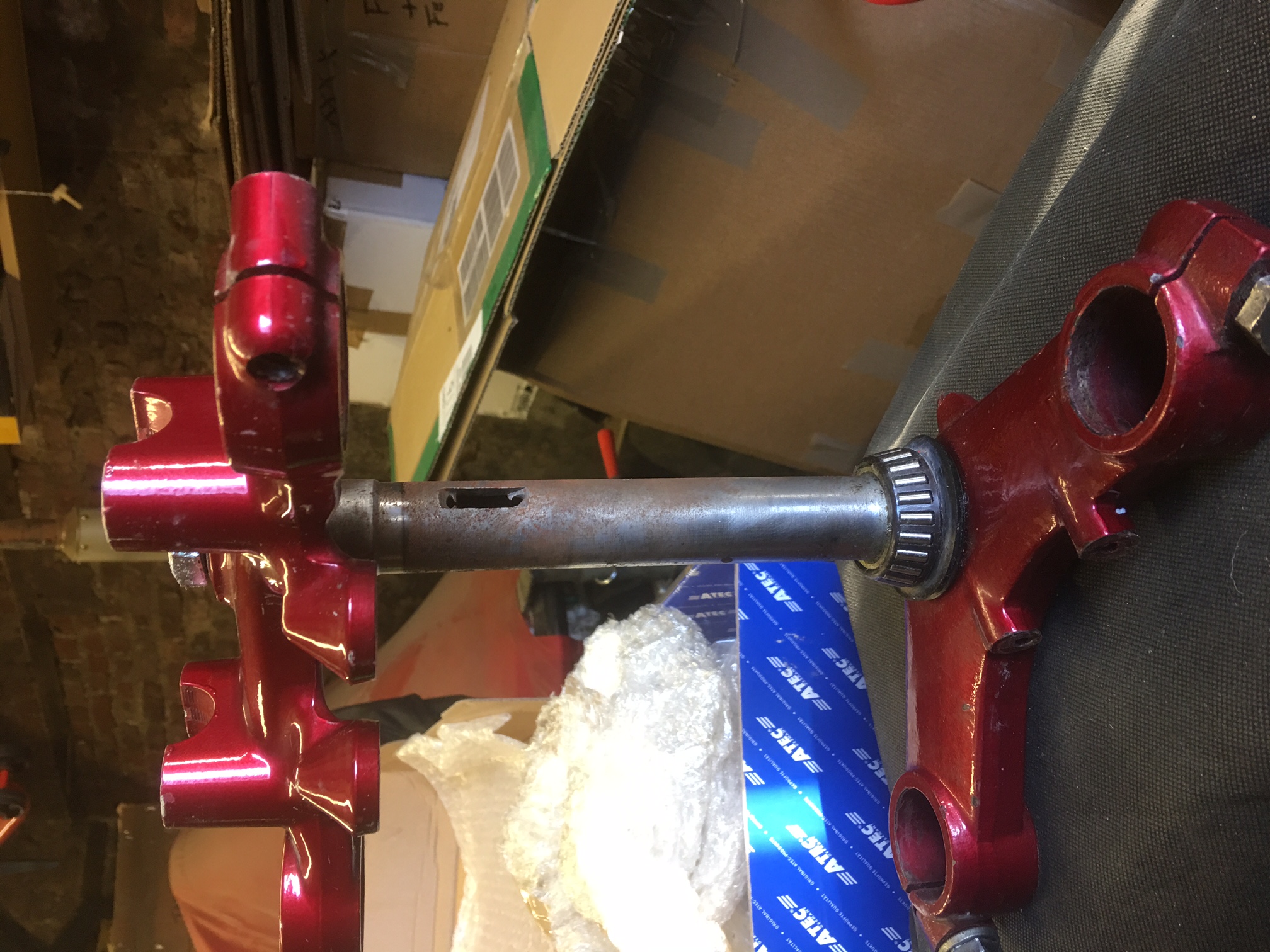

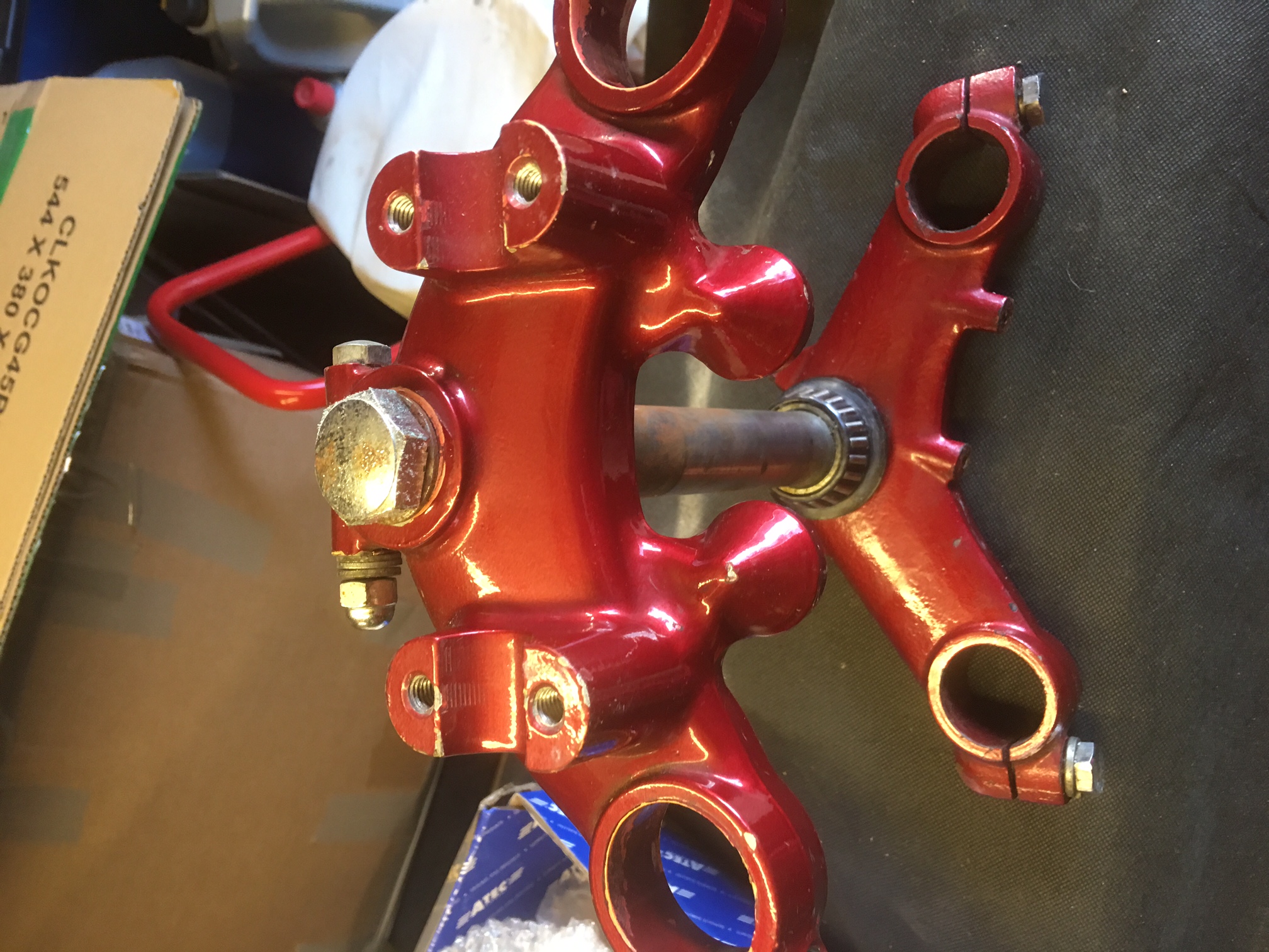

Does anyone know the differences between D1 and D3 tree's, they have different parts numbers?
Perhaps change of rake to suit the 18/19" wheels?
It's the Ozzie one's, the type with steering lock thru the frame on the RHS into stem tube.
Thanks in advance.

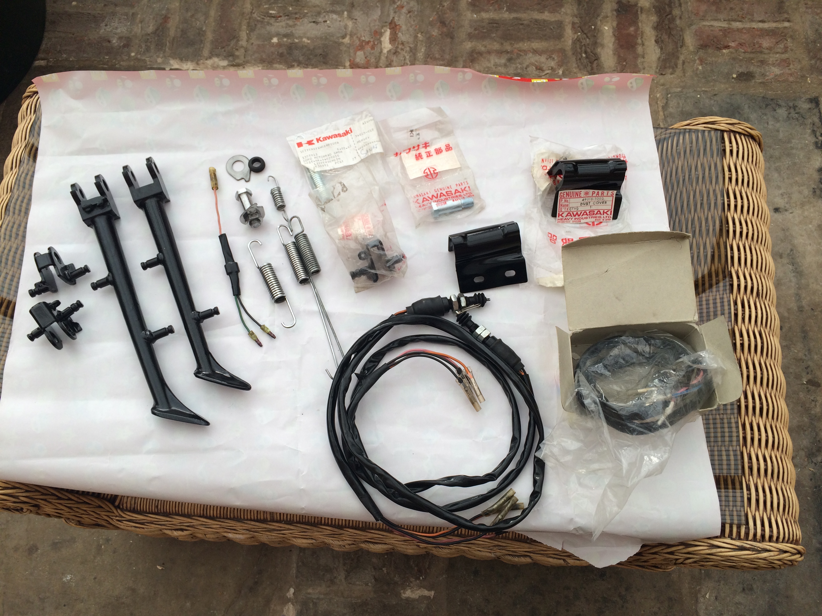

Is all the extra parts in 3rd pic the dreaded side stand switch bits?

yes it is ross and there's a few other bits missing from that photo and the like

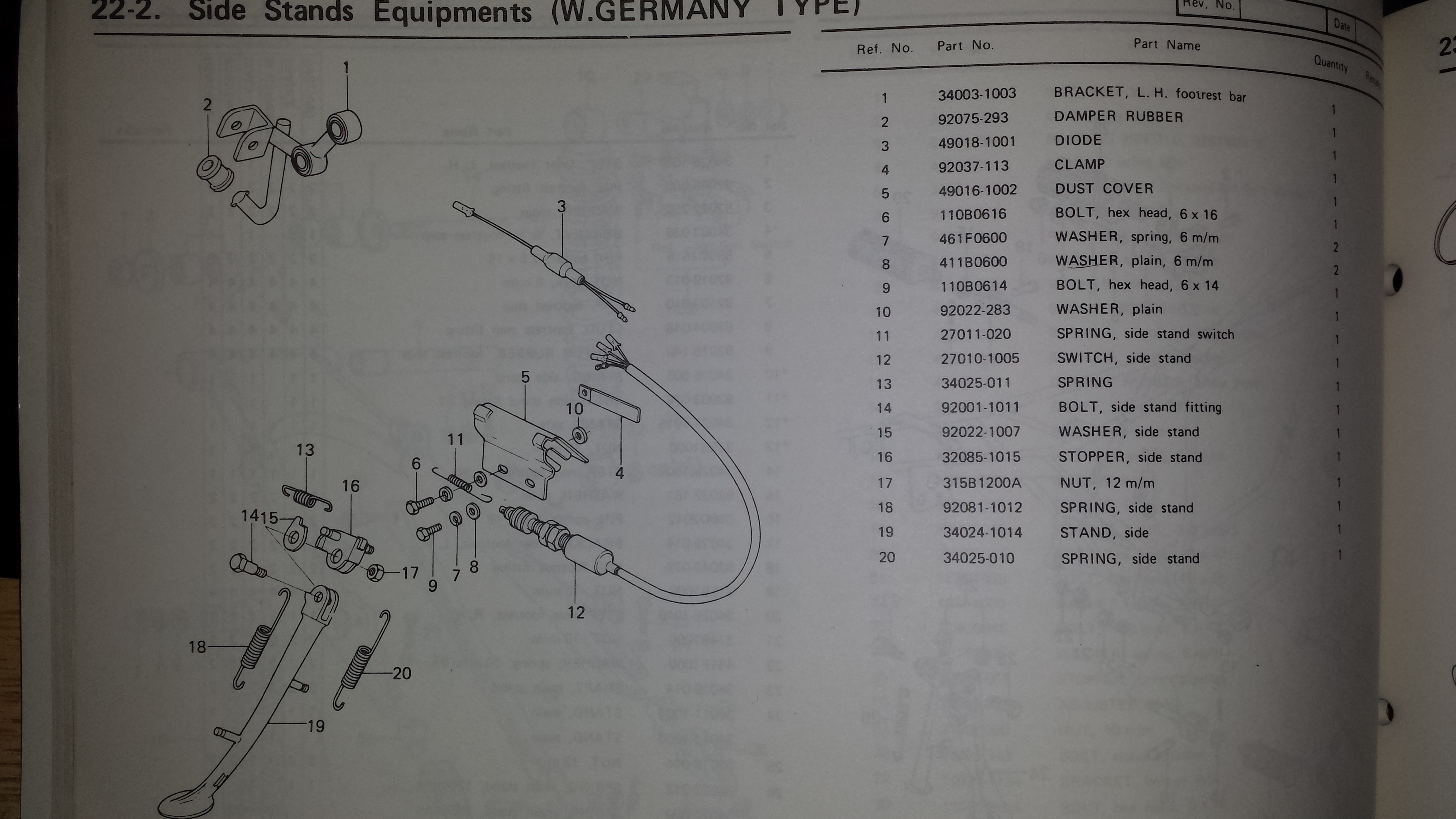

the same lock is fitted to these models including the d3 but it isnt shown on the frame schematics in the parts book its shown in the ignition switch & locks section
lock assembly part no 27016-5009
