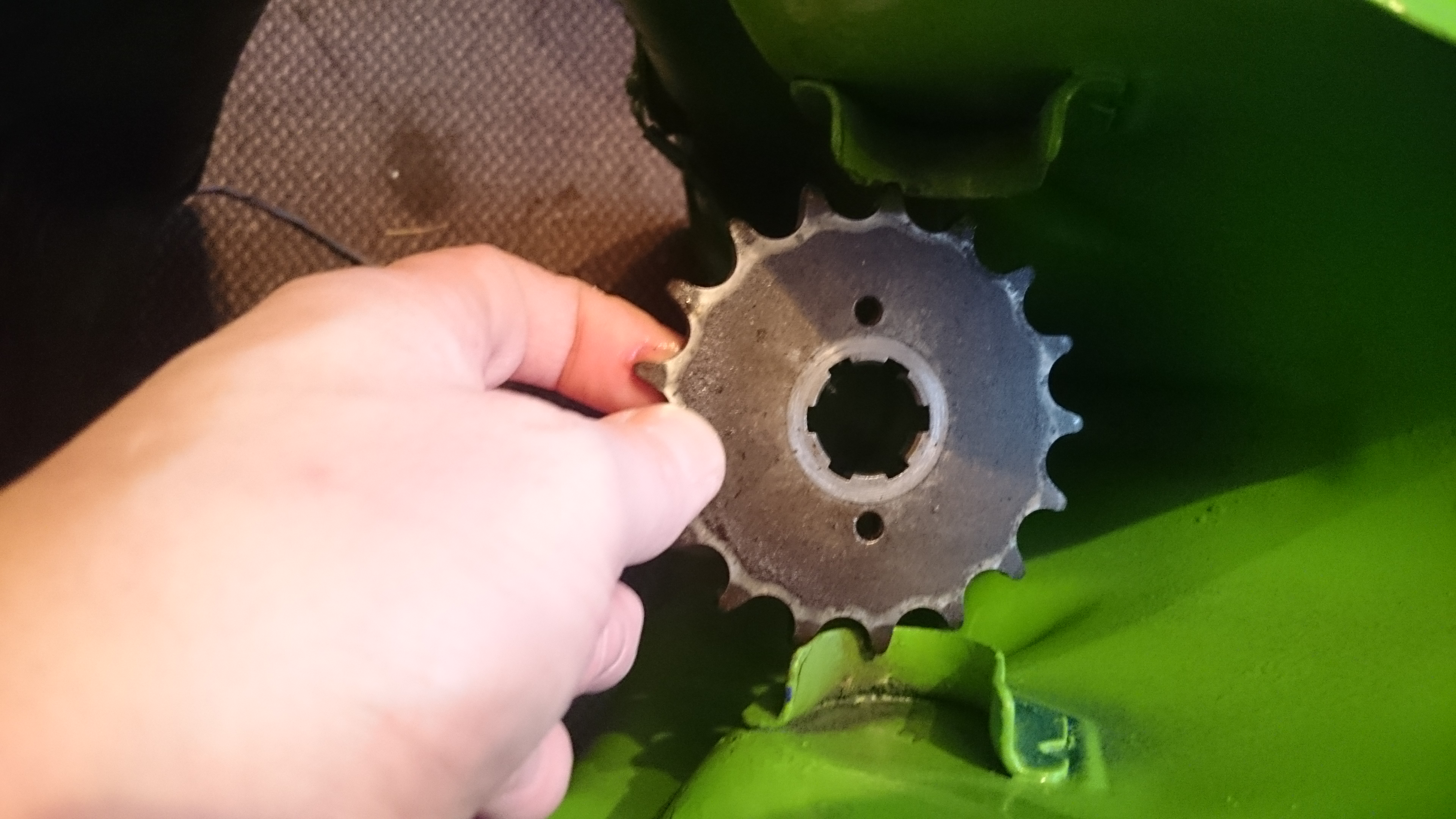

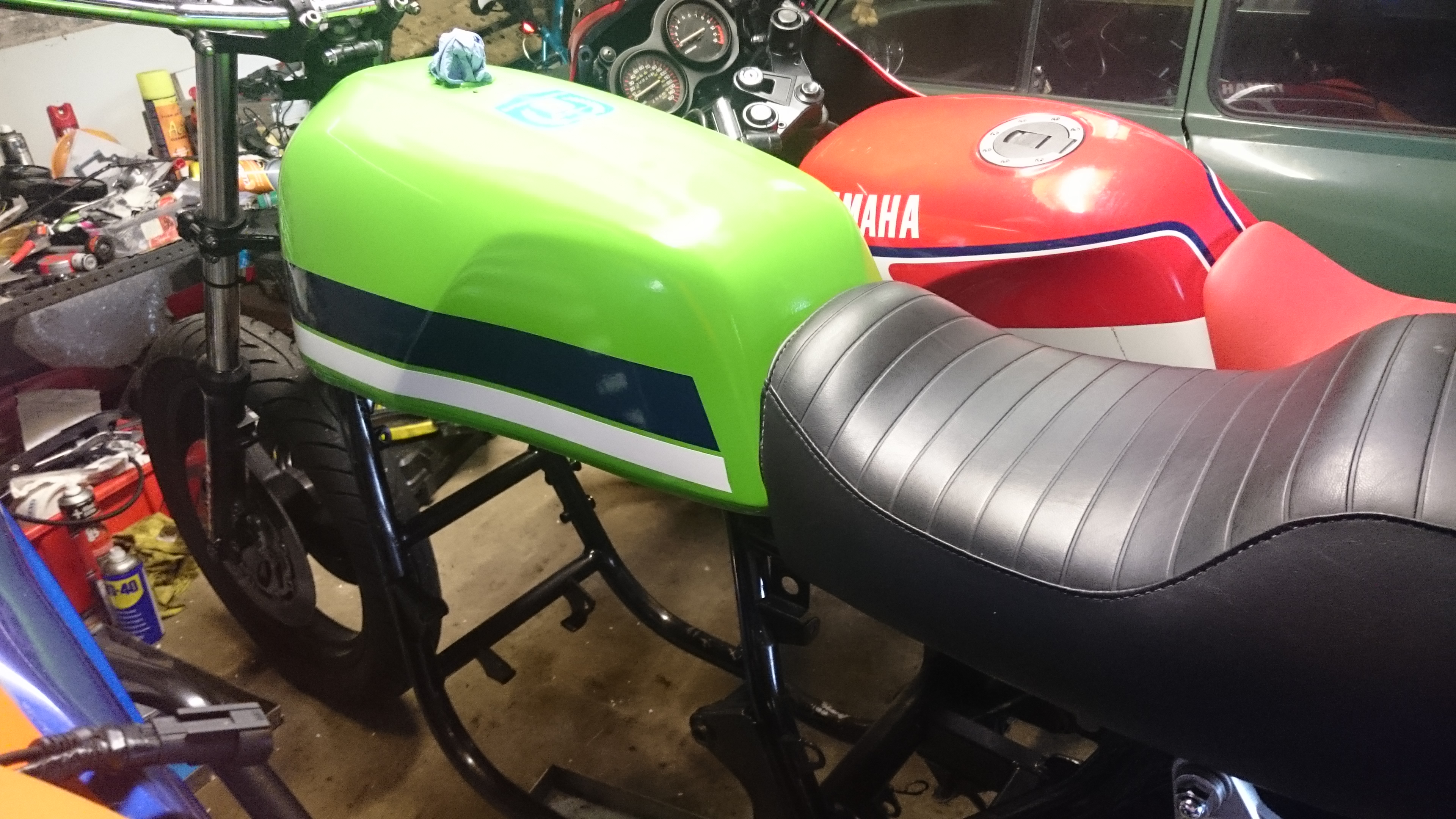

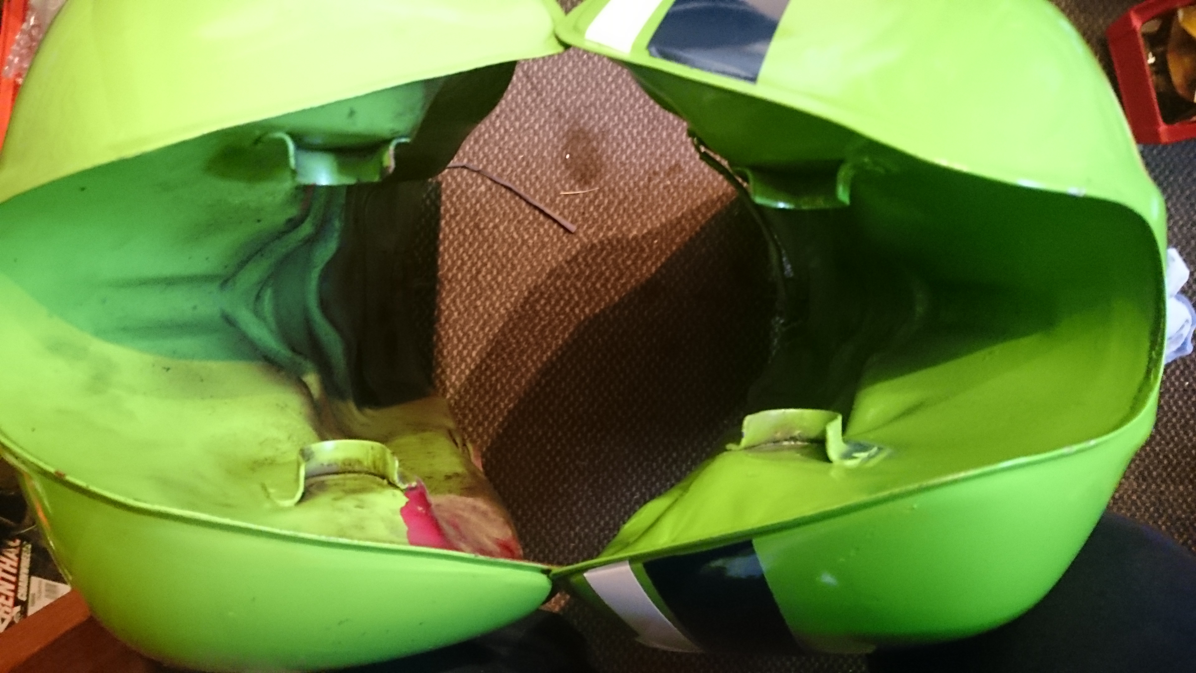

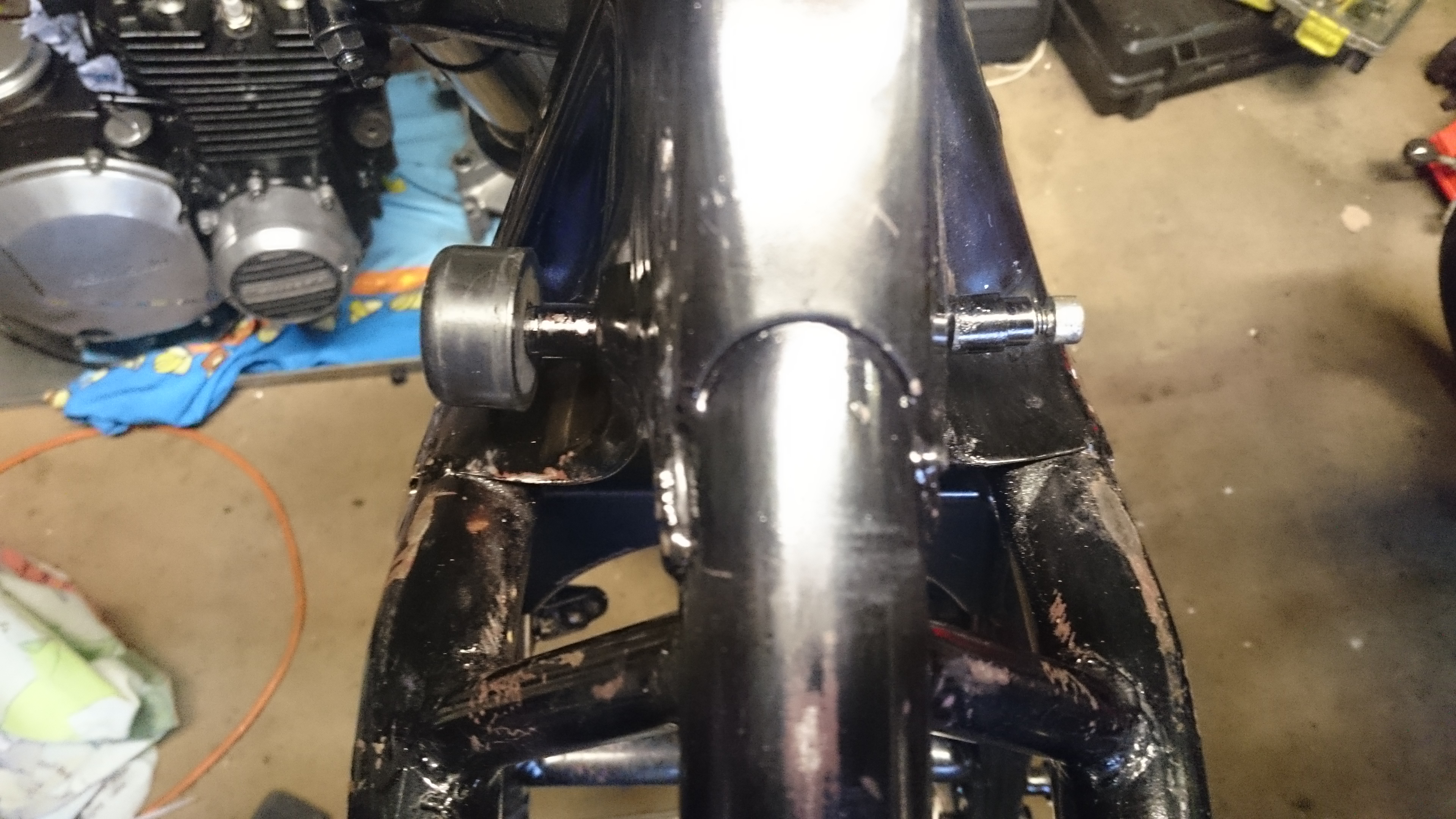

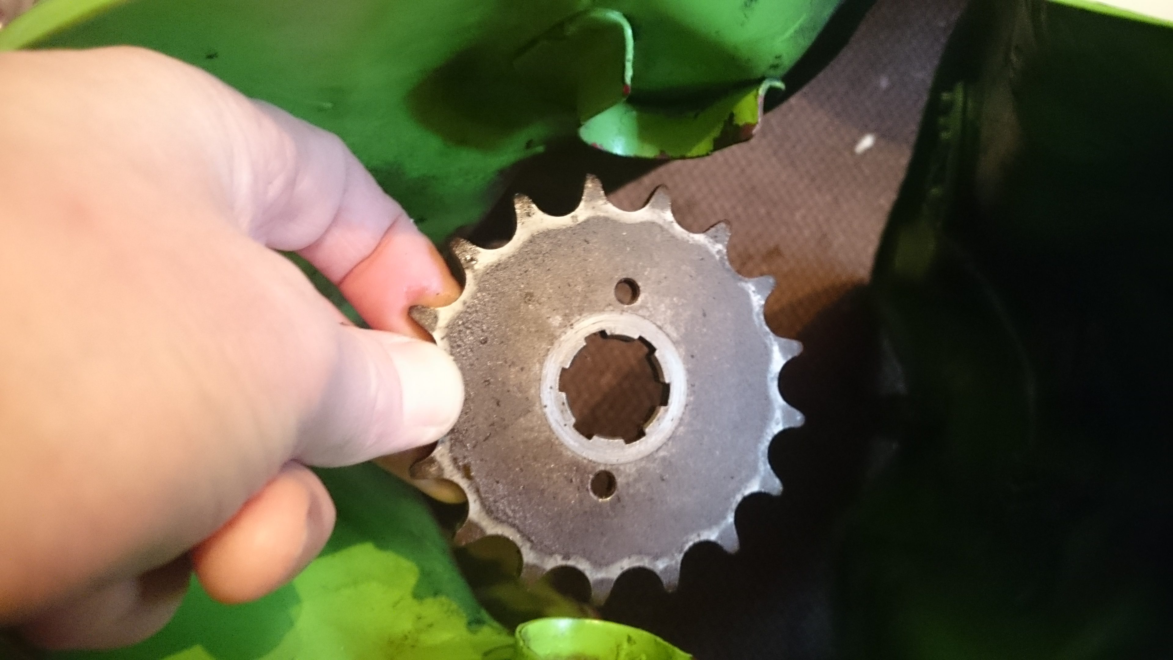

#8 PostAuthor: Coose » Wed Jan 10, 2018 4:01 pm
rickm wrote:I'd be interested to know how this turns out.
I have a US round tank J, and I'd assumed that the frames were the same as Euro spec.
I've just acquired a square GPZ tank as a spare, but haven't offered it up to the frame yet and so now wondering whether it'll fit !
I now have a simple answer to that Rick - for some bizarre reason the front tank locating stubs are longer on a US frame (why would they do that?)!
Following some welcomed input from the KZ1000J Facemuck page it was confirmed that this is the case. So, as my frame has already been butchered and is going for powder coating soon I have just trimmed 10mm off each stub, then drilled and tapped each to M6 and have used short allen screws for the US tank, removing them for the square tank. The tank rubbers just squeeze over the shoulders of the stubs for the square tank (see below), and with the OD of the M6 allen bolt heads being 10mm they are the same as the stubs so all is fine!
I did wonder at first if it was a GPz750 tank or something....
Today I printed off your dimensions for the round tank decals Rick but I never had the chance to measure them. Hopefully I'll do that on Friday. :)
Tank differences: -
Square tank spacing (sorry, the nearest thing to hand was a sprocket!): -
Round tank spacing: -
Square tank fitted: -
Modified stubs: -
