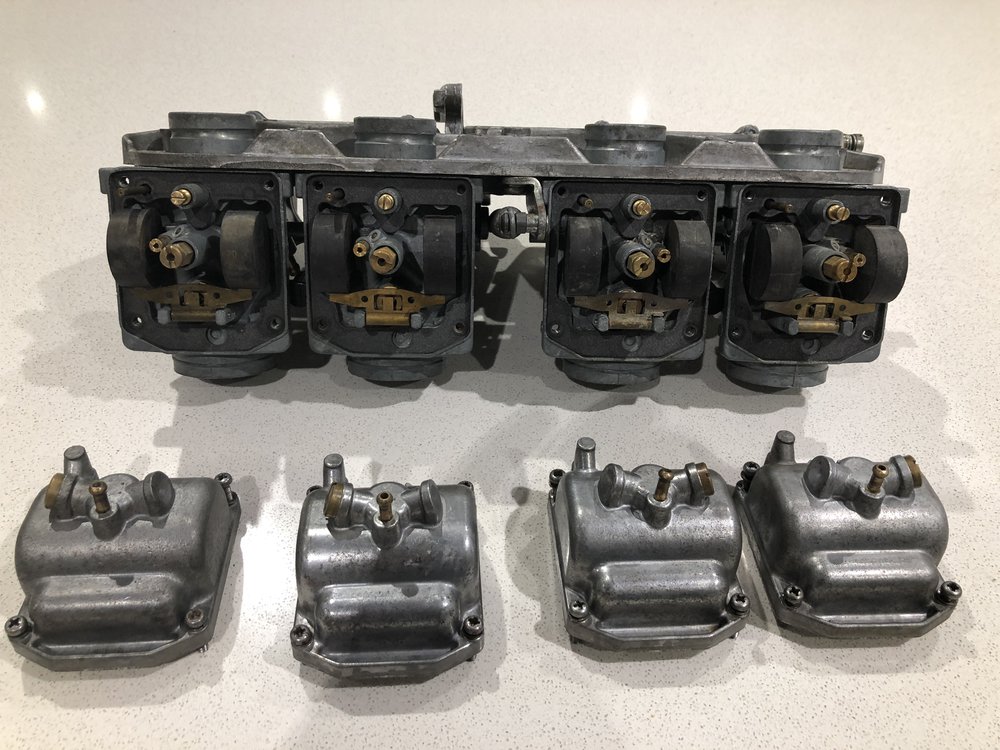

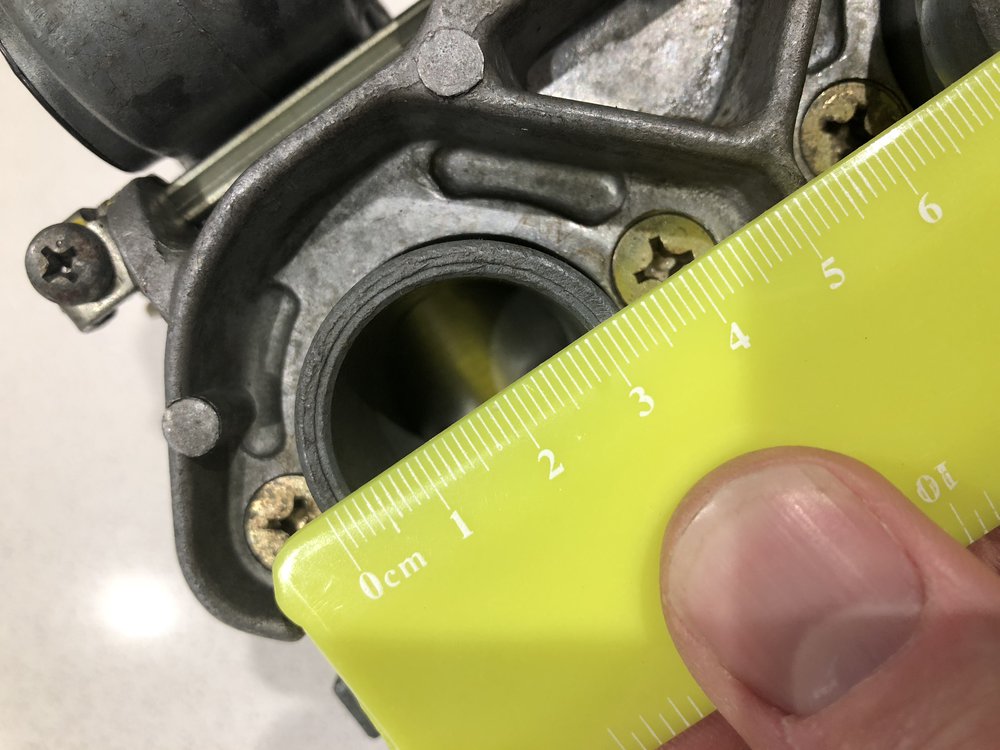

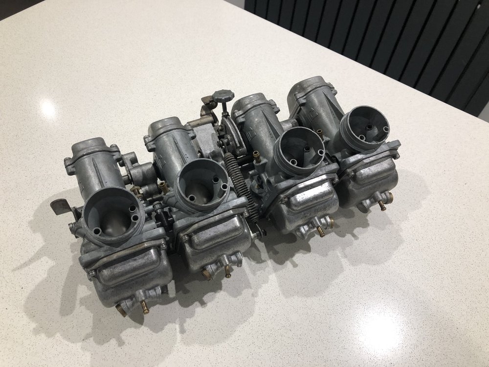

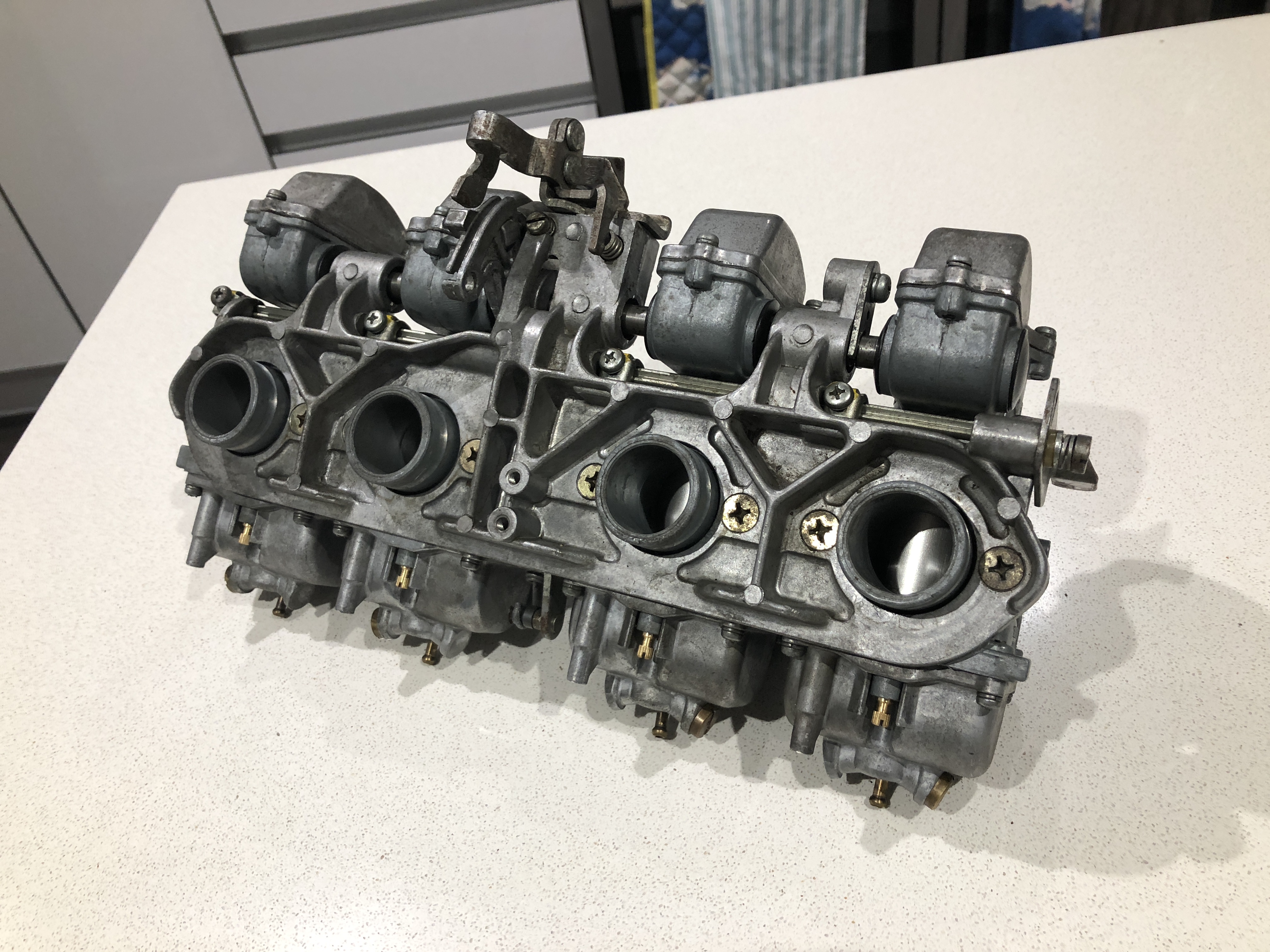

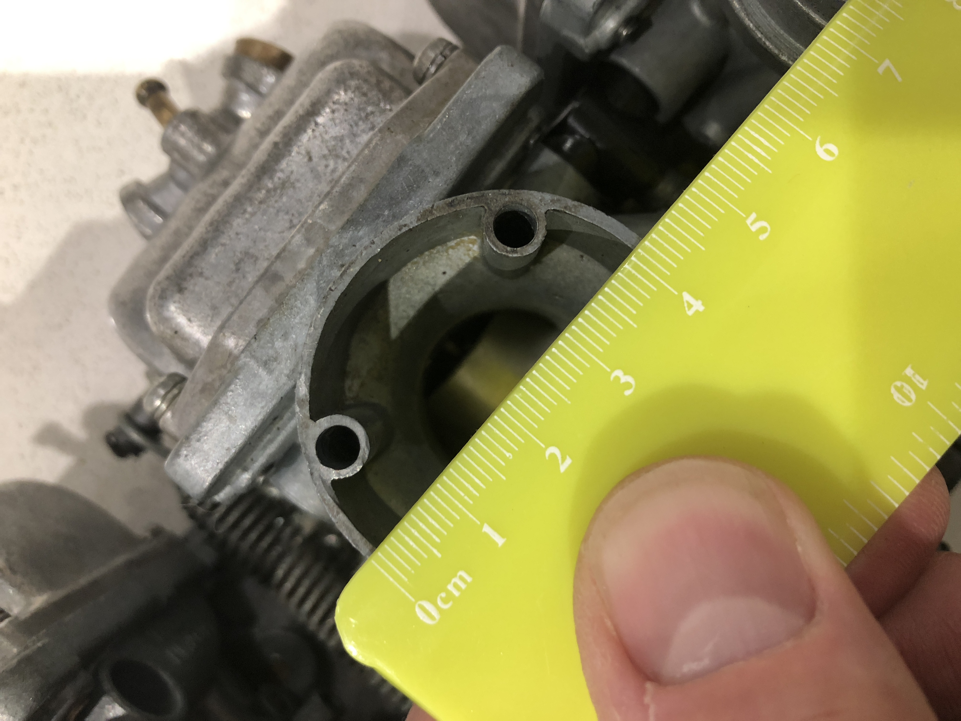

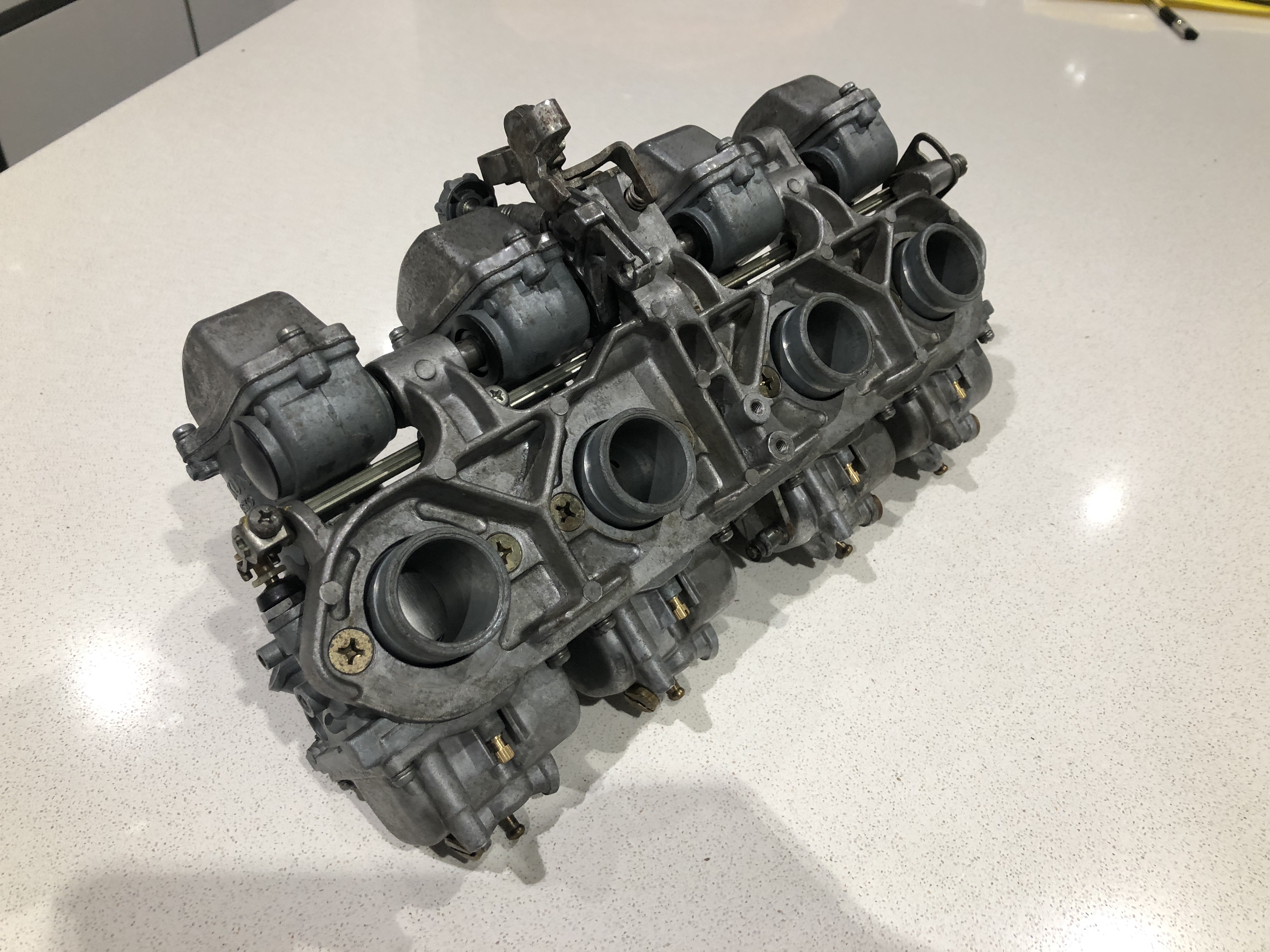

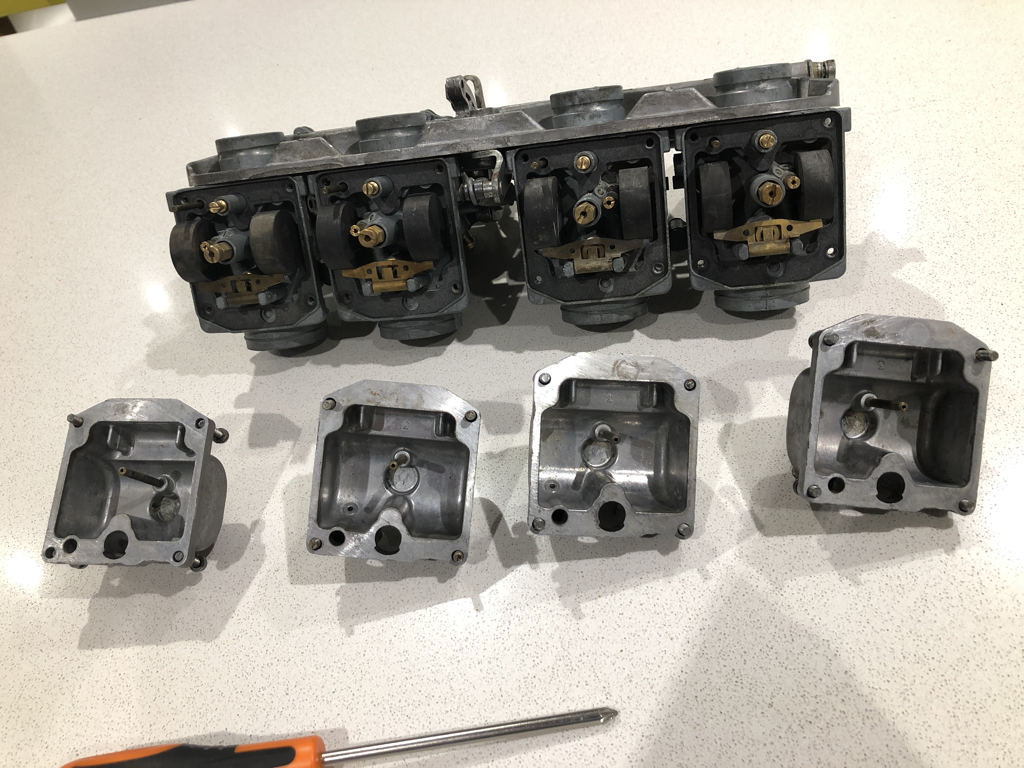

Evening guys - have come across a spare set of carbs I'm looking to sell and want to make sure I describe them accurately / for the correct model.
I think they were from a KZ1000 A1 project I had a couple of years ago. Can you guys help confirm what model they are for, from the atfaced pictures please?
Many thanks, James.

yes they look like the vm 26mm ones they fitted to the a1

I think these are A2 carbs, look at the copper tube on the third carb body, it's ment to put the hose on for the vacuum fuel tap.

They are definitely 26's for the A2, vacuum stub on number 3 for the tap, i have a set that are just sitting on my desk all cleaned and just doing nothing.

Yep a2
