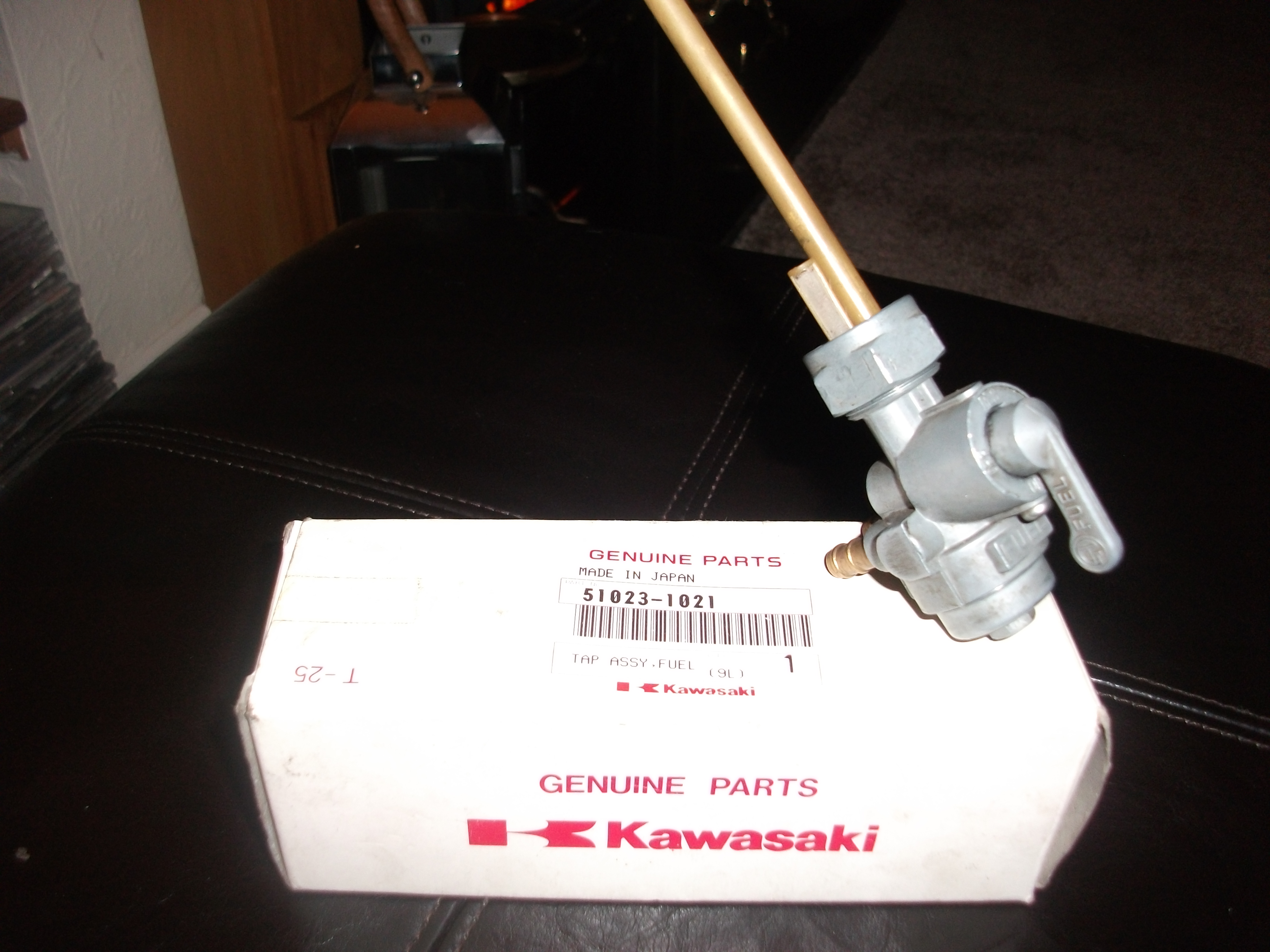

Guys Going through some of my bits have found a boxed fuel tap,it has fuel logo raised on the lever according to the Hesse book its for z1a/b the z thou a1 which ties up to the box number has no raised logo again according to the Hesse book,any input.looks not to have any use but looks like it may have been fitted at some point.what would this be worth? Ta Paul J

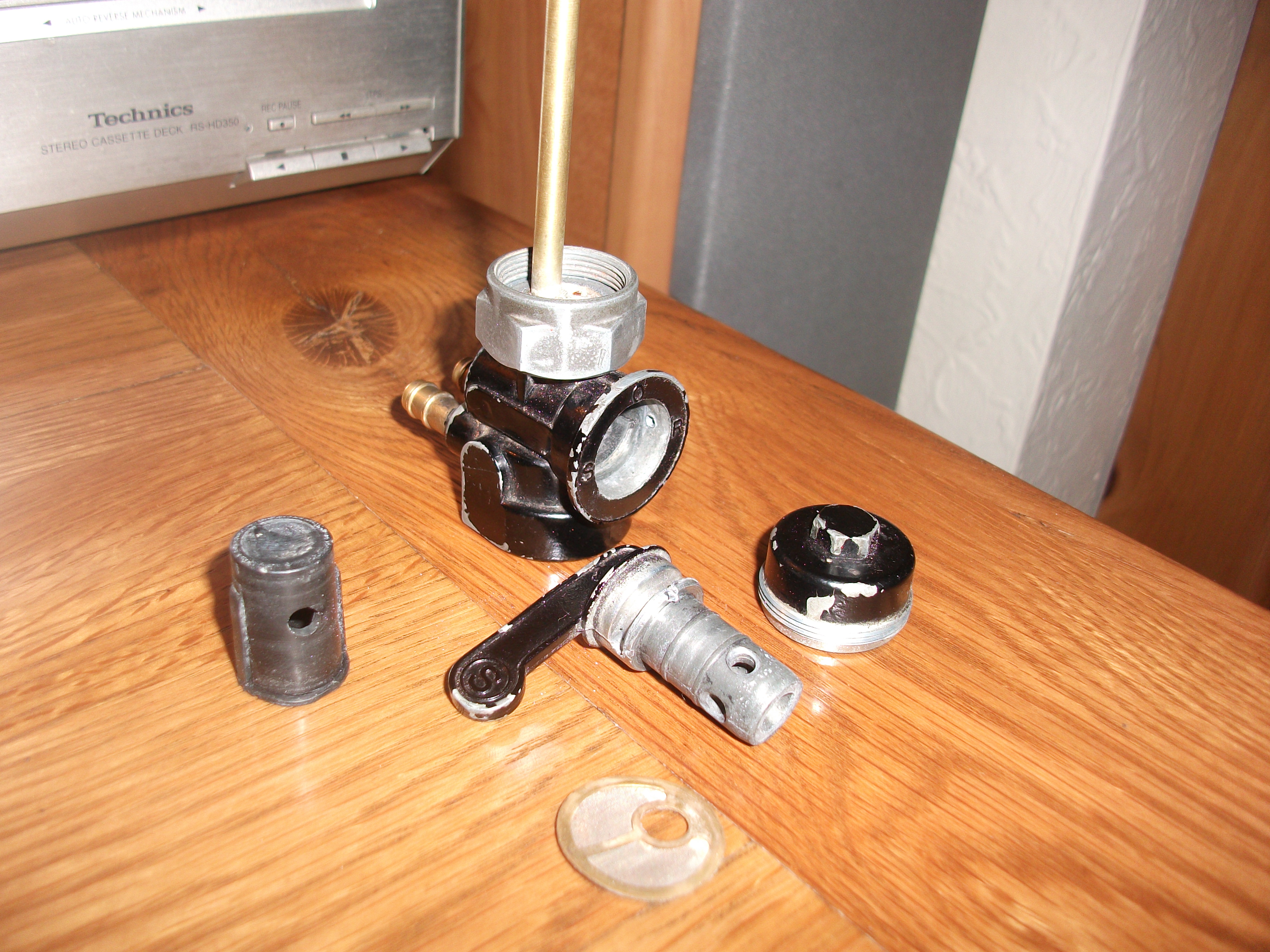

The one on the box is the original one i was talking about,the black jobby? Z1 or Z1a?

hi Paul .I would suggest the new one in the box is Z1a/b and the black one z1 72/73 ..... I may be wrong

Bare metal one is off a Z900.
Black one is off Z1 or early Z1A.
Z1B is same as black one but unpainted.

Unpainted fuel tap was new to the Z1b.
All Z1a were originally black.

ADRIAN H wrote:Bare metal one is off a Z900.
Not Z900a4 Adrian fuel outlets are at right angle as per Andrews pic.

Parts book on net says KZ1000a ?

Re: Fuel Tap id
PAULJAC47 wrote:ADRIAN H wrote:Bare metal one is off a Z900.
That is intriging as I have two boxed fuel taps at home.
One has fuel outlets at right angles which when I checked the numbers came up as off a Z1000P.
The other has both parrellel out the rear, which when checked umbers came up as off Z900A4.
Oh well suppose boxes could have got swoped, somehow ?
Re: Fuel Tap id
Starting to think mines in the wrong box too?
