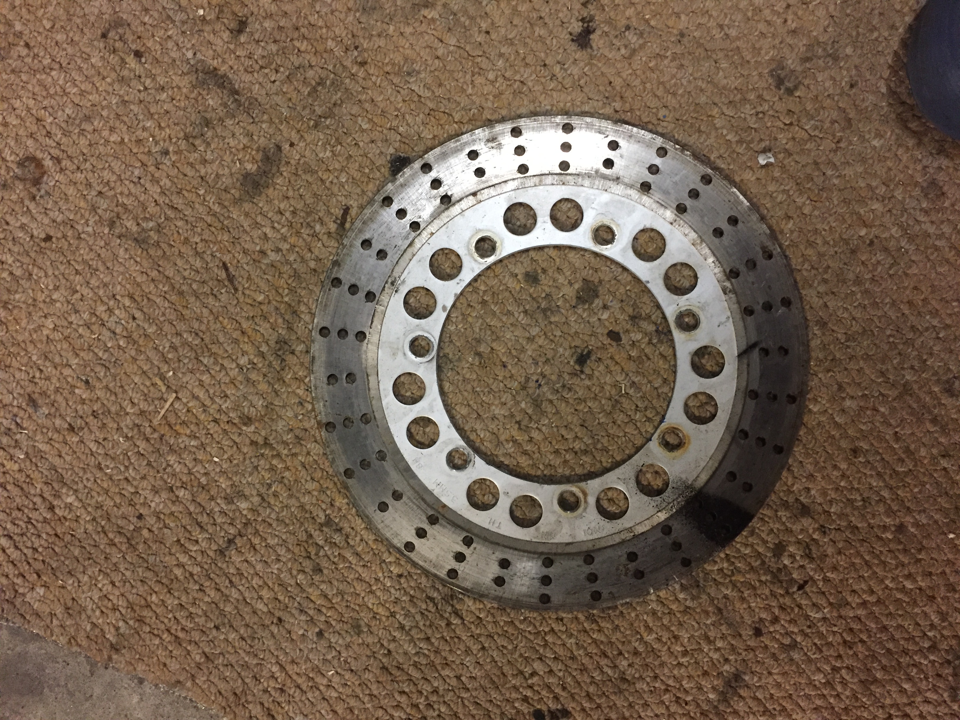

Anyone out ther know what this disc is actually of, it was taken off a Z1000J front wheel but I am not sure if it is the correct one for the J ( this size wheel is used on many Kawasaki’s)
Dia : 270mm
Thickness: 4.5mm
Fitting : 7 point fit

That'll be GT550 Gavin. They're identical other than being 1mm thinner.

Cheers mate
