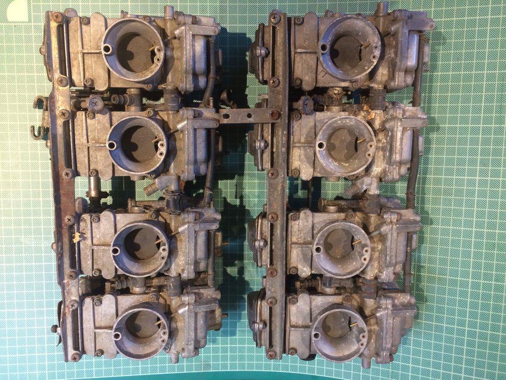

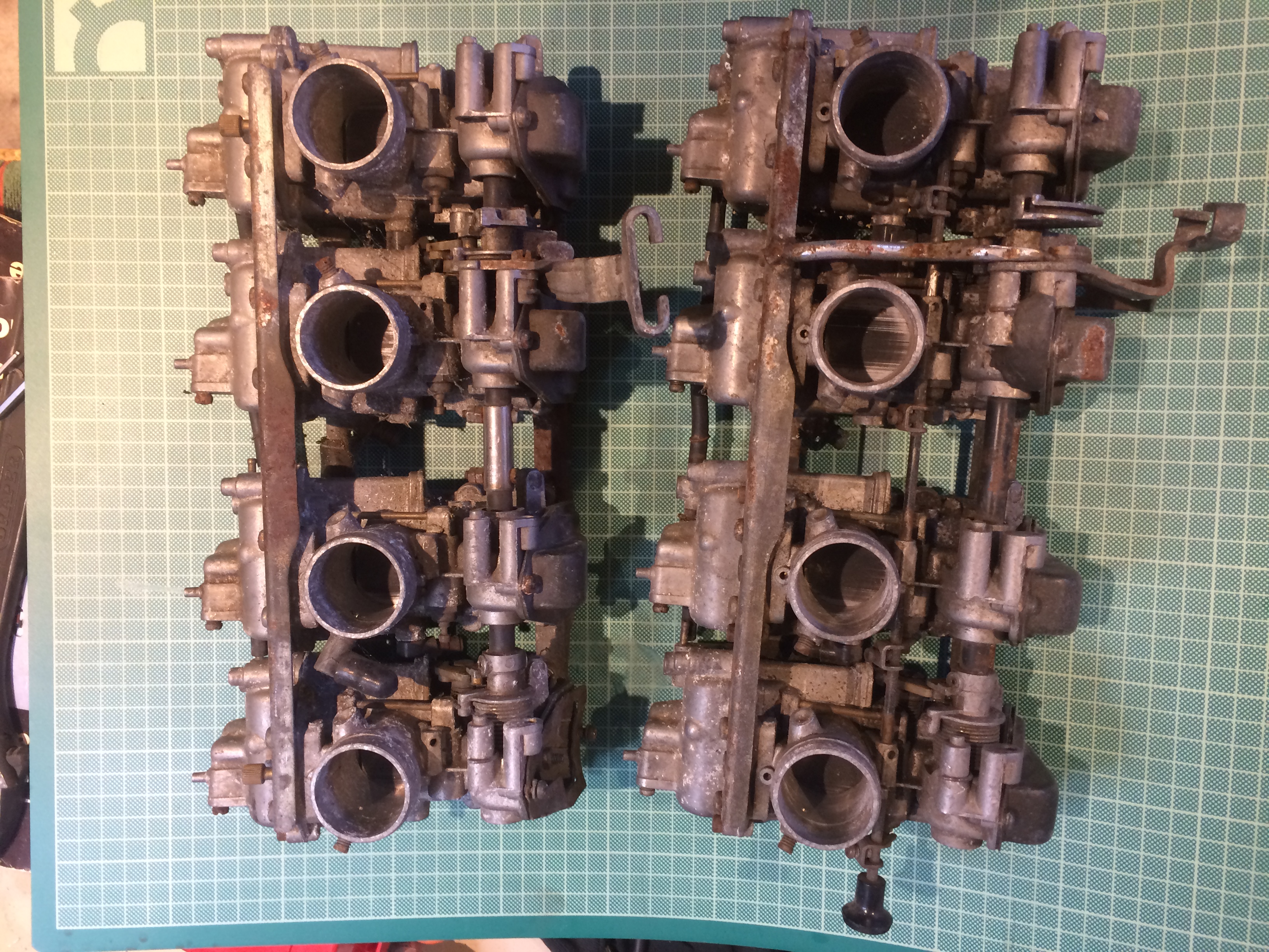

Can anybody tell me more about these, they are Mikuni and appear to measure 33mm?

Look a bit like Mikuni's off an earlier GSXR?

If they are 77-93-77 carb spacing they are gsxr ....... the early flatslides were 28mm but easily modded to 33mm by removing the fronts and boring out
They work well on zeds

definitely look like gixxer carbs Gus..it looks like Baldrick's mate manky Phil might of unearthed them tho!!

Yeah they came in a dirty box of bits not sure if one good set could be made out of them.
The centres don't seem to match up perfectly but there are some bodges on them which would probably explain it.
Ebay or bin :roll: as I don't have a scooby about them?

Depends on how much spare time you have, and whether you like cleaning carbs.
Or could just list them on eBay - parts only ?
