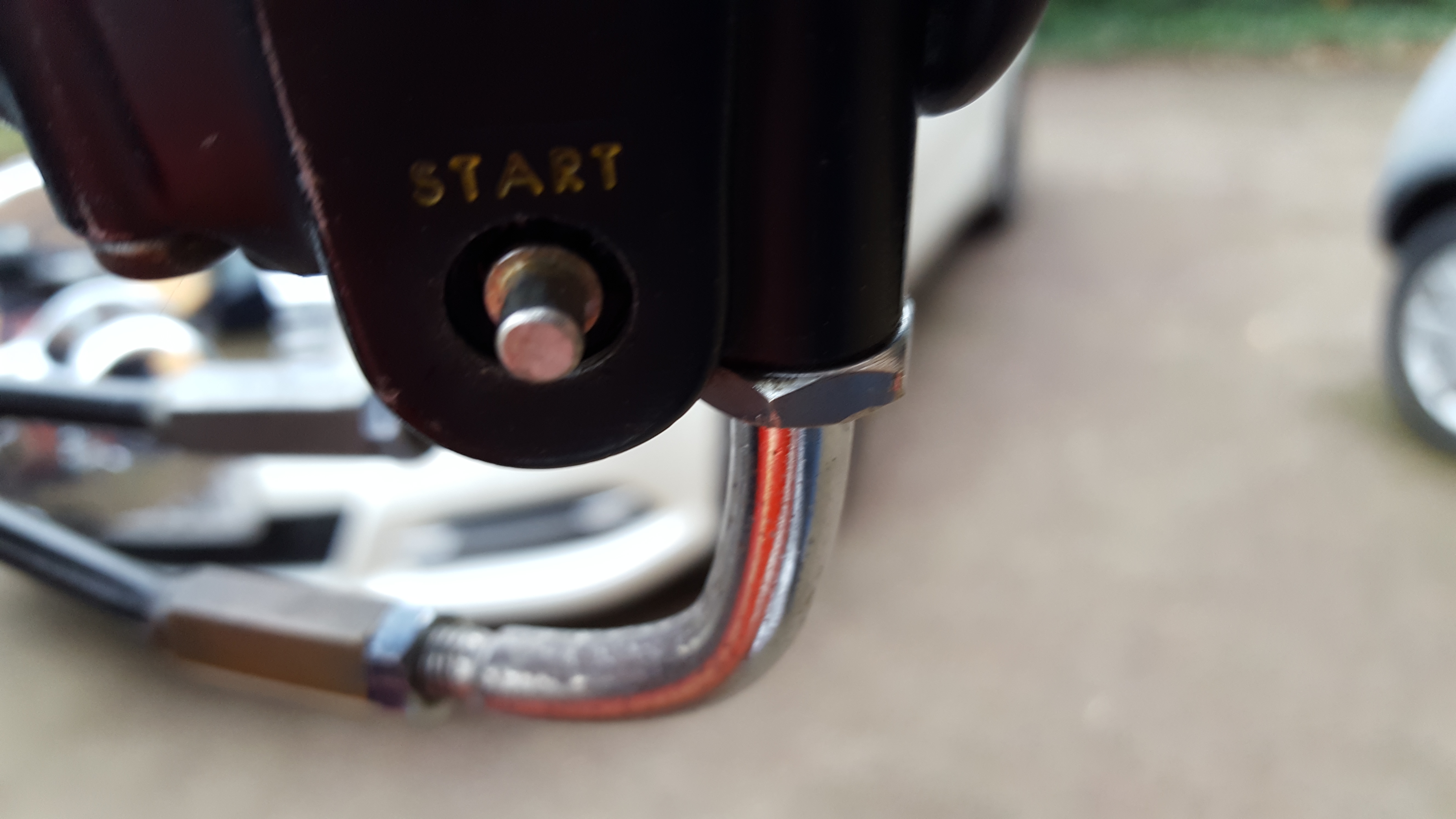

The start button on my z1000 has broken and fallen off - ordered a replacement from ZP and see it has a lip so assume you need to access from inside - How easy is it to access to replace ? Cheers all.

easy Disconnect cables from carbs remove whole assembly and undo a couple of screws slide out, slide new one in, takes longer to do all the other stuff than it does to replace the button.

keep a wee 6/7"mm screwdriver handy to compress the buttons' spring n wiggle the new button in, release the spring.. done. I :lol:
