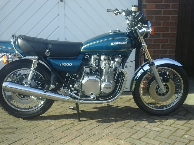

#7 PostAuthor: warren3200gt » Sat Feb 24, 2018 5:22 pm
Snap.

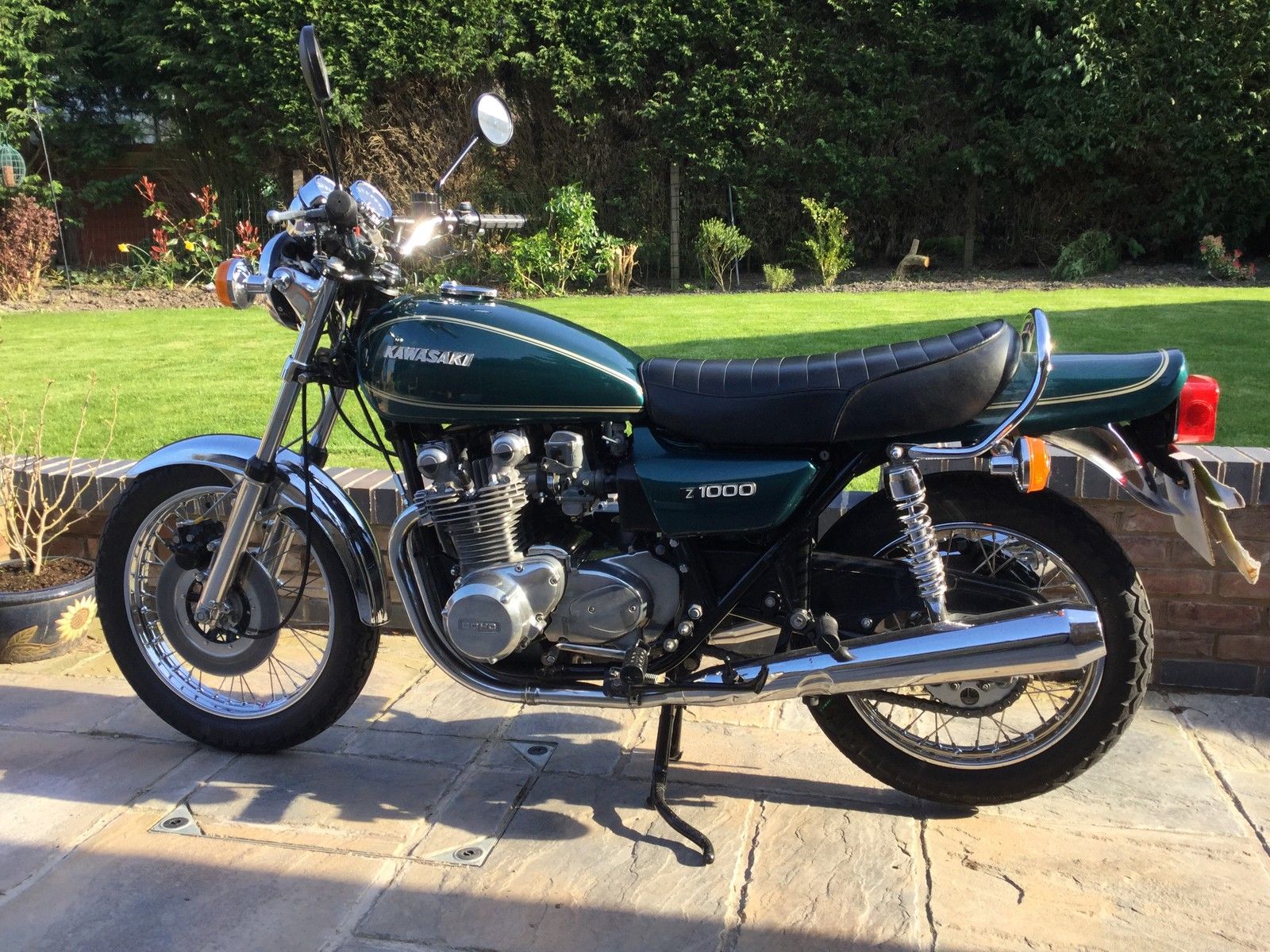

#8 PostAuthor: DavidZ1R » Sat Feb 24, 2018 5:31 pm
Very nice too Warren, proper colour too, mine is a different blue, super candy, on
instructions from she who must be obeyed , bet your pipes where a bit more local.lol

#9 PostAuthor: warren3200gt » Sat Feb 24, 2018 5:38 pm
Still on it when I got it. One of the main reasons I went for that one. Swopped the seat cover, need to add a strap and 2nd front disc then I'll be happy.
