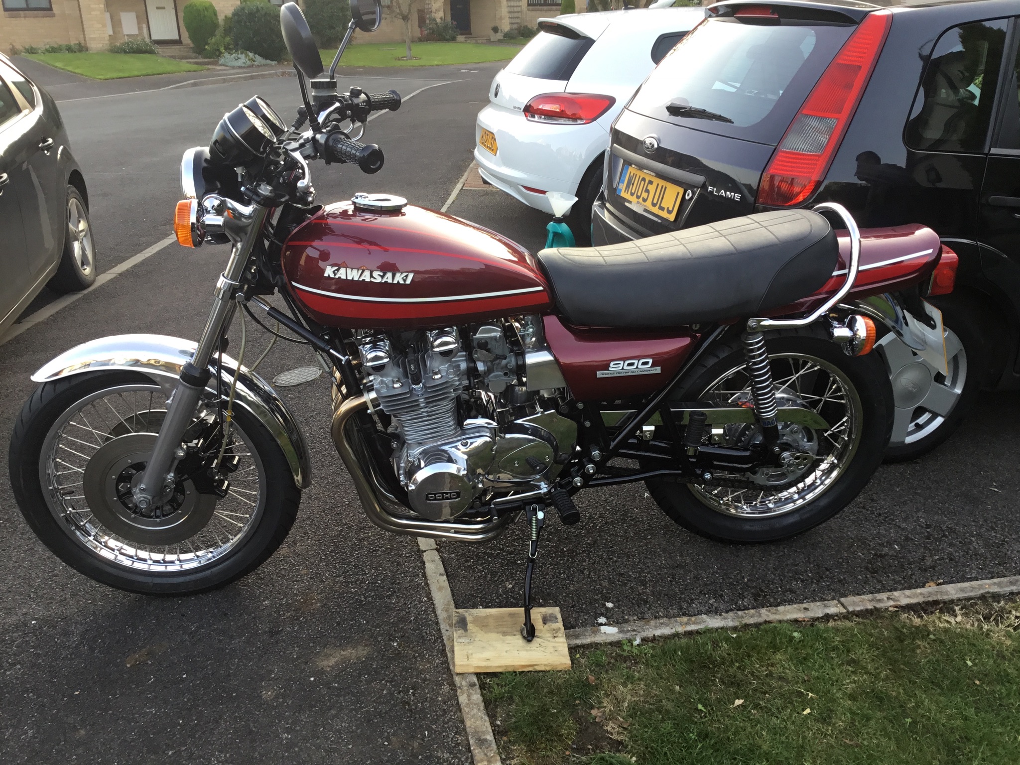

Re: Best chrome 4:1 Exh for a Z1?
#9 PostAuthor: 1975-S1C » Mon Apr 23, 2018 7:58 pm
I have the Delkevic stainless on my bike. I like the look of it from the side the pipe comes out, less so from the other side ! It was good value for money at 280 squids though. Pretty well made too. It sounds awesome without the baffles, but too loud for the neighbourhood :D
