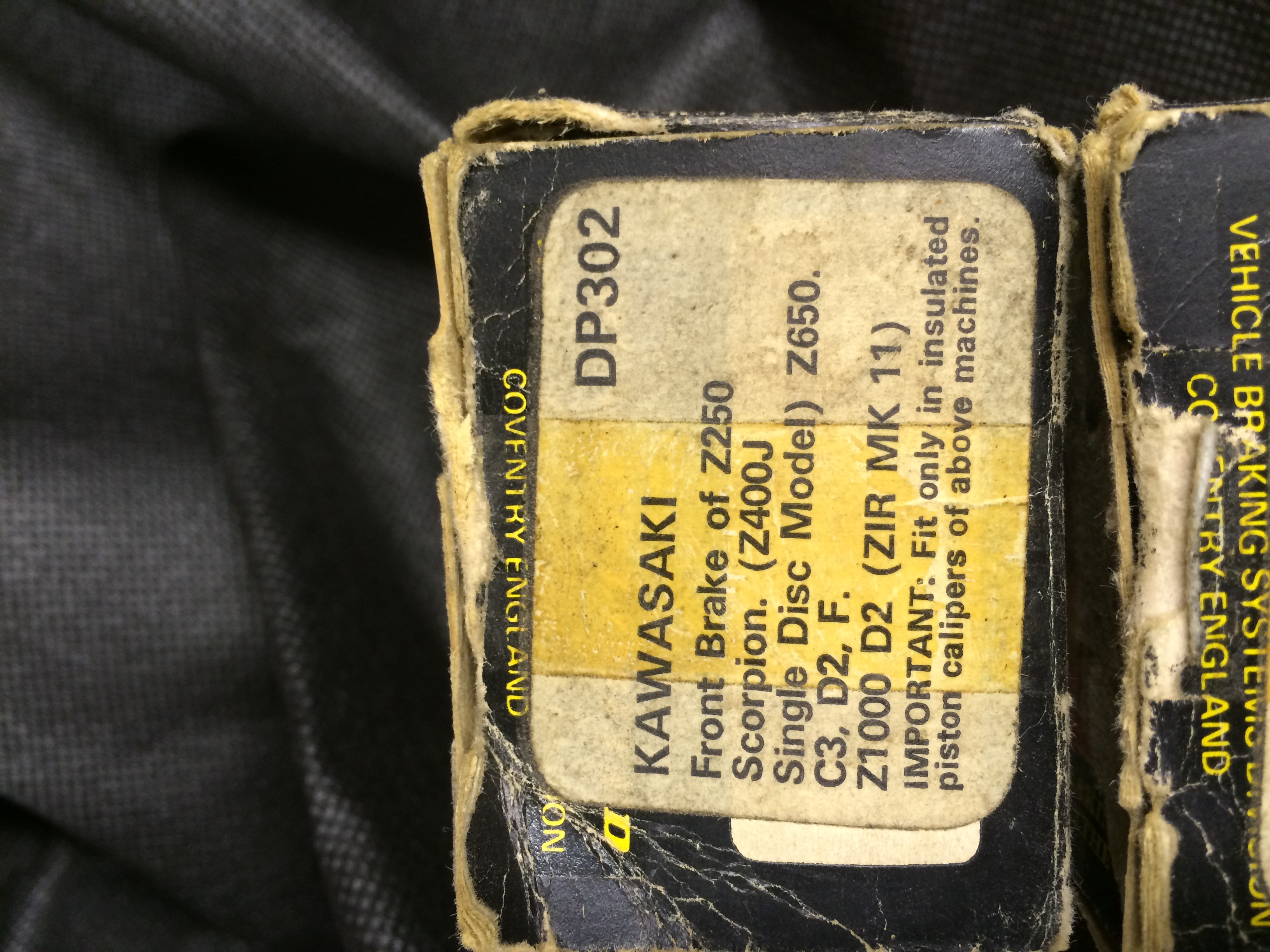

Excellent information, thanks. The first 550 had the same front end as the 400j but only for 1 year (the A1). The Z-Power listing looks like this:-
http://www.z-power.co.uk/z400500550/front-disc-pads-fa33
It shows the 550 in this list as well as Z650, Z1000A etc. This listing mentions the thickness and suggests either 73 or 33 'for a thicker pad':-
https://www.z1enterprises.com/brake-pads-ebc-fa73-kz900-1000-kz650-750-front.html
I wouldn't care about the thickness but the size of the surface area is different on my old pads. Here's a full cross reference listing both EBC 73 and 33 and all the bikes they supposedly fit:
http://www.rawpowermotorcycles.co.uk/armstrong-gg-performance-brake-pads-fa033-fa073-c2x14538522
I've now found a further set with chamfered edges that look the same as the ones in the factory manual. That's 3 sets for 1 caliper!

Re: Brake Pad Thickness
Depends on disc thickness. Twin discs tend to be around 4.5mm thick. Single disc 6.5mm thick.
