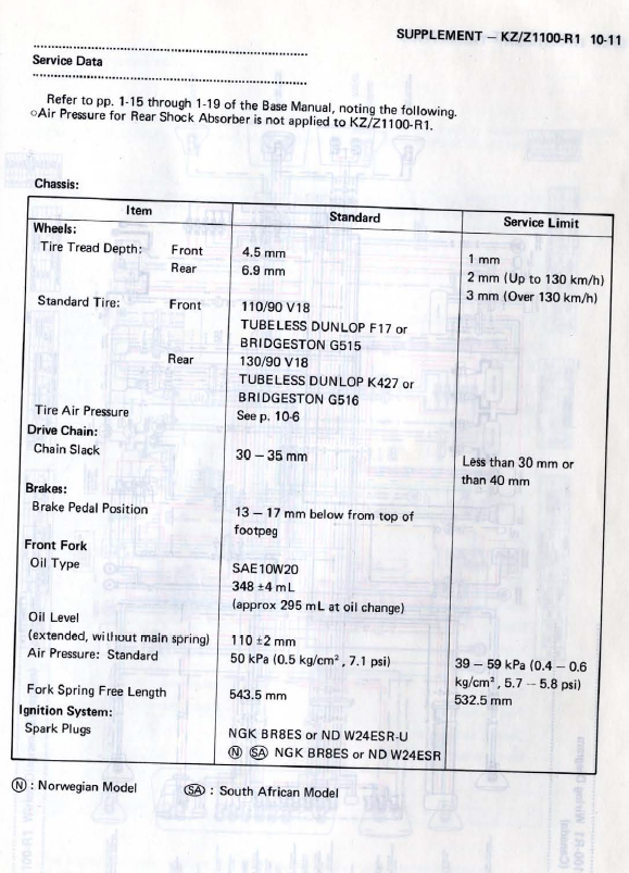

Gents,
I have been trying to find out how much fork oil my 1100 takes or the measurement from top to oil level, I cant seem to find the details anywhere ?
Can anyone advise ?

The service manual is on this page from the old Z1000R forum. Which is no longer running.
http://www.kz1000r.com/downloads/

Detail from the supplement manual.
1100R Forks.png (665.52 KiB) Viewed 2071 times

#4 PostAuthor: z1000puddin » Thu May 10, 2018 9:30 pm
Thanks guys
