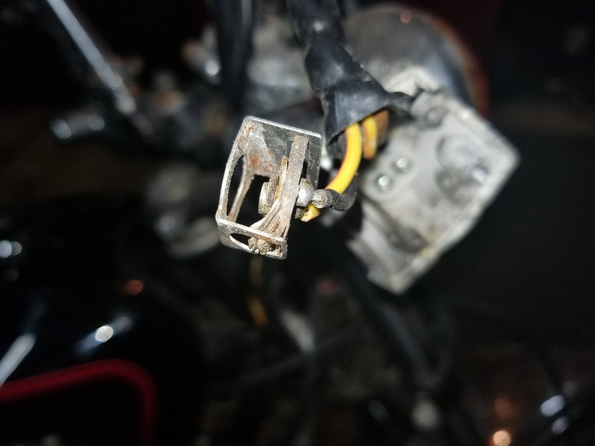

#10 PostAuthor: z1bman » Fri May 25, 2018 5:03 pm
here's a photo of the starter switch. with the ignition on & the kill switch in the run position the yellow / red wire should be live 12v+ the black wire which is the power supply to the solenoid should read 0 volts & 12v+ only when the starter button is pressed
