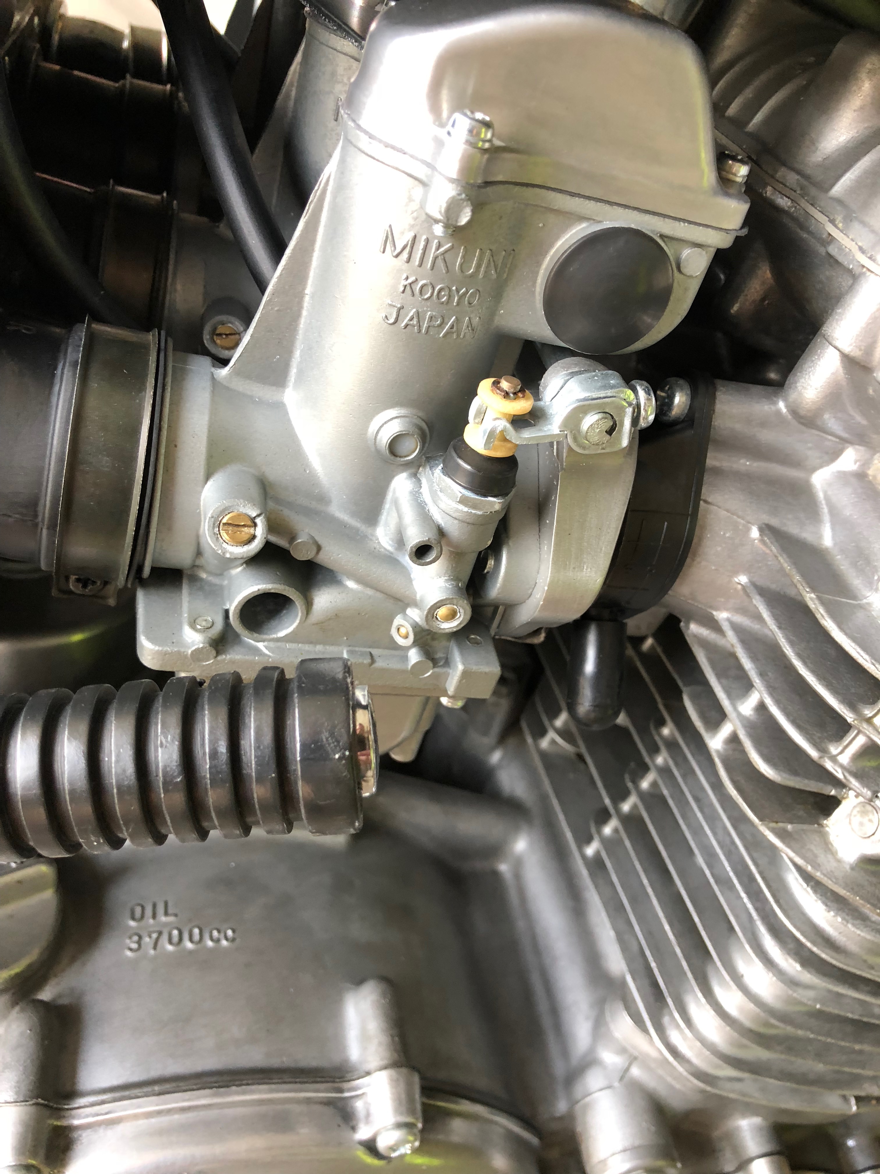

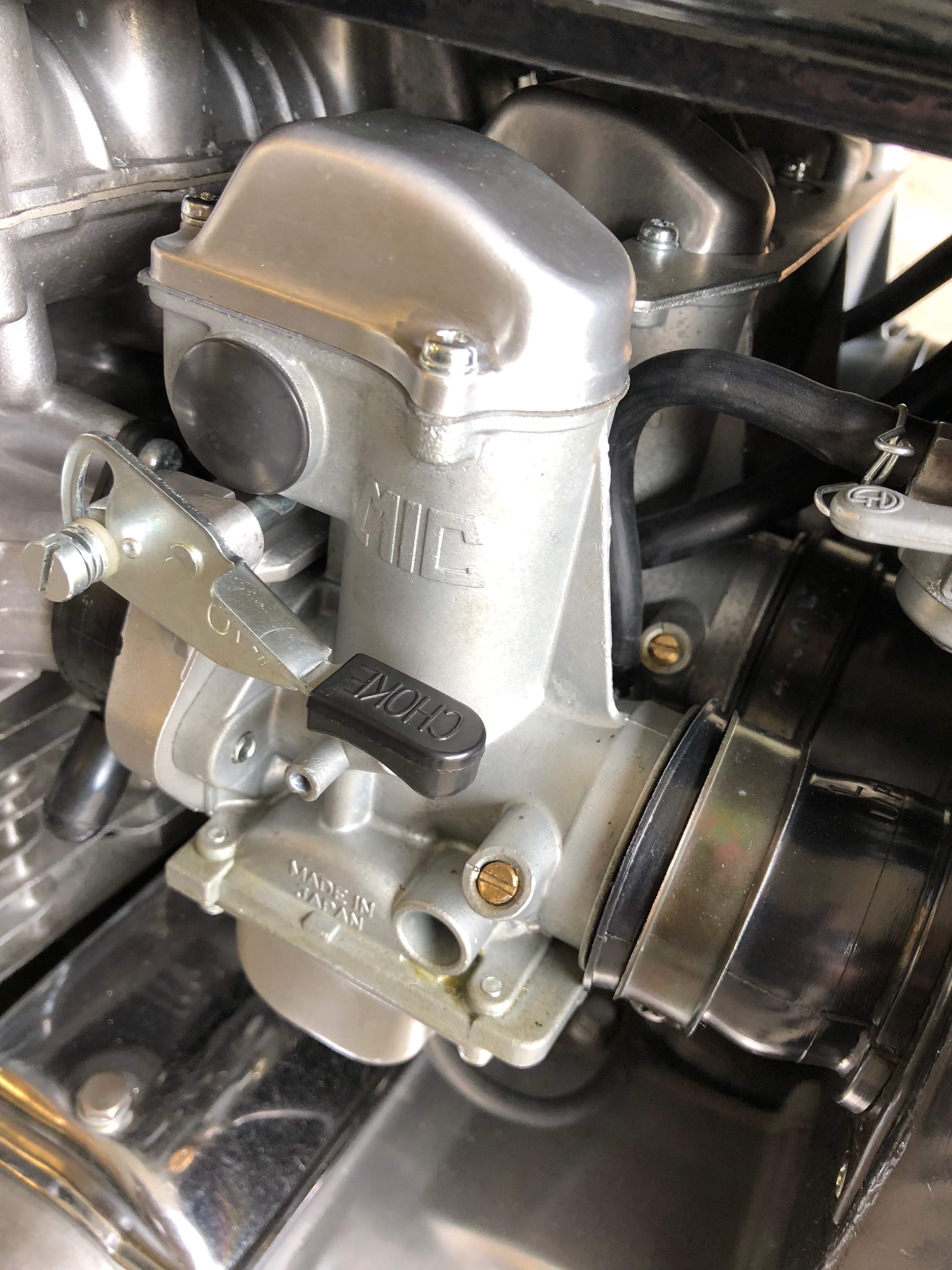

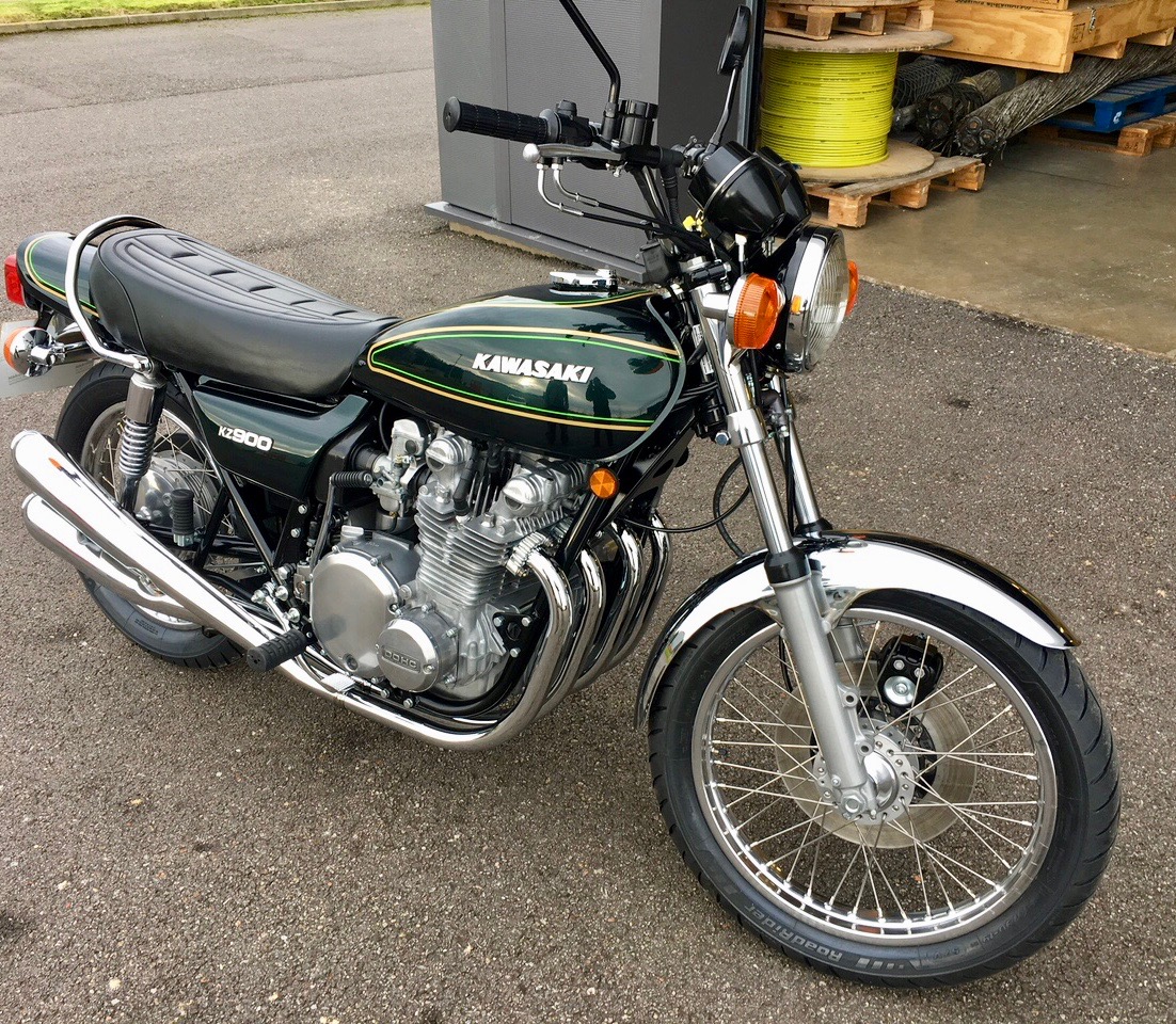

A 'newby' here - so kindly be gentle! I always wanted a Z900 from when I was a nipper and, finally, I bought one a couple of months ago at the tender age of 54. It's a lovely looking bike - a 1976 KZ900-A4 that has been nicely restored. The only minor (perhaps major!) issue is the carbs. I won't bore you all with the issues (bit tricky to start; cuts out on the overrun; sooty etc) other than to ask this: Does anybody have a fairly definitive guide to setting up the carbs they could send me, please?

Welcome to the fold. Is the bike standard with 4 into 4 exhaust and stock airbox? Do you know which carbs you have? Are they just airscrew, just fuel screw, or both? Assume they are Mikuni vm 26? Close up pics of the carbs and details of exhaust and air filter type will help us give you the correct info.

Hi there. Thanks for getting back to me. As far as I'm aware she's pretty bog standard. It's a 4:4 exhaust, stock airbox and (I think) standard 26mm Mikuni carbs. The thing that is most obvious with the issue is that if I gently open the throttle she almost cuts out. Give it a big handful is no problem but that's not great on, say, a roundabout.
