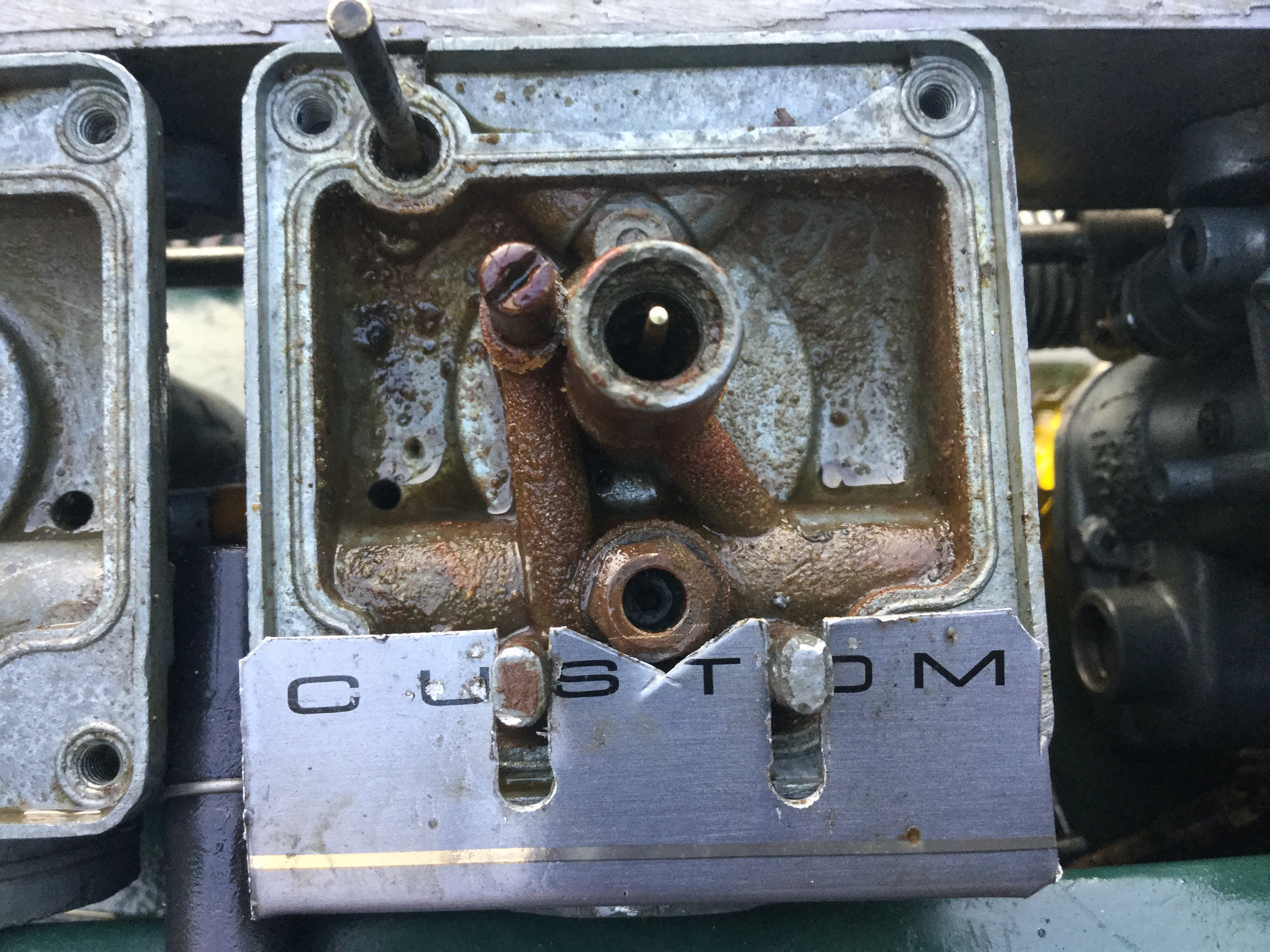

Here is the brace I made out of an old Harley air filter cover, it worked a treat

Cleverest thing ive seen for a long time. Always a butt clenching moment taking those darned pins out, well done. Off to the shed to make one tomorrow.

Zedorset wrote:Here is the brace I made out of an old Harley air filter cover, it worked a treat
Best use of a Harley part ever :D
