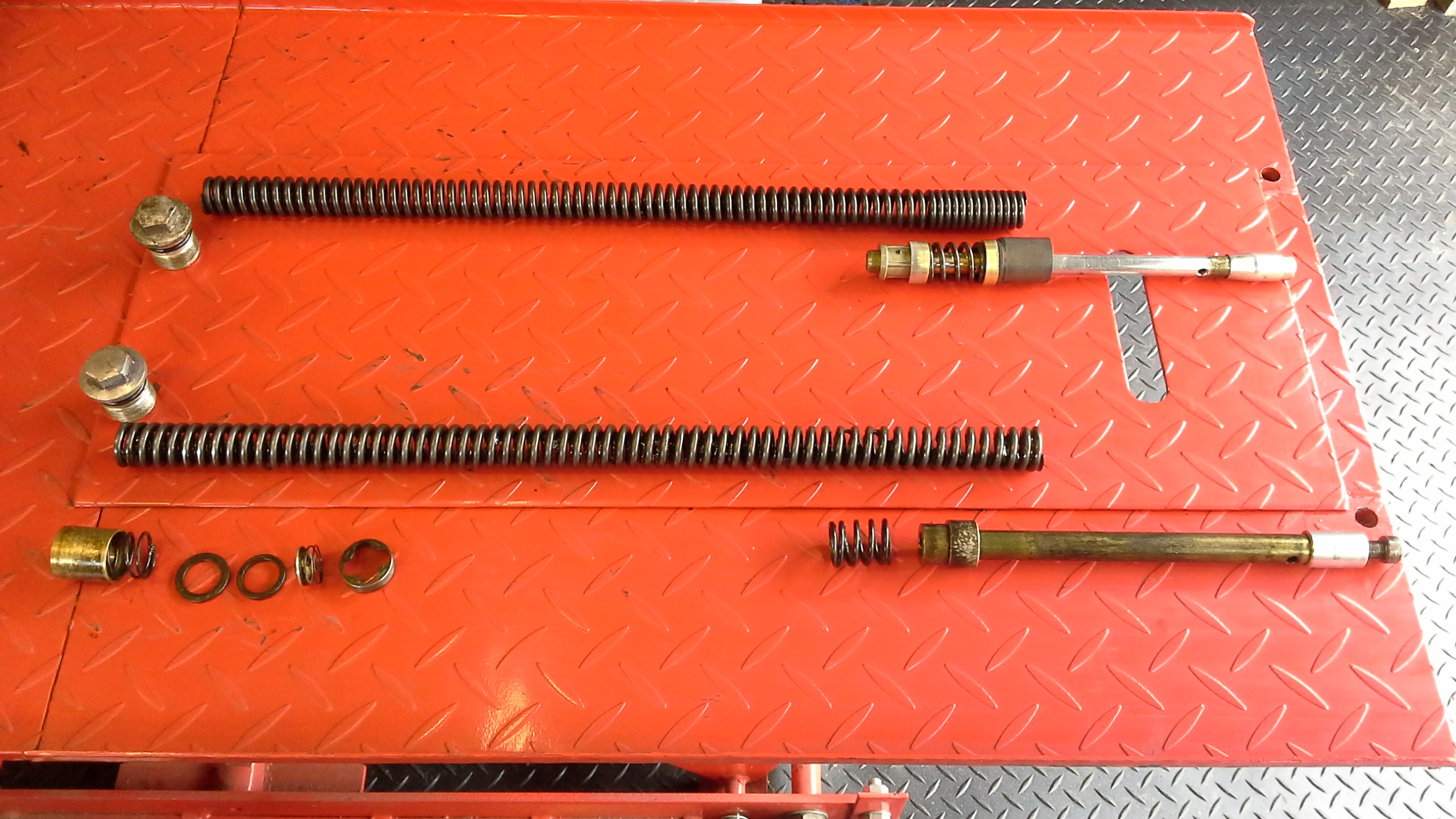

Bit of a strange one here chaps,,
Took the Z1b forks apart the other day and the two inards are different. The top one is correct i think, top tube bolt, spring and then the piston.
The bottom one i haven't a clue its totally different with a spacer and spring at the top, main spring, and then another spacer at the bottom, and the piston is different. Also the springs are different, same length but one has a tighter coil at the bottom.
Any ideas????.

Bottom one with the release valve looks correct. Cant help with the top one

top one is correct for z1b the bottom one is an after market replacement valve kit but its assembled wrong in the photo

Thanks for that, i kid you not but thats the order it came out.
