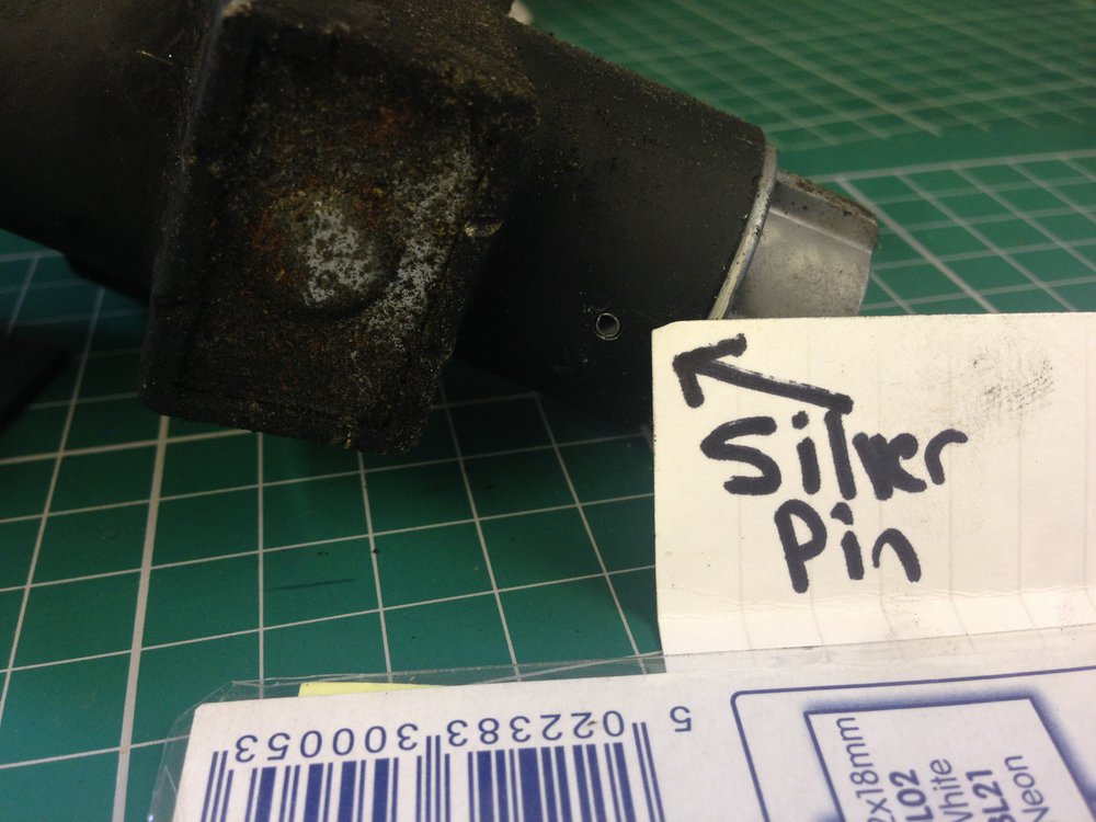

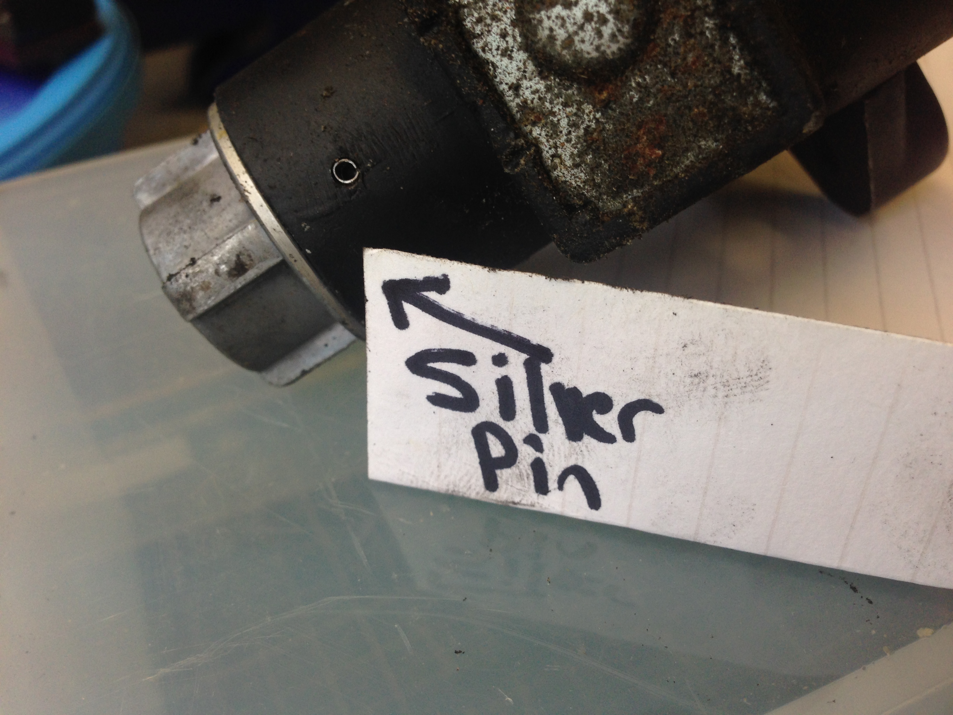

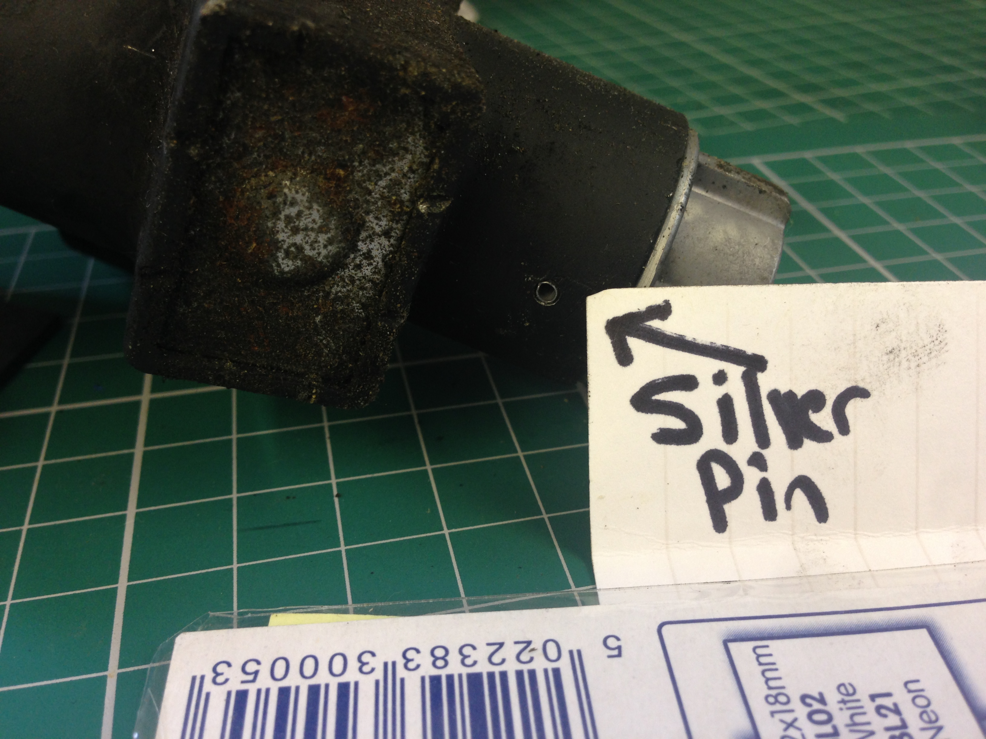

Hi,
Trying to get into an ignition barrel, but these little pins are causing me trouble.
I've tried drilling them out, that failed!
So, before destroying another barrel, can anyone give me pointers on how to deal with these wee pins?
These switches are from an 81 Z400.
Cheers,
Davy

That appears to be a roll pin and they usually are just driven in or out with a punch.

#3 PostAuthor: z1bman » Mon Aug 13, 2018 6:29 pm
use a self tapping screw & pull it out holding the screw in a vice

#4 PostAuthor: MikeP » Mon Aug 13, 2018 6:31 pm
I agree with z1bman using a hardened self tapping screw or a small threading tap - although the latter is difficult to grasp to extract.

#5 PostAuthor: Kwackman » Mon Aug 13, 2018 8:58 pm
BykerBoy wrote:Why do you need it open?
The original switch is jammed (key won't turn & steering lock is locked on), but anyway, there was a different key for the petrol cap etc. But my drilling skills etc today have knackered it beyond use anyway.
I bought a used key lock set (Ignition switch, petrol cap and helmet lock I think) of a ER500 which looked the same, all using the one key.
But the ER ignition barrel is actually about 10mm longer, and fouls the headlamp shell.
I was hoping to try swapping the actual barrel with the spring loaded levers across.
Over the last year I've gathered 2 other correct ignition switches, one with no key, one with a key but is a bit sticky! I'm still hoping to amend one of these with the ER500 innards...
What could possibly go wrong!
z1bman wrote:use a self tapping screw & pull it out holding the screw in a vice
That seems so obvious but it never crossed my mind! Thanks, I'll give that a go.
Thanks to MikeP too.

#6 PostAuthor: pertonpc » Mon Aug 13, 2018 9:28 pm
There are similar roll pins to hold Z1 fuel cap in place.
Soak with penetrating oil and then I selected a suitable diameter drill bit and tapped it out with that as a drift.
Obviously a vice or similar to hold it good and steady helps.

#8 PostAuthor: Kwackman » Wed Aug 15, 2018 7:12 pm
Didn't have much joy using self tappers- I'll need to get smaller screws.
But, I think I got lucky.
Both barrels have a plastic cap at the bottom, the 400J is slimmer than the ER500 one, but they are interchangeable. This takes care of most of the height difference.
I'll go down this route as it's the easiest, and hope it fits OK.
