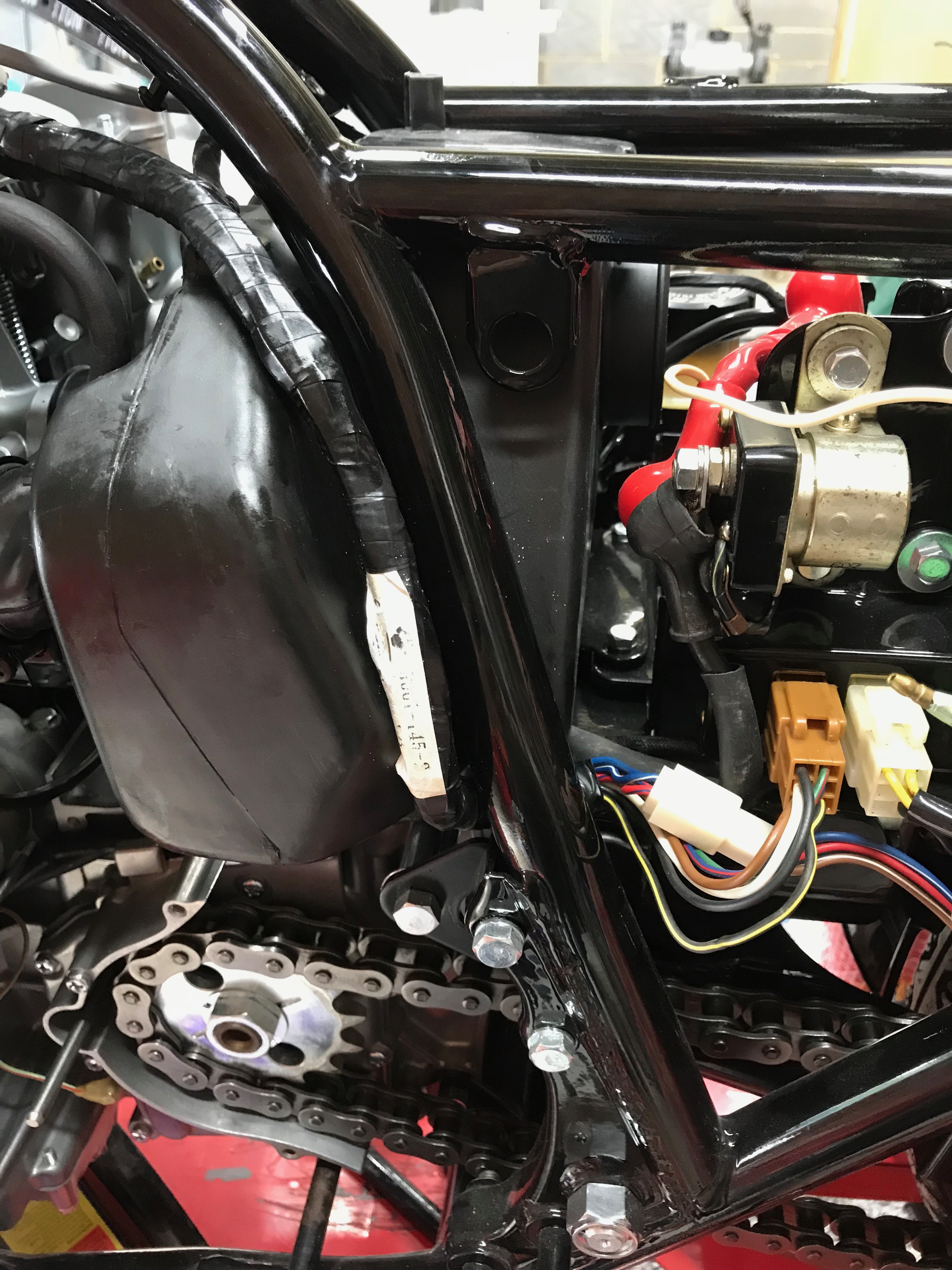

Would someone mind taking an image and show me how the main wiring loom routes from the Brown plug up behind the battery box. I've done what I think should be correct but seems a tad tight.

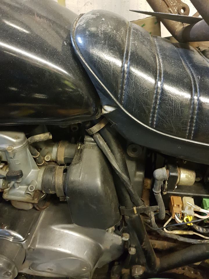

Funnily enough, although you'd think it went behind the frame, it doesn't.
This is a pic of an unrestored 900A4, but Z1000A1 and A2s are the same - the side panel hides it.
