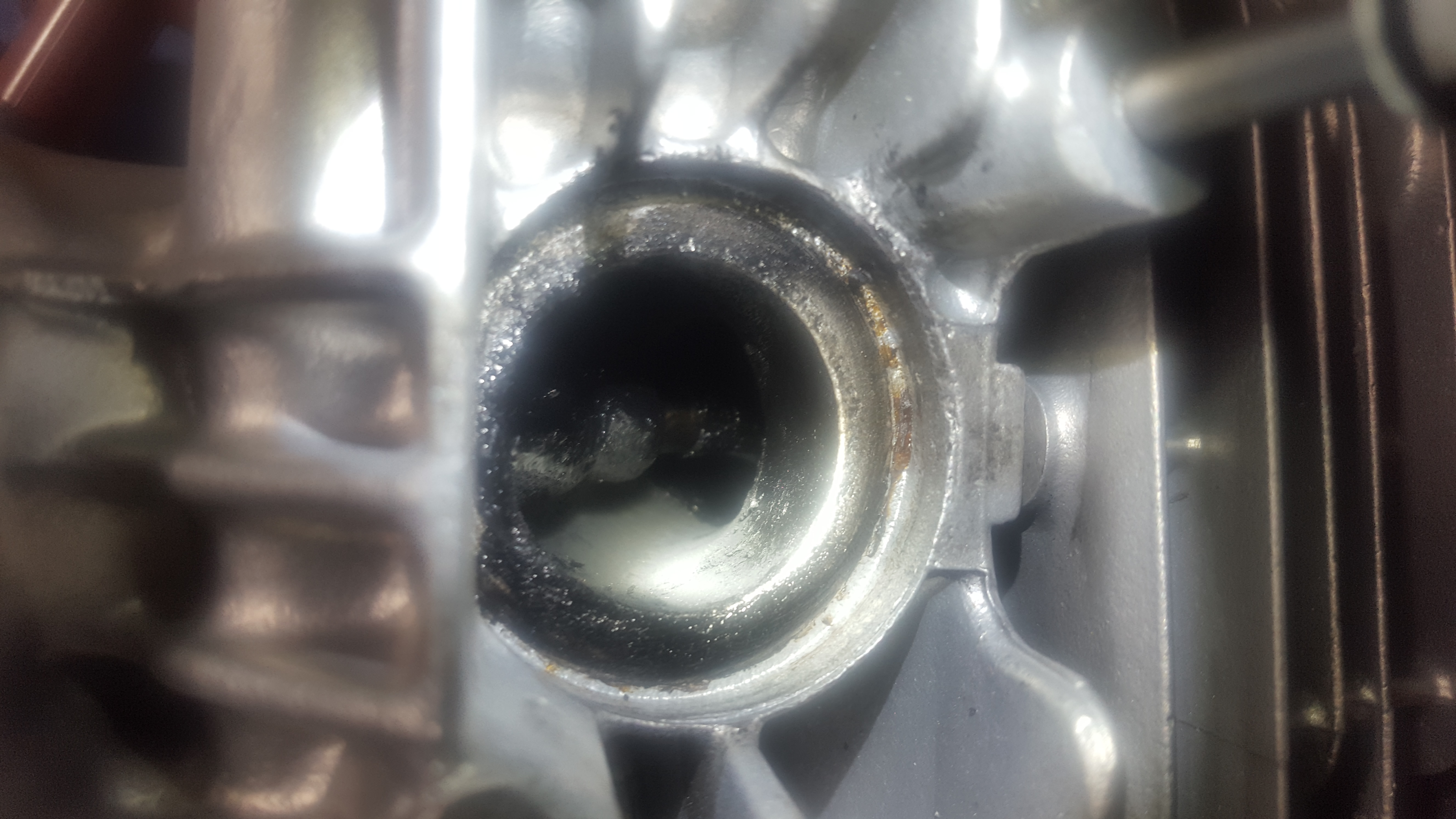

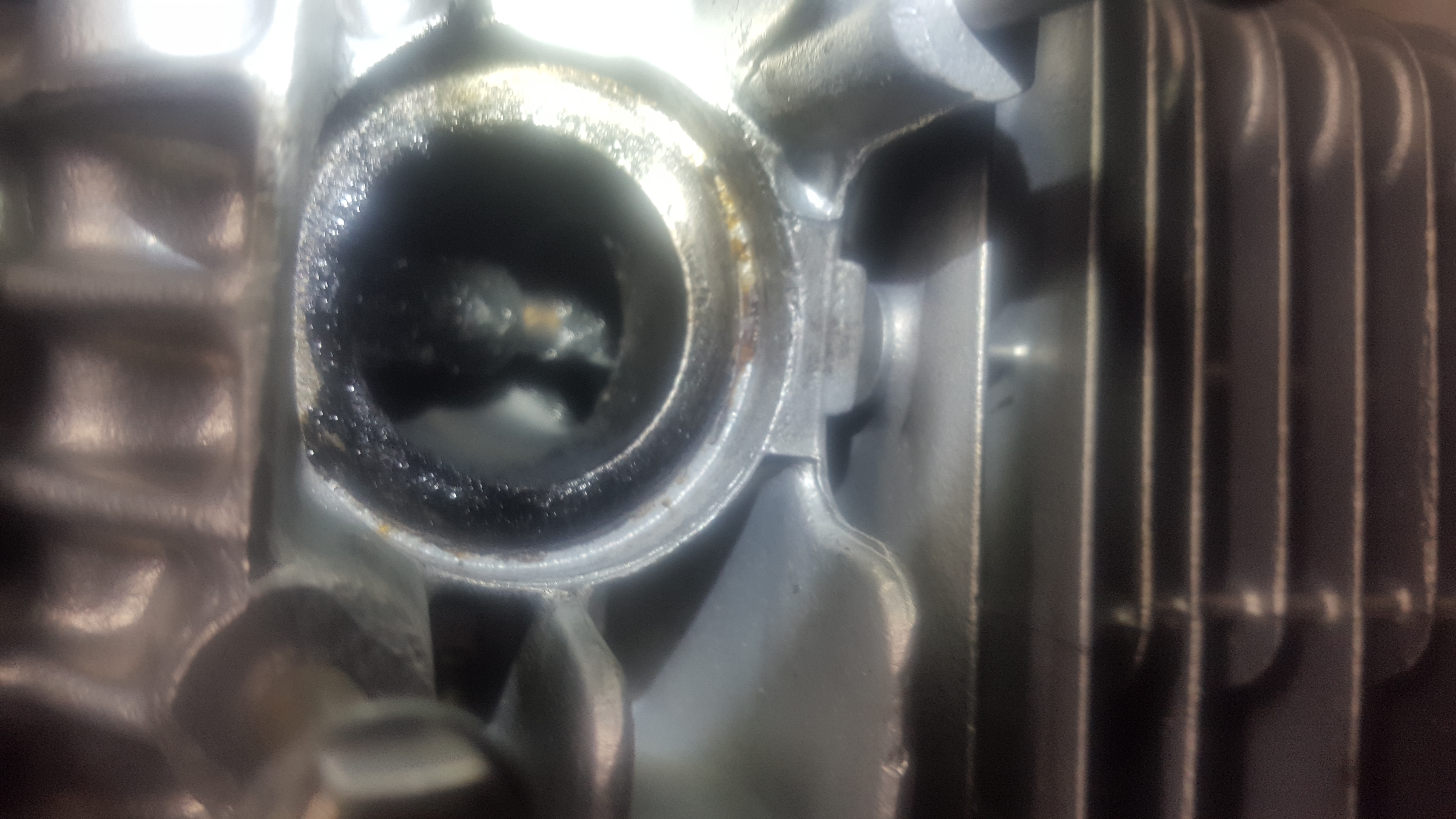

Just taken the exhaust off n01 and the top of the valve looks very oily, picture not the best nut it gives some idea of what's happening.
Re: Valve seal
Hi Wrigers
if an oil seal has given up after 300 miles I would contact the man who did the engine overhaul.
Or it was a bad quality oil seal or it was placed wrong. SH*T happens, sadly enough.
If you remove the head to replace the oil seal I would suggest you replace all of them, don't take any risk, use genuine Kawasaki oil seals or good quality Viton oil seals and make sure they're placed correctly.
Good luck anyway!
Good luck anyway!

Re: Valve seal
Exactly how much smoke??
If its got an oily plug it would have to be the inlet valve seal on #1
If its a moderate amount of smoke i'd say valve stem seals but if its copious amounts more likely broken ring, score in bore, oil control assembly incorrectly set or as seems to be the case most often a ring up-side-down. Bleeding head gasket!
I ask about smoke because it will smoke way more with some ring / bore issues than if it had no valve stem seals at all.
Missing (or terminally damaged) valve stem seals will allow some oil through but damaged bore or up-side-down ring will pump it out.
Seen a great deal of both recently.
