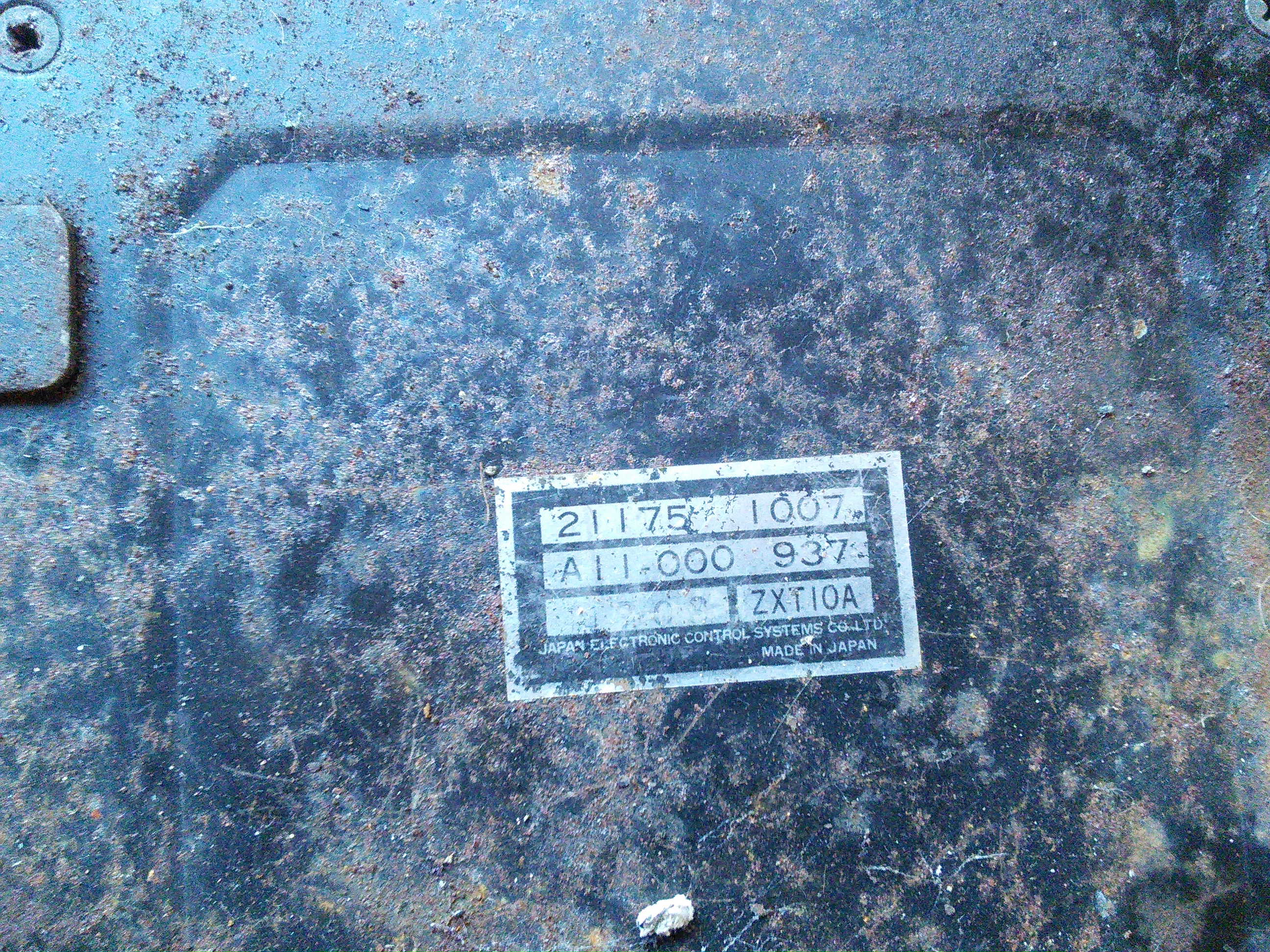

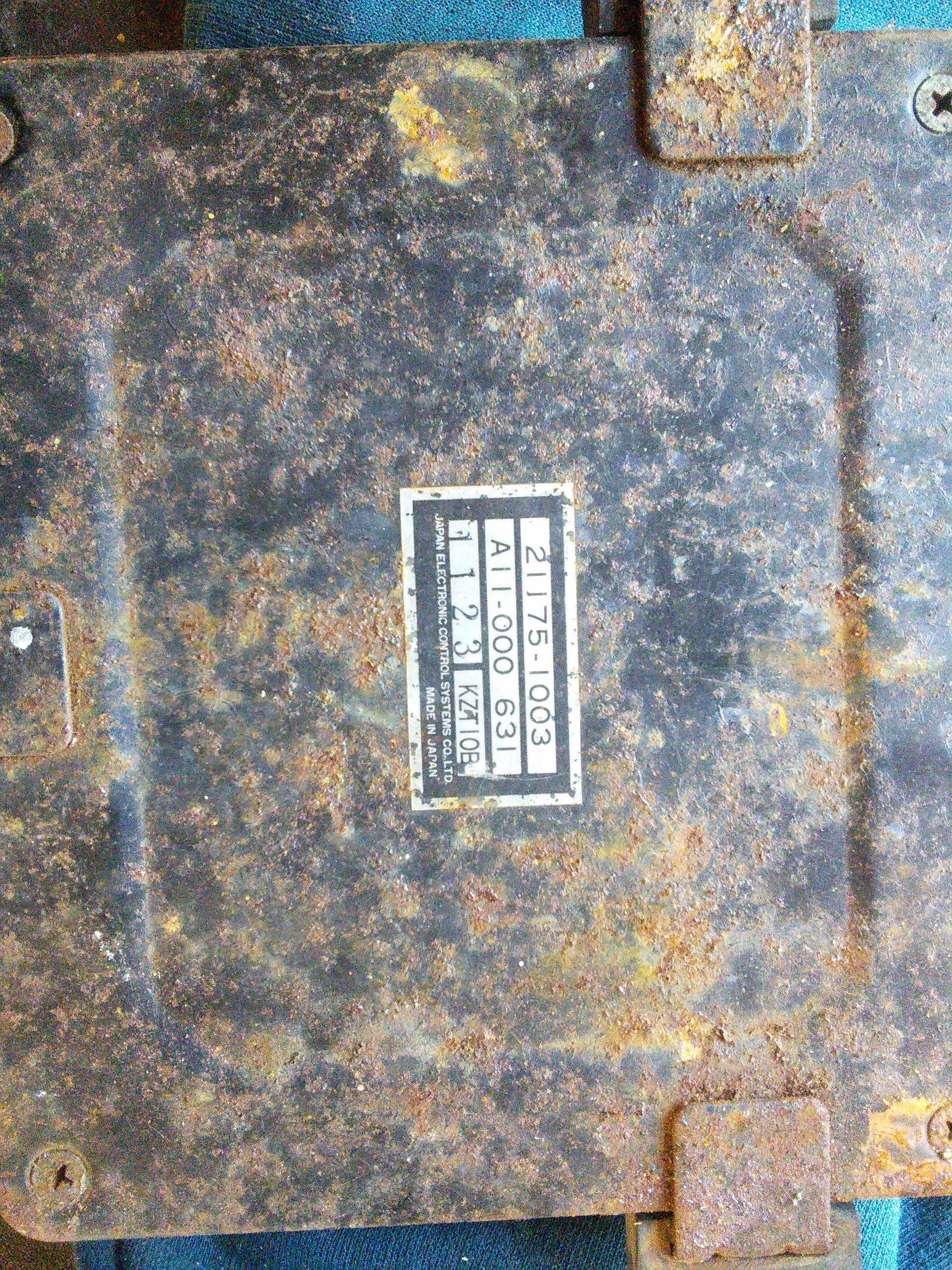

Got these a while ago in a box of bits, not sure what bike they're off, there's 3 the same. Don't know if they work or not, anyway of checking apart from fitting to a running bike.
Having a clear out so will be for sale when I know what they're off.
FOR SOME REASON ITS POSTED 2 PHOTOS (937) OF THE SAME ONE.
THE BOTTOM PICTURE (631) IVE ONLY GOT THE 1
3 off these
1 of this

#2 PostAuthor: Philippe » Fri Oct 26, 2018 3:44 pm
Hi Floyd
according to the part numbers on the parts the 21175-1007 belongs to a GPZ1100 from 1983-1984 , the 21175-1003 belongs to a GPZ1100 from 1981.
I looked those numbers up on the internet. I'm not sure if the information I found there is correct. Anyway you have a clue.
ZXT10A seems to be the factory code for a GPZ1100 Uni-Track
KZT10B seems to be the factory code for a GPZ1100 B1 or B2

I could be wrong but wasn't the B1 analogue and the B2 Digital?

garyd wrote:I could be wrong but wasn't the B1 analogue and the B2 Digital?
Agree, I wouldn't think B1 and B2 could be the same. More likely that B2 and ZX1100 are the same.

This says I should be.....https://www.partzilla.com/product/kawasaki/21175-1003

CMSNL say the same, seems we are wrong Gary!

1003 is for gpz1100 b1 1004 is for gpz1100 b2 1007 is for zx1100 a1/a2

Thanks guys, the bike I bought was a b1 converted to carbs so the 1003 makes sense. The other 3 , I wonder where they came from and why.
