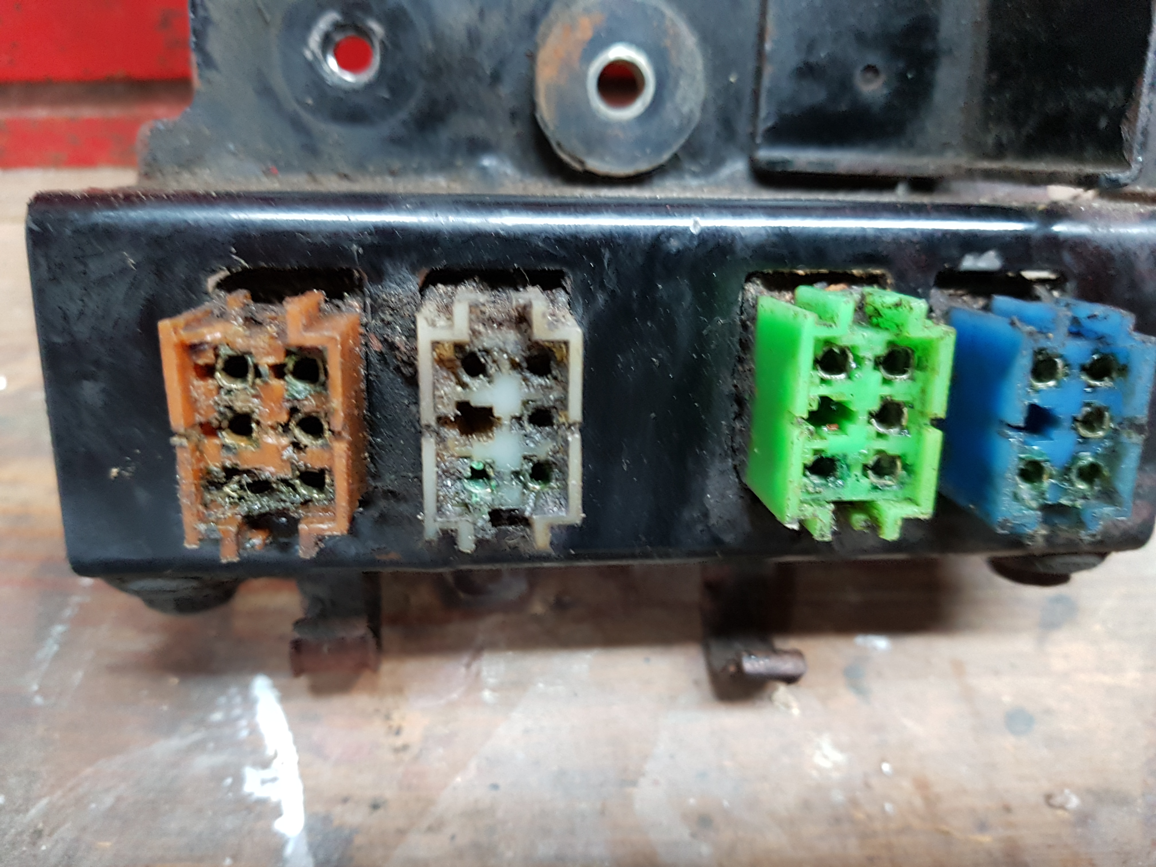

I've got a current drain when starting my Z1000, sluggish starter motor !
It looks like the 6 way multi connectors could be the problem, but I can't find equivalent replacements anywhere.
Has anyone converted this to a modern type connector that can be mounted like the standard ?
Stuart

I'm sure z power do replacements.

Z power do new ones but i've got some old one better than yours if you want stu.
and contact cleaner will help a lot

Yes I thought Zed power would have them, the guy that makes the replica looms bought the moulds and only sells the connectors with the complete loom.
