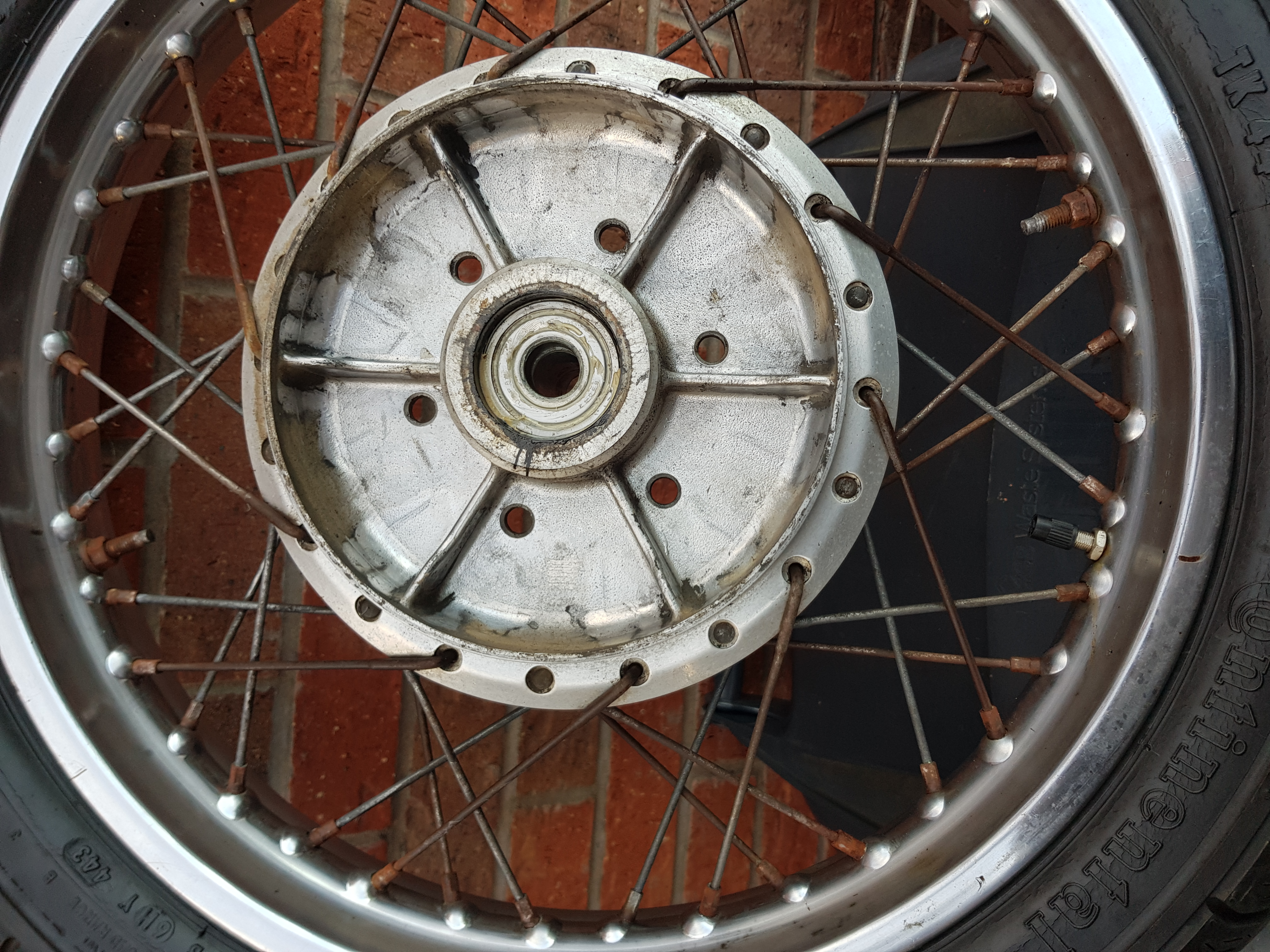

Rear wheel off and at once noticed 3 stalks on the rim, one being the tube inflator, what's the other 2?

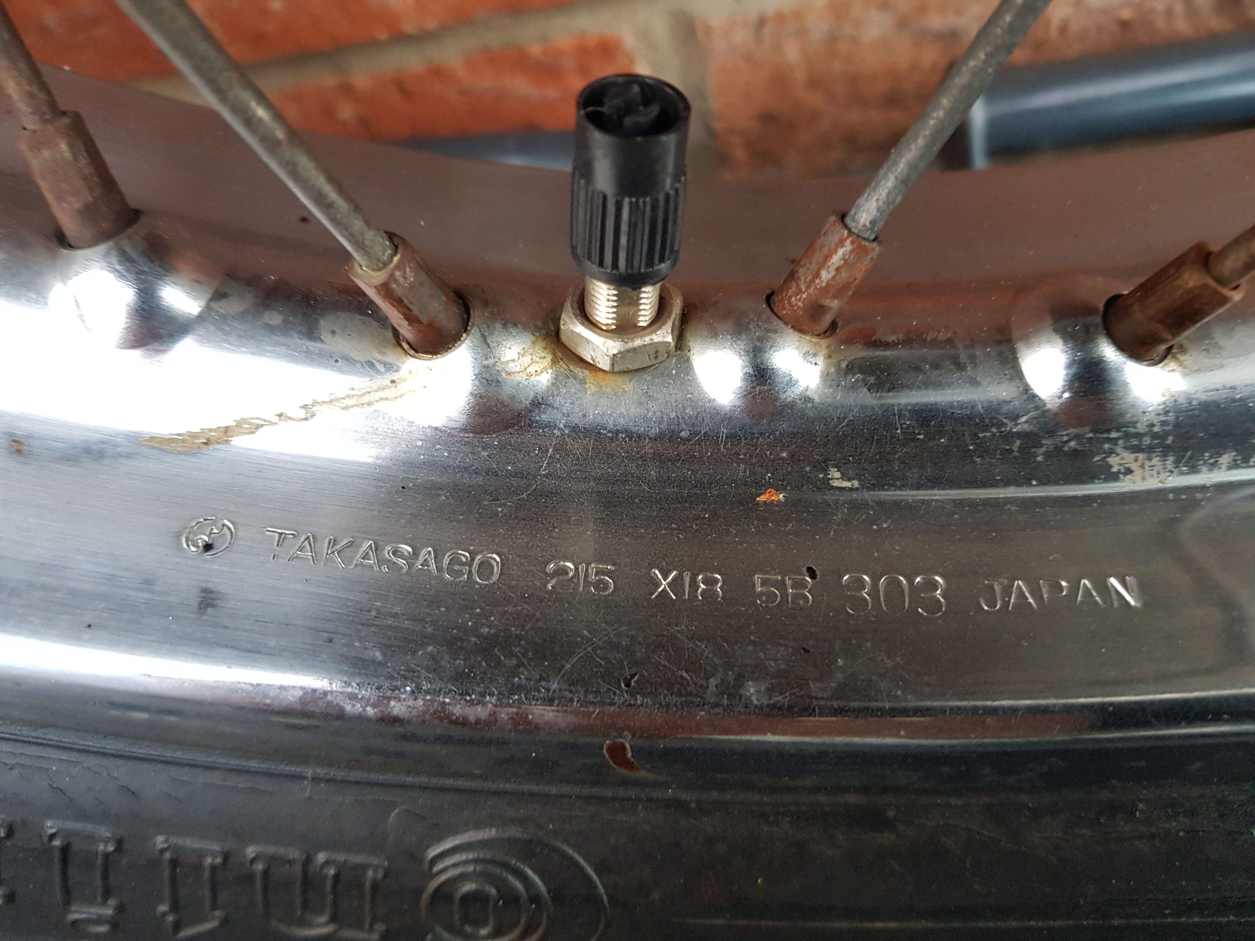

What date is the rim or is it now scrap with 3 holes in it?

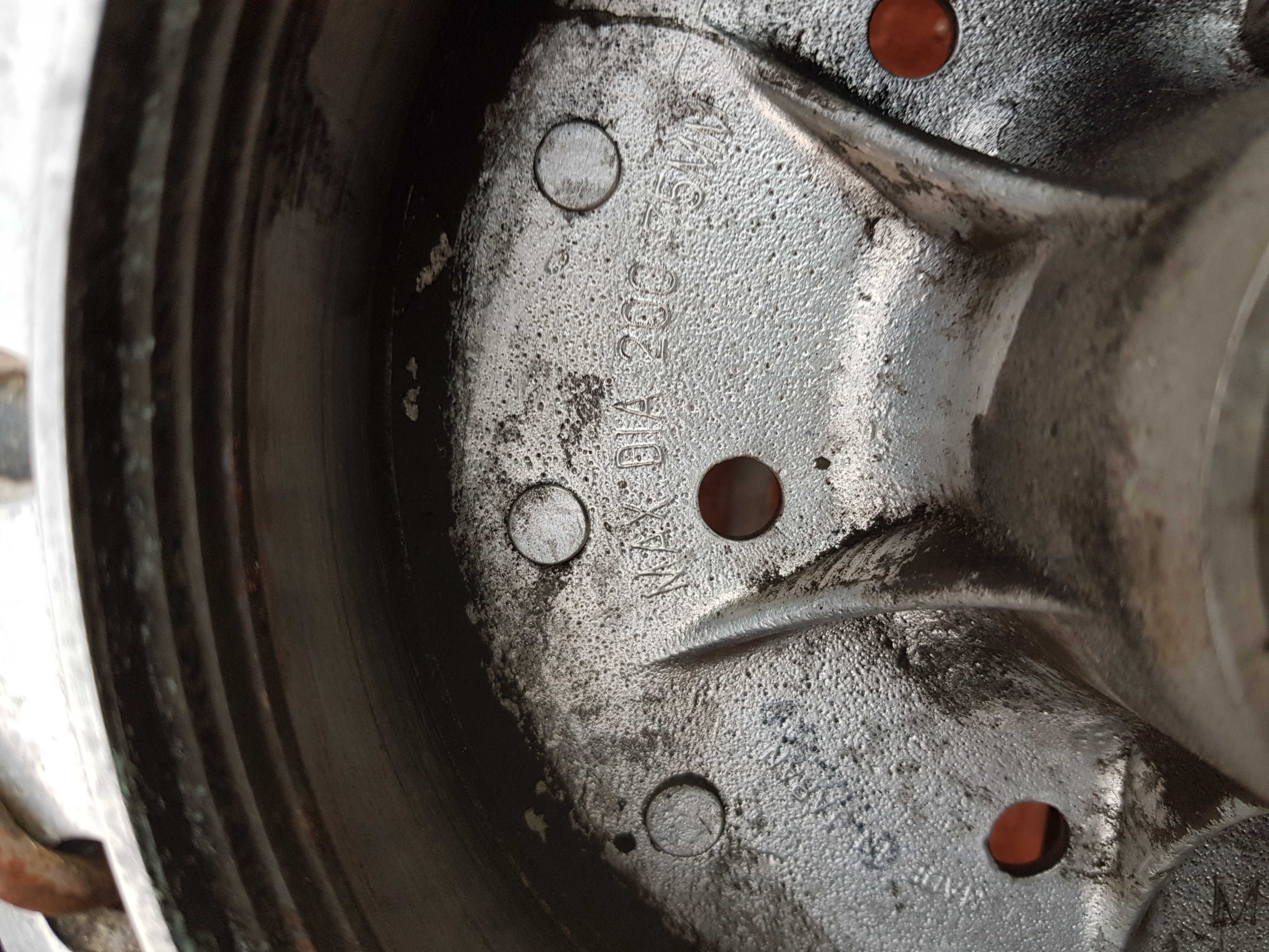

The hub lining has a max, once again scrap if exceeded?

Wrong side of wheel hub....

the other 2 stalks on rim are for wheel rim locks,

What's a rim lock? Is it a 1975 rim also?
Re: Z1a (August 73 build, USA)
#5 PostAuthor: Garry.L » Sat Dec 29, 2018 3:39 pm
Adrian90s wrote:What's a rim lock?
They're to stop the awesome power of the 903 motor from spinning the wheel rim inside the tyre...

Rim locks...what are they connected to inside the tyre?
8 Valve Mark
Posts: 968
Joined: 3rd Nov 2016
#7 PostAuthor: 8 Valve Mark » Sat Dec 29, 2018 4:02 pm
they're held in place by the pressure of the inner tube against them and the nuts you can see on the wheel rim . they're like this..

Thanks for that..is my rim original to the bike?

i think the code is a feb 75. someone will confirm or correct this......

Many thanks...no good for my 73 bike then. Anyone got a 3c-f to swop?
Or I can sell the rim, no rust on the rim...or the bike come to think.

all said above is correct to my best knowledge. The two extra holes in the rim are for the tire grippers, 5B is the date code: februari 1975.
Max 200 mm states the maximum diameter of the space for the rear brake . The interior of the hub has a steel lining. If this is worn out you can't use the hub in a safe way, it could crack when it's hot due to the friction of the brake shoes when applying the rear brake.
So don't worry, I never saw a worn lining on a rear brake. Remove the rust and use new brake shoes.
