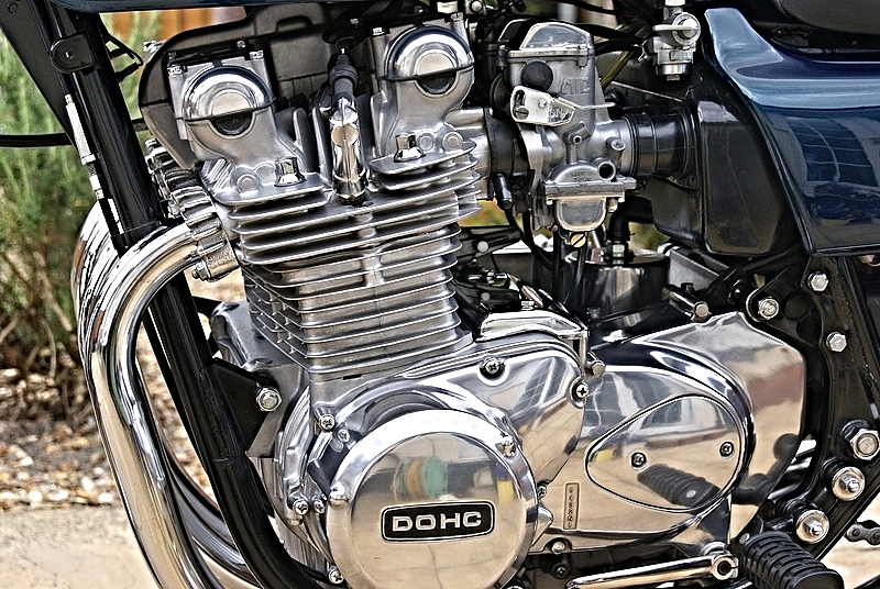

Putoline Chain & engine degreaser (expensive BUT it works) then a scotch pad, a tube of Autosol and a very large tub of elbow grease..... then get rubbing.
Wrap the pad around a flat blade screwdriver to get into the fins.
An old Z1B I used to own.
Before
After....
As said, it takes lots of time and effort. Also, having no life what-so-ever helps as well.

Re: Engine restoration
That's the second time in two days you've made me laugh Garry.L... and my 9 year old son loves your gif image. 'Look at that dad!'
More to the point, very impressive polishing. I'll try and get my KZ1000 engine to look somewhere near the same.

Excellent results Garry.
Point of note: Mothers is not just an abrasive paste (like Solvol) it's got some chemicals in it which help to eat away the grime. So you can get good results without having to resort to wire wool as well.

Thanks for the help boys. Are you telling me Gary those cases are not chromed ? Superb
By the way what paint do you use to paint in around the DOHC ? Cheers Mike
