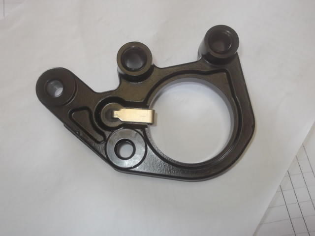

Bit of a puzzle here chaps.
Doing a double disc conversion on a Z1b.
Left side fine, original caliper and bracket new pads etc.
Right side, original caliper, pattern bracket, but when placed in position there is a significant GAP between the fork leg and the bracket, so much when tightening the caliper bolts it completely seizes the wheel due to the pressure òn the inside of the disc. Any ideas????. Paul

It's one of these

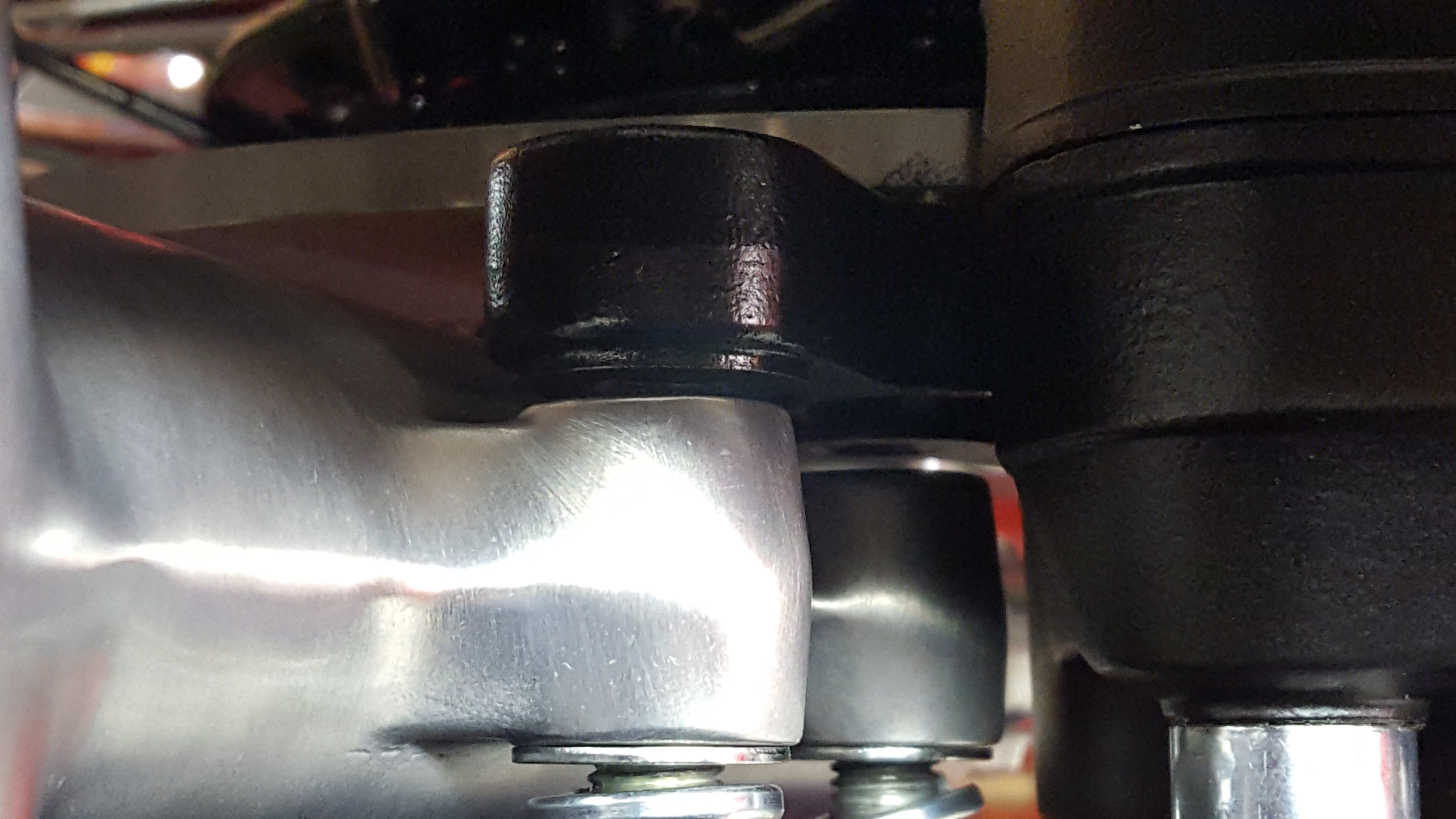

#11 PostAuthor: Wrigers » Sat Jan 19, 2019 4:23 pm
chrisw1 wrote:I had the same problem ...... loosened of the clamps on the bottom of the forks and gave it all a jiggle and it fell into place
Cheers Chris, problem solved.
Some head scratching and a senior moment, losened fork bottoms and they sprung inwards ever so slightly to fit flush with spindle ends.
