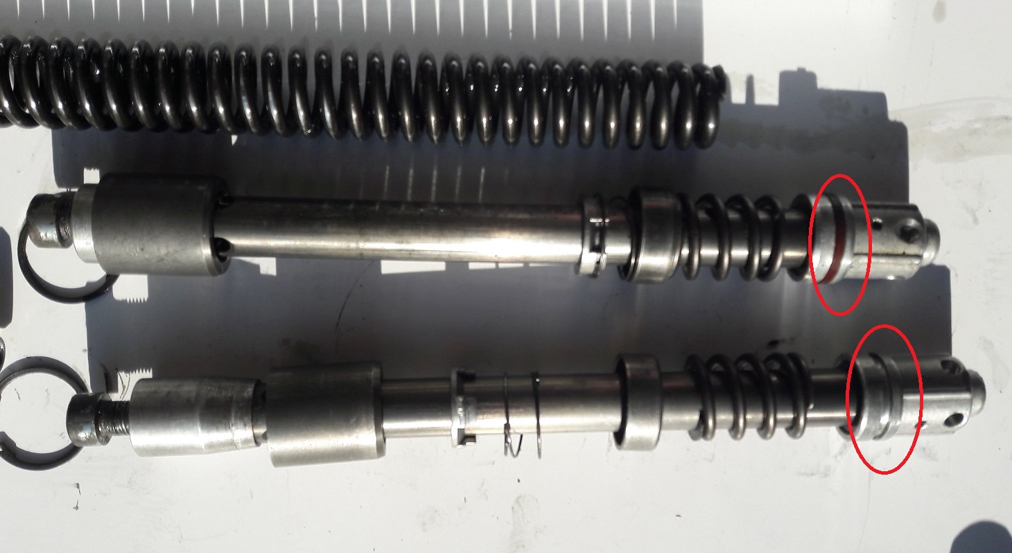

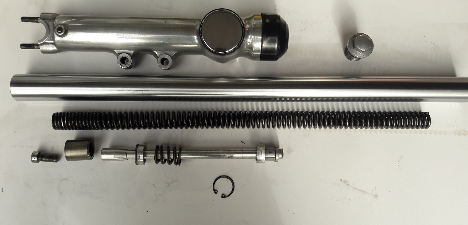

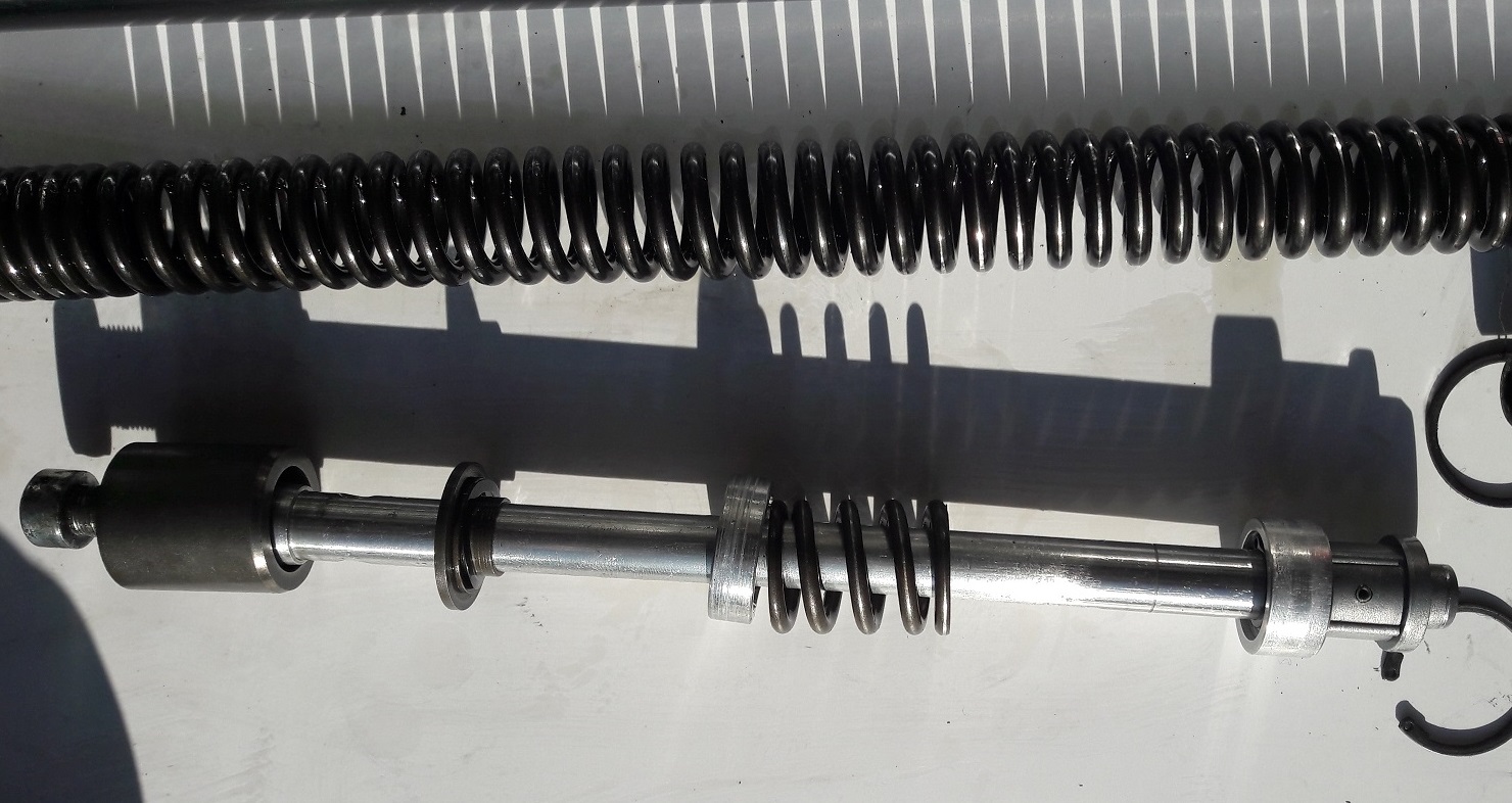

#12 PostAuthor: warren3200gt » Sun Feb 24, 2019 11:50 am
Got the forks disassembled and now a bit confused! The first pic is of complete fork parts. The second of the damper ass that was in them. They look very lightweight for a 900. So don't think they are the correct ones.
Had a route in the parts bin and came up with some that look much more like the correct bits, the third pic. Question is, are they? and there is a red collar missing from one of them. What is that supposed to do and is it necessary? I can guess the answer and where can I get one or would one turned from nylon suffice? Having had a close look at the pic on the same assembly there appears to be a seat washer missing for the little weak spring also.

#13 PostAuthor: warren3200gt » Sun Feb 24, 2019 4:42 pm
That seems to have sorted it. Made the missing bits and fitted the ones in pic three. Front end is a lot stiffer which I like and no knocks anymore. Happy days although begs the question what are the original one from?

#14 PostAuthor: Philippe » Sun Feb 24, 2019 5:20 pm
Hi Warren
if they're aluminium they could be from a Z1 front fork, if i'm correct those aluminium tubes were replaced with steel tubing from the Z1a onwards.
