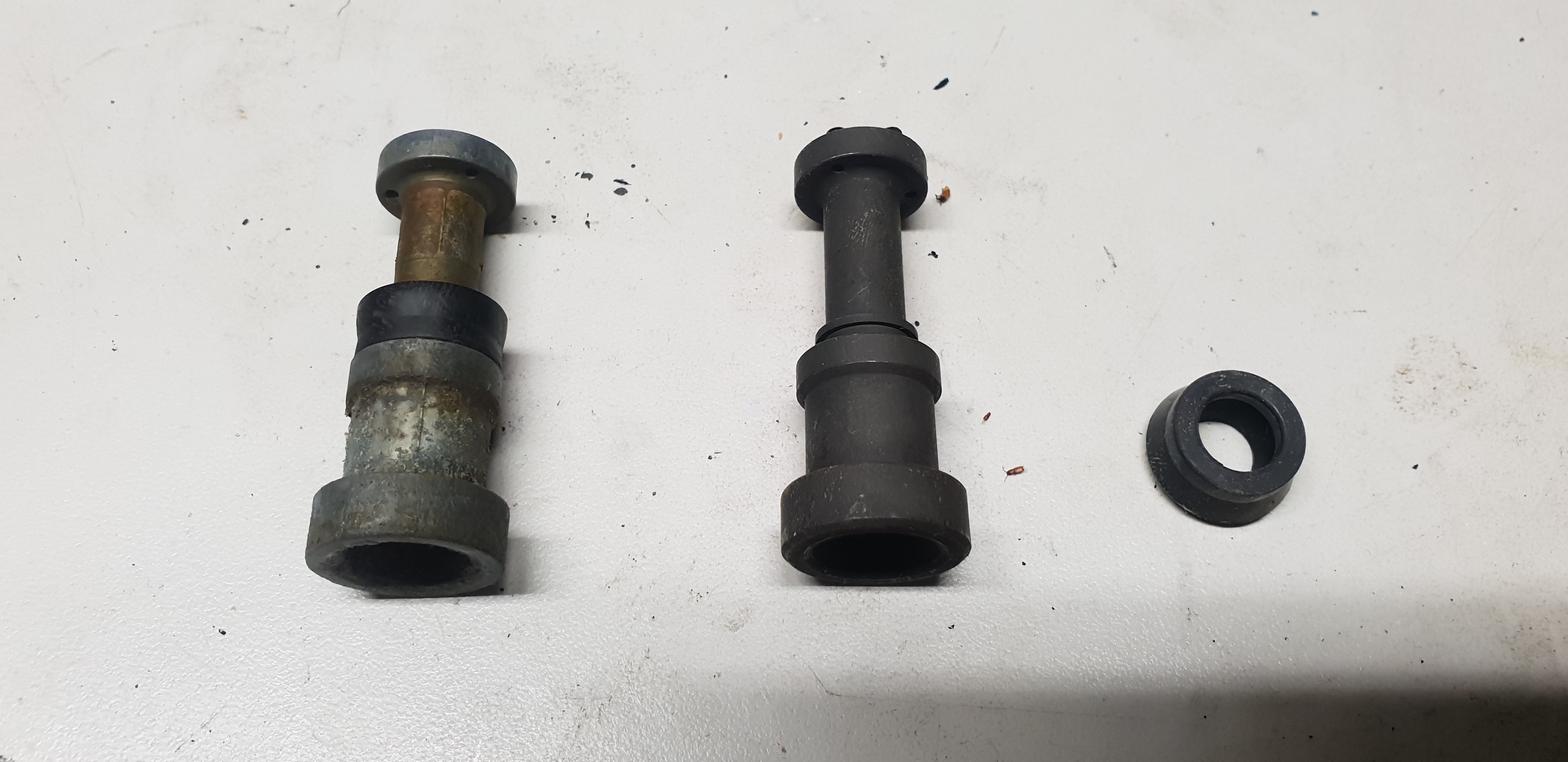

Ok, i have completely stripped and painted the rear brake master cylinder for my Z1000 A1. I have a repair kit in hand and am at the stage of re-assembly.
The old plunger is on the left and the new one on the right. How do I get the seal on without destroying it.
Obviously it goes on but its very tight and I don't want to tear or stretch it. Also I am at a loss as to what lubricant I could put on that won't affect its operation.
Nico

get yourself some red rubber grease (oohh err mrs).
Its what recommended

#4 PostAuthor: z1bman » Tue Mar 05, 2019 11:02 am
wrap some electrical tape around the end of the piston to prevent damage to the seal

#5 PostAuthor: hartyb » Tue Mar 05, 2019 11:31 am
before fitting drop it in a cup of just boiled water and use the tips above as well
