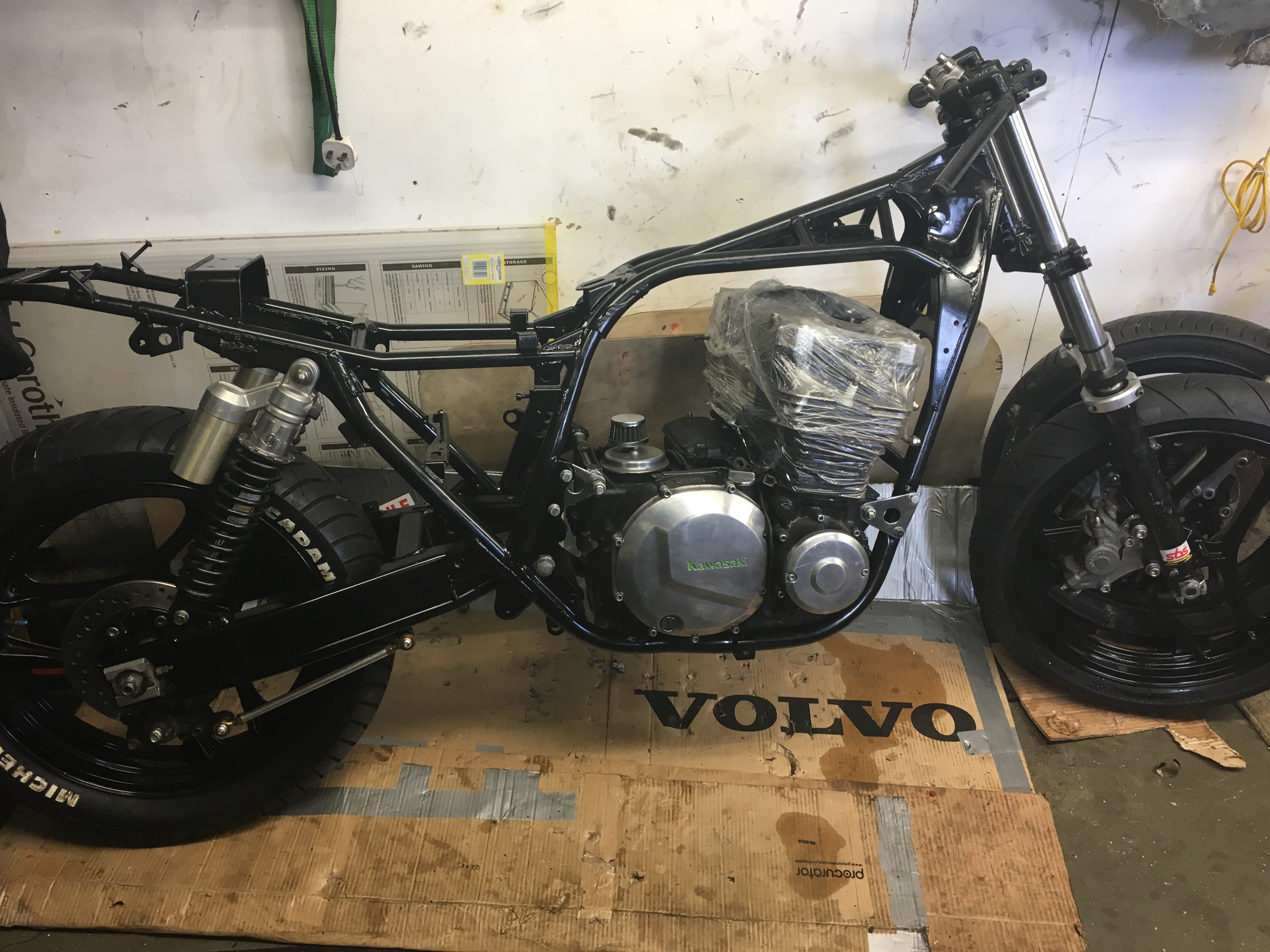

Author: KWACKERZ1
I have just fitted an XJR swinger in this. Looks like it will work well.

Author: scott
Looks good Phil. You haven’t moved the shock mounts have you, by the looks of it. Now I can see how it’s going to look all black maybe I won’t move the bracket :roll: any chance of a picture from behind, that’s when I think it looks a bit wide.

Author: KWACKERZ1
Scot Cannot get to the back, for a photo but I did move the shock mounts to line the shocks up.
The mounts currently sit 116 mm from the rear of the swing arm and 490mm bolt centre to swing arm spindle.
Shocks are 365mm long.
The swing arm clears but is close to the frame footrest mounts so you would not get nuts on the back of the brackets.

Author: scott
I noticed that the swing arm is very close to the frame where the footrest bracket/lug is. Don’t the footrest brackets just bolt on with no nuts on the back?(gpz1100b1).
Re: Welding
Posted: Tue Mar 19, 2019 9:32 pm
Author: KWACKERZ1
Yes mine do! Not sure about standard ones I have never checked, the frame lugs are threaded.
