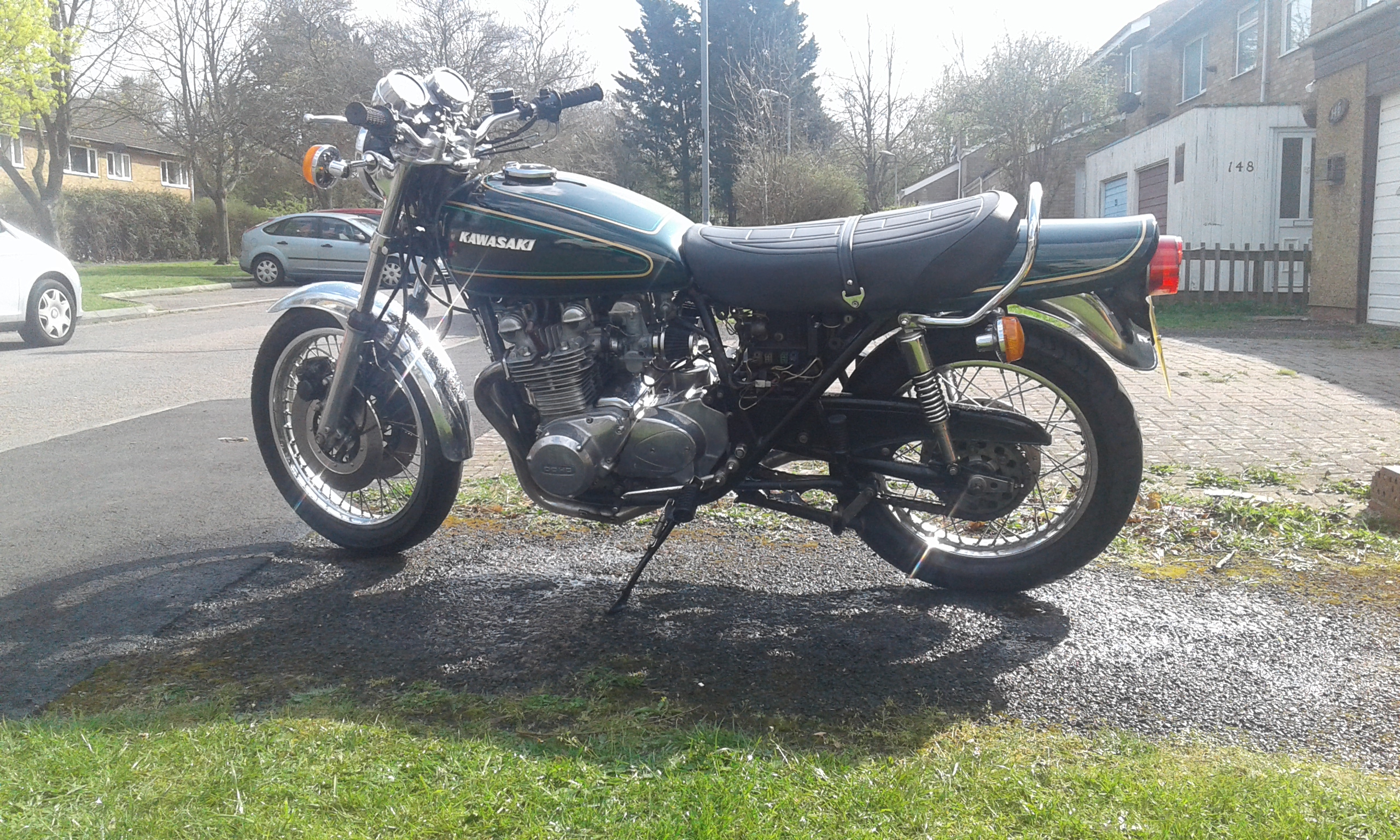

I had this bike 22years I do not want to restore it i like they way it has aged but with the faded chrome but would like to clean the engine I spent most of the day on the tank but will not get repainted I prefer the look that it has aged but kept in good condition how they use to look not to shiny I will see how I get on thanks

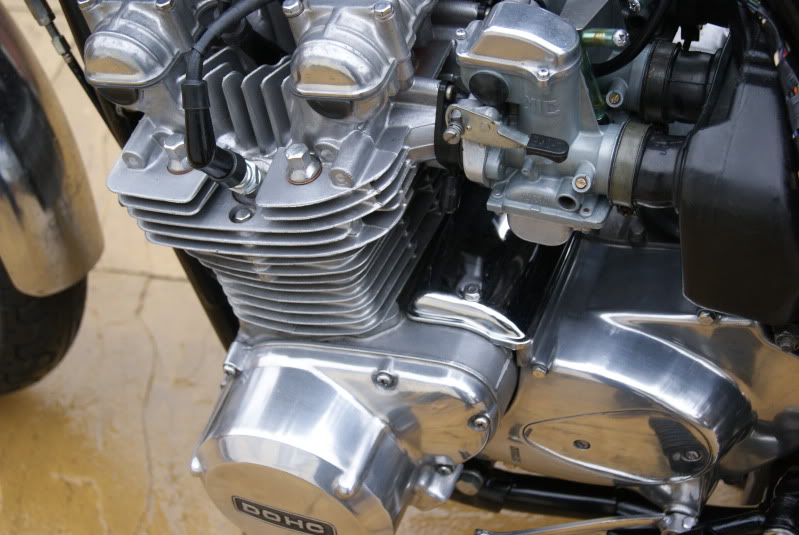

I've blinged up a good few engines, however several years ago I picked up a very original 900A4. The engine had the usual white corrosion patches and the typical dull grey look. Given the bikes originality I didn't want to go too Bling so I just did the minimum to get it looking tidy without the 'Just Blasted' look, all done by hand.
As said though, even this dumbed down look took a lot of time and effort.

That engine looks perfect , I have allready started on my , I seem to be getting good results using gunk spray and a brush my starting to look like that ,did try muck off spray and it was rubbish so took back to the shop ,will do a bit more tomorrow I will be happy if I can get my engine looking that good
