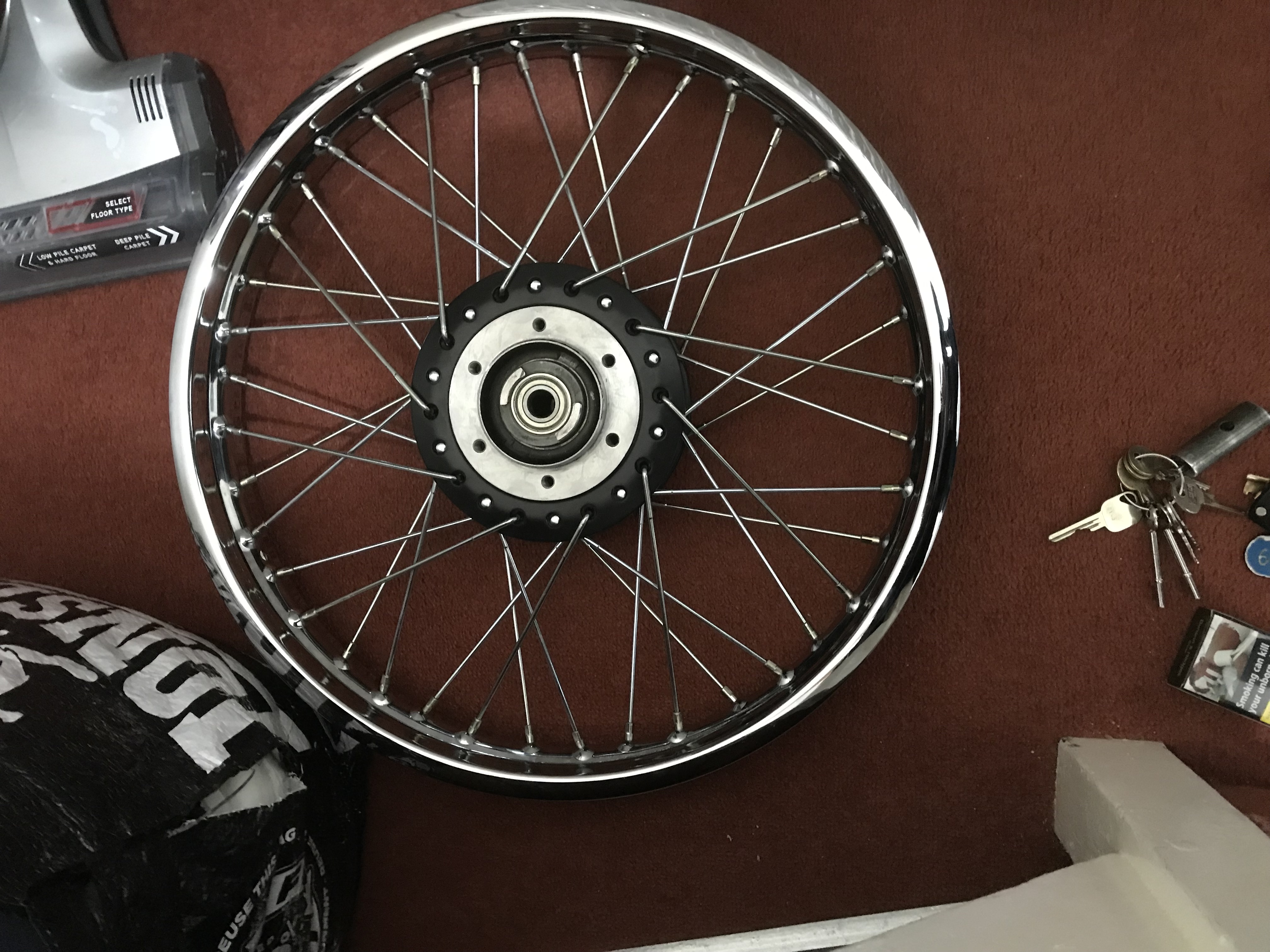

Just finished lacing my front wheel.

#13 PostAuthor: Adrian90s » Tue Apr 02, 2019 7:36 pm
What's those plastic bits in the hub? Some of mine are broken, can I replace them? Look like rivet heads but white plastic.
Re: Front mudguard
#14 PostAuthor: ADRIAN H » Tue Apr 02, 2019 7:48 pm
Adrian90s wrote:What's those plastic bits in the hub? Some of mine are broken, can I replace them? Look like rivet heads but white plastic.
They are plugs for the bolts which secure the chrome dust cap bolts fit into.
£26.62 each on ebay.
https://www.ebay.co.uk/itm/321272303667
