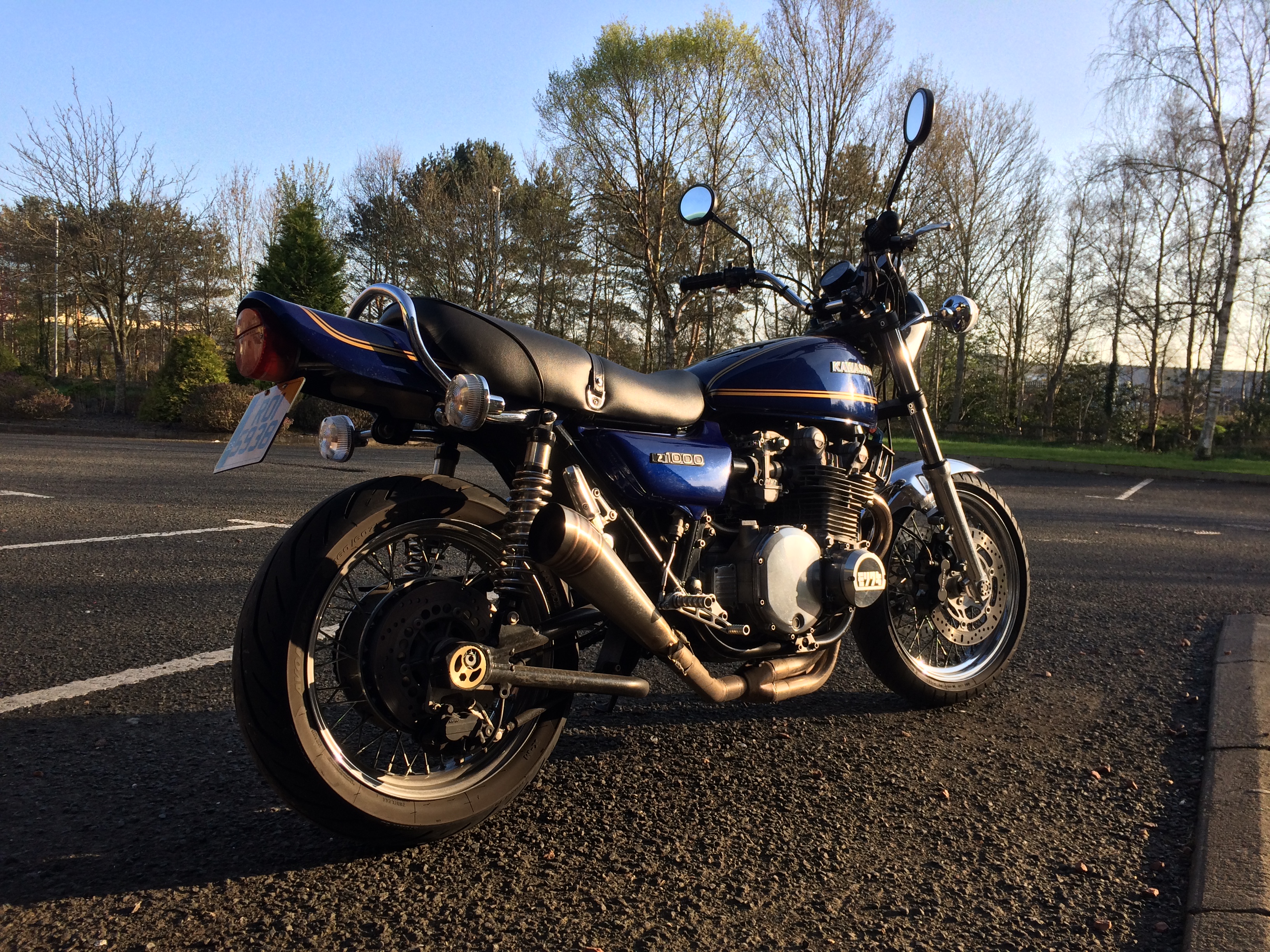

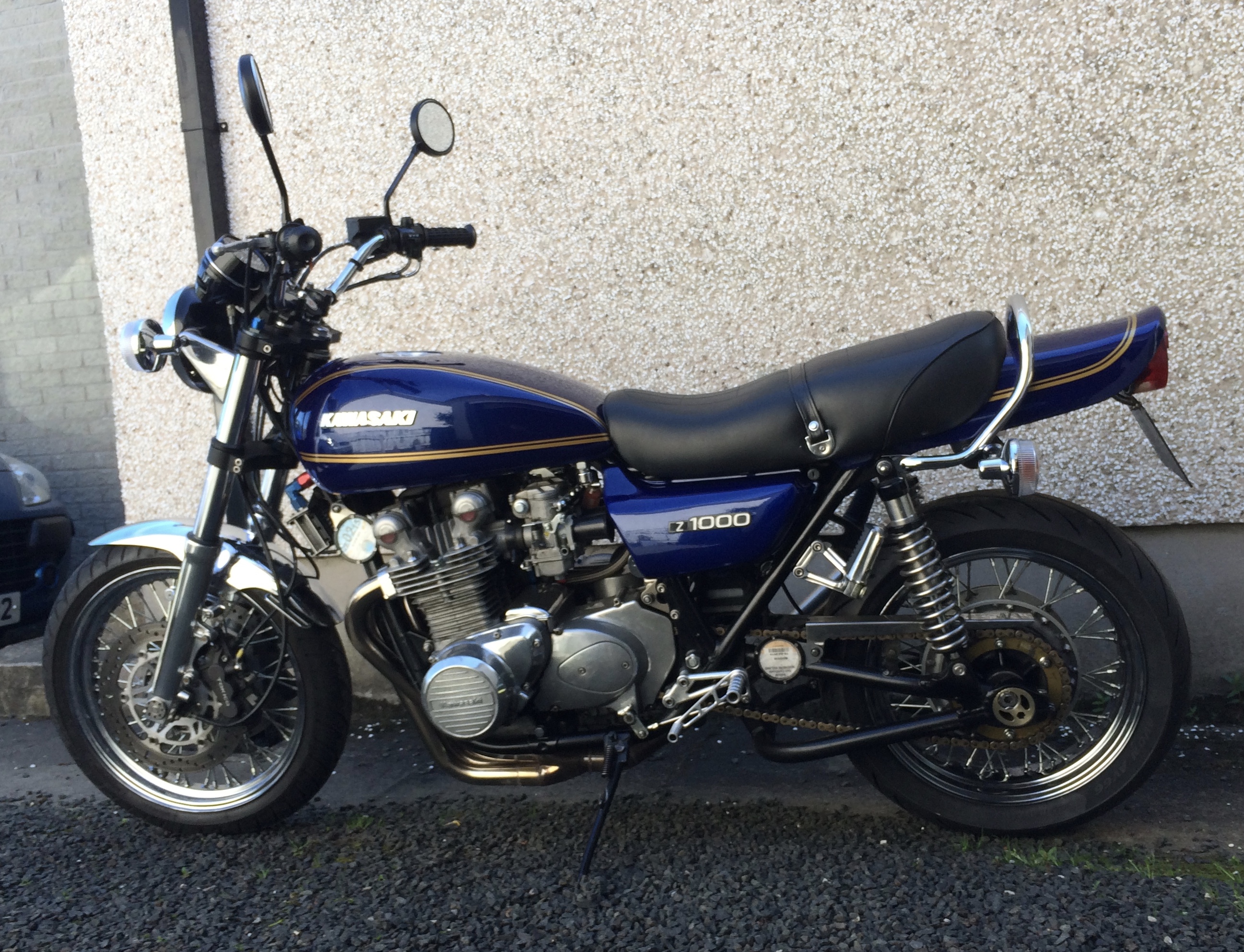

#3 PostAuthor: chrisNI » Fri Apr 05, 2019 8:12 pm
I used GPZ 600 a lot of the eighties Kawasaki ones are suitable. The ones that have exhaust mounts on both sides it’s easy to cut off the unwanted one and finish off.
These give the idea... obviously you can mount them whatever height you like I have these quite high :D
