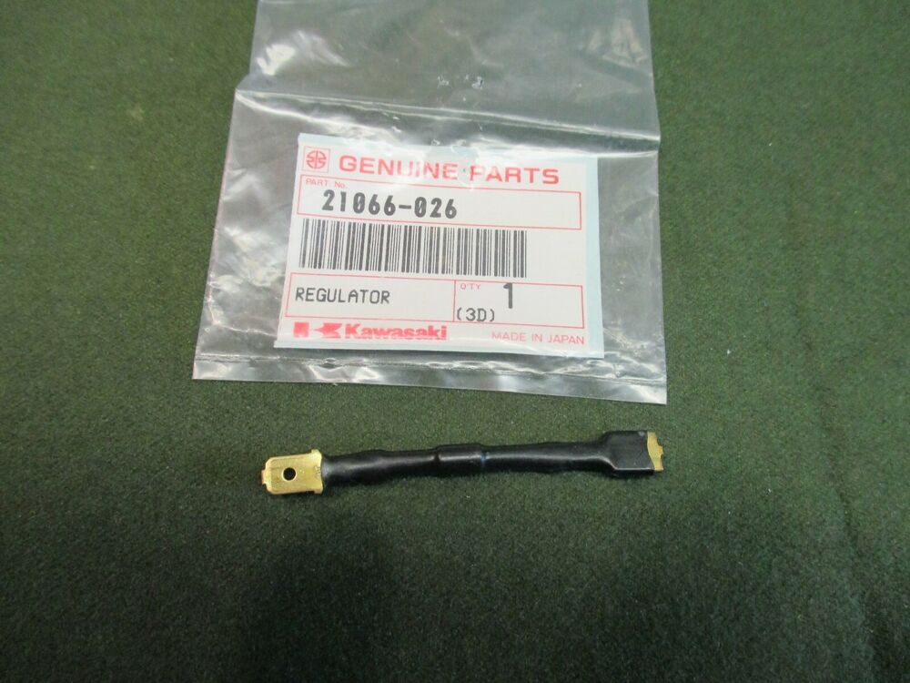

#6 PostAuthor: z1bman » Wed May 08, 2019 5:21 pm
have you checked this ?
