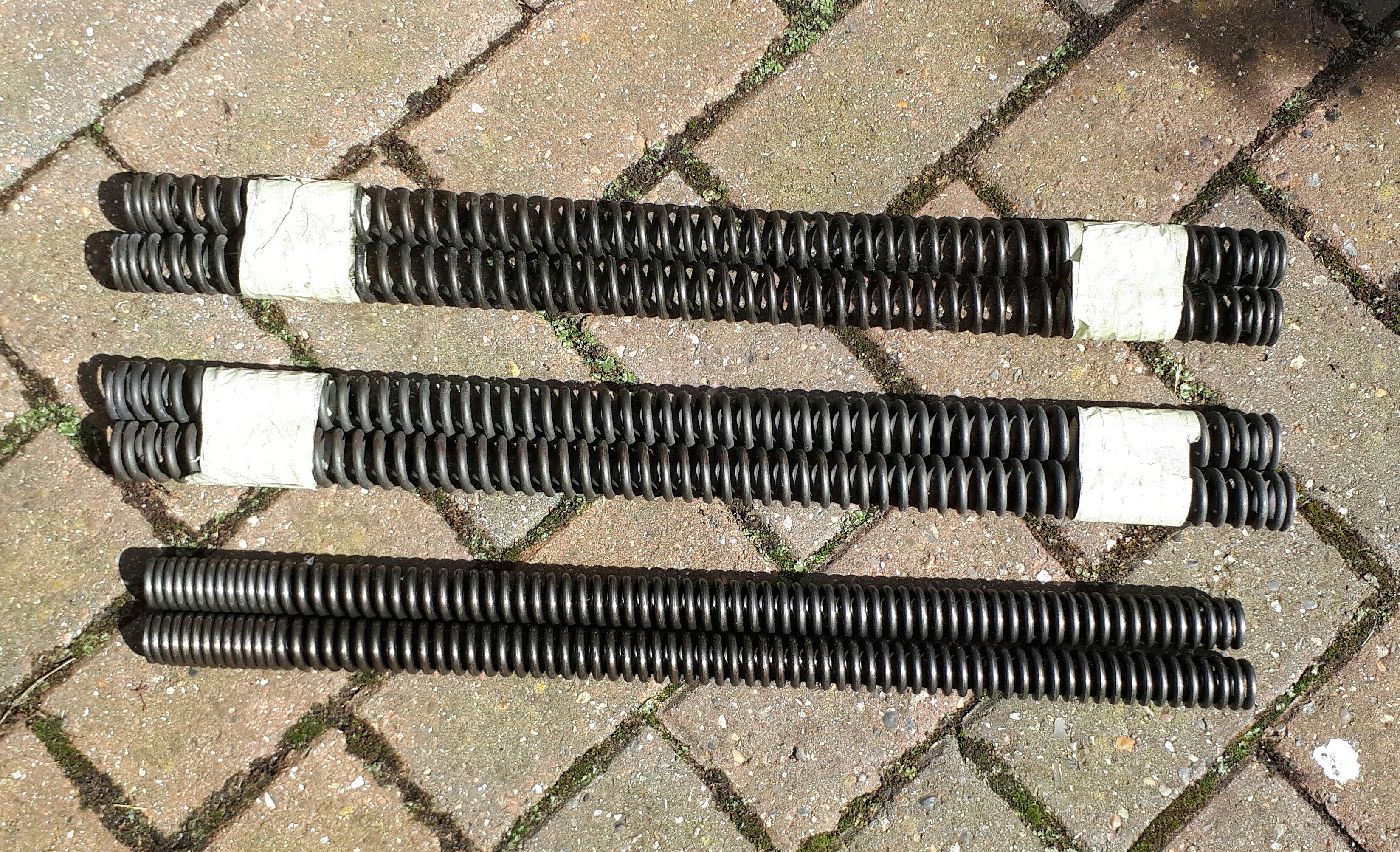

Guys, which of the springs below work best in B forks?
Top pair are 555mm long.
Middle are 545 long but thicker wire
Bottom are 505mm long.
I have a pair like the bottom pair in them at the mo but travel seems very limited at about 1 inch and stiff. Manual shows a pic like these as correct but 495mm long. Would 10mm longer really make that much difference?
Either off the top pair will be a pig to get in as they protude out the top and will need compressing to get the cap in.
The bottom pair are flush with the top of the fork leg and need compressing a tad to get the cap on.
Running 15w oil at 170ml. Manual says 10w. would 10w make that much difference?
Any suggestions as I took off a pair of A4 forks which were fine and gave about 3 inch travel but are not correct for the bike.
B fork springs.

From the info i Have Warren, the springs should be 511mm, if less than 485mm they need replacing, so the longer ones appear not to be for a B or A model.

What workshop manual do you have Kev? Mine says 495 standard, 485 knackered.
I've put the a4 ones back on it for the moment until I can resolve the issue.

I guess its a Z1B 900, the 495 is correct, you should have more travel though, maybe the wrong springs right length possibly to thicker wire.

And it all becomes clear! The stanchions have been re chromed at some point and had high points in the chrome and were sticking in the lower leg as it slide in. A quick polish with nice and abrasive solvol autosol seems to high "adjusted" it and now it slides in and out without jamming.
Rebuilt them and filled with 10w and have smooth 3 inch travel on both fork legs. Next irk is squeeling pads. Tried copperslip and it works for about half an hour so need to swop out the pads. Which are non squeely?
