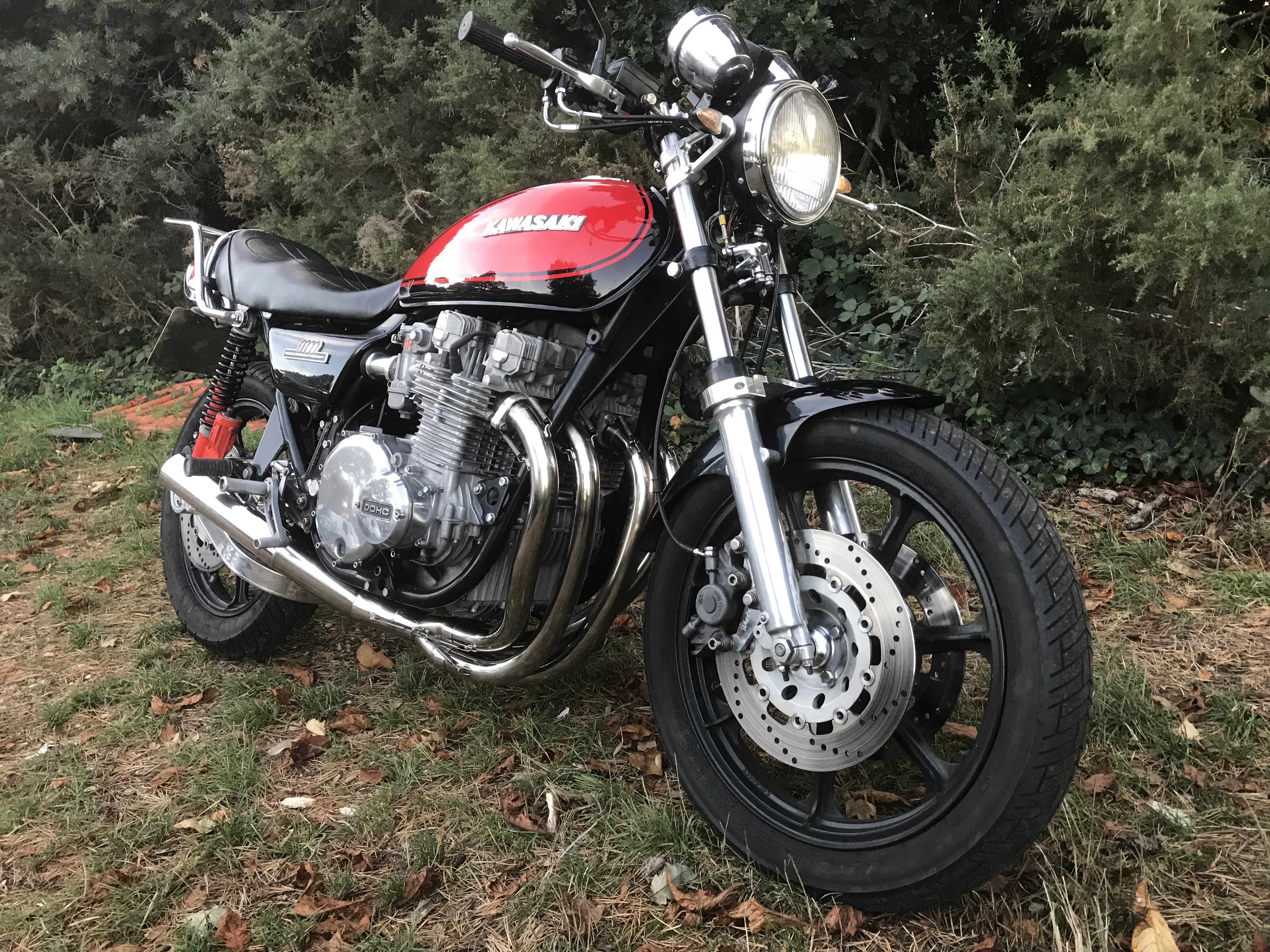

#10 PostAuthor: chrisNI » Wed Jun 19, 2019 8:40 pm
Well all I know is these went on here in 1979 or early 1980 and it’s a 19” front it’s still out in the garage. This pic is 1980.

#11 PostAuthor: ADRIAN H » Wed Jun 19, 2019 8:53 pm
My 1978 Z1000A2 - 18 inch front wheel.

#12 PostAuthor: chrisNI » Wed Jun 19, 2019 8:59 pm
You bought that new with an 18” front?

#15 PostAuthor: ADRIAN H » Thu Jun 20, 2019 7:09 pm
chrisNI wrote:You bought that new with an 18” front?
It’s a 2 owner bike. I bought the bike off a friend in 1985, who had had it from new, (with the 18 inch alloys front and back). I have known the bike from new as he lived 4 houses away. We used to hang out with the same group- The Wheelhouse Club.
