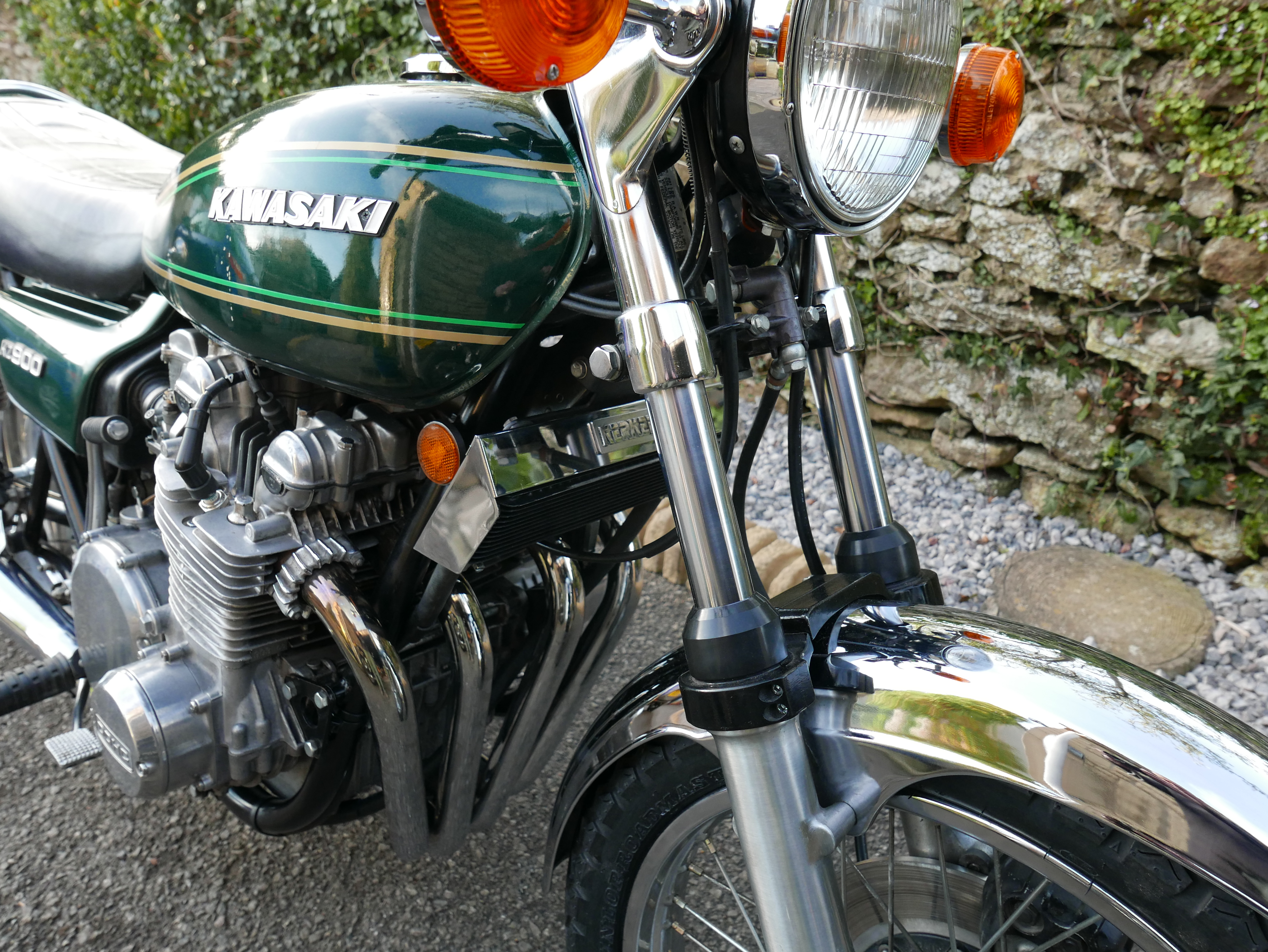

I had a std Z900 in great mechanical nick, one summer in heavy traffic at Poole Quay bike do - it was a hot afternoon & she cooked the oil - engine hissing like a steam engine.... ran fine again once cooled off for an hour or so :shock:

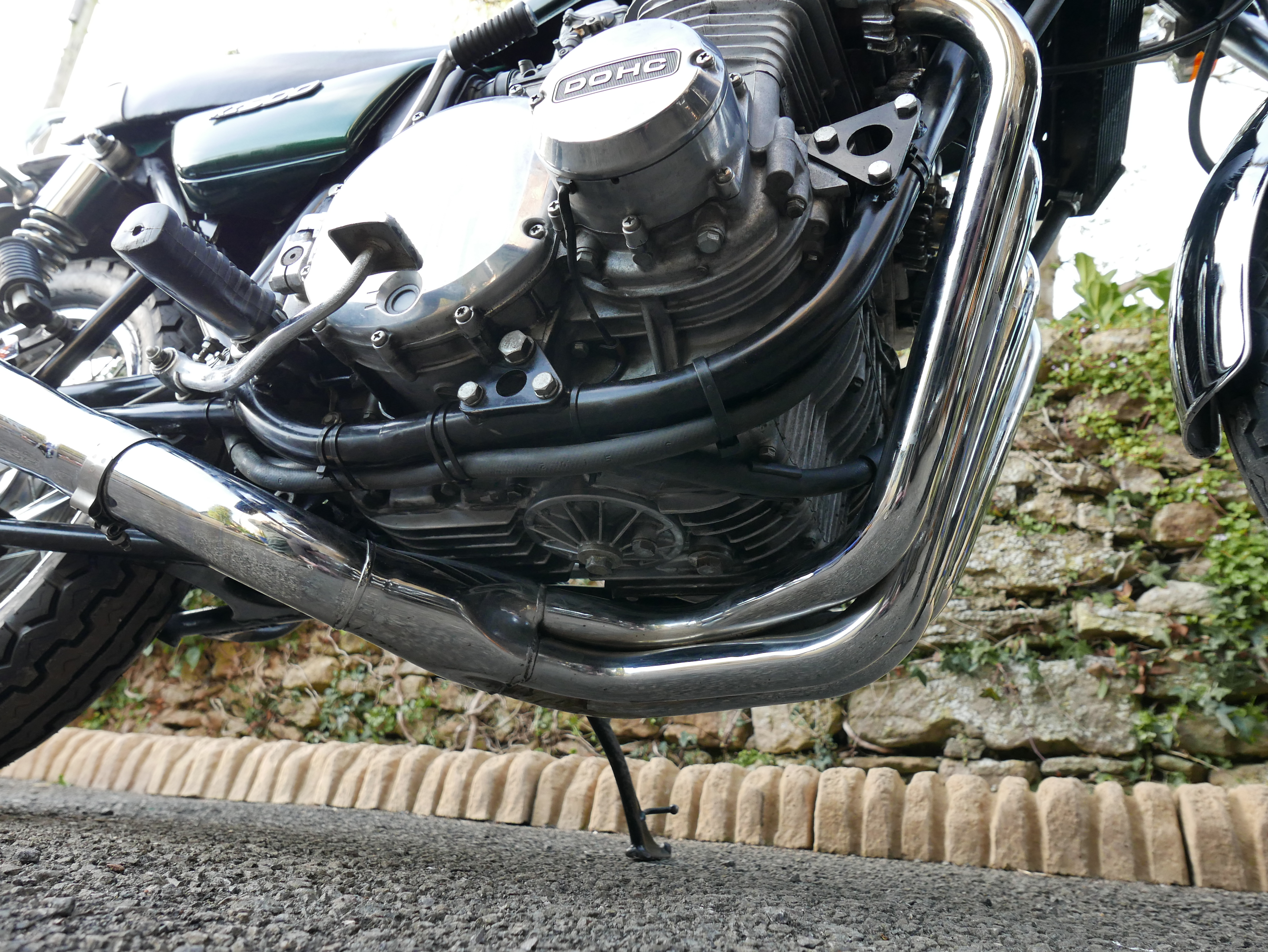

I had a std Z900 in great mechanical nick (no cooler), one summer in heavy traffic at Poole Quay bike do - it was a hot afternoon & she cooked the oil - engine hissing like a steam engine.... ran fine again once cooled off for an hour or so :shock:
My std Z900A4 has one - easy enuff to blank the cooler off in cooler weather - great peace of mind.

Thanks for the reply, thanks for the pics Piggy, cooler it is :D
