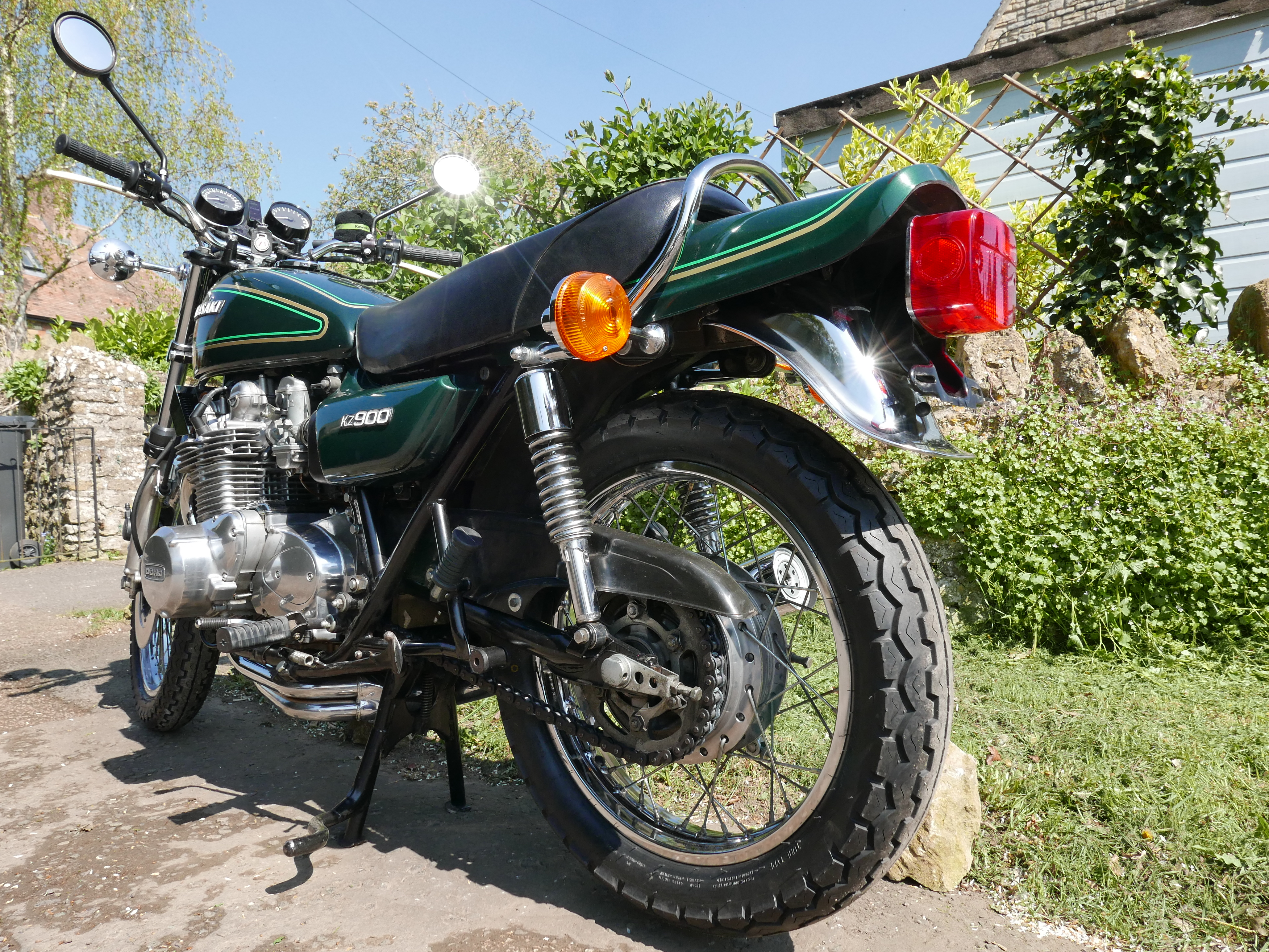

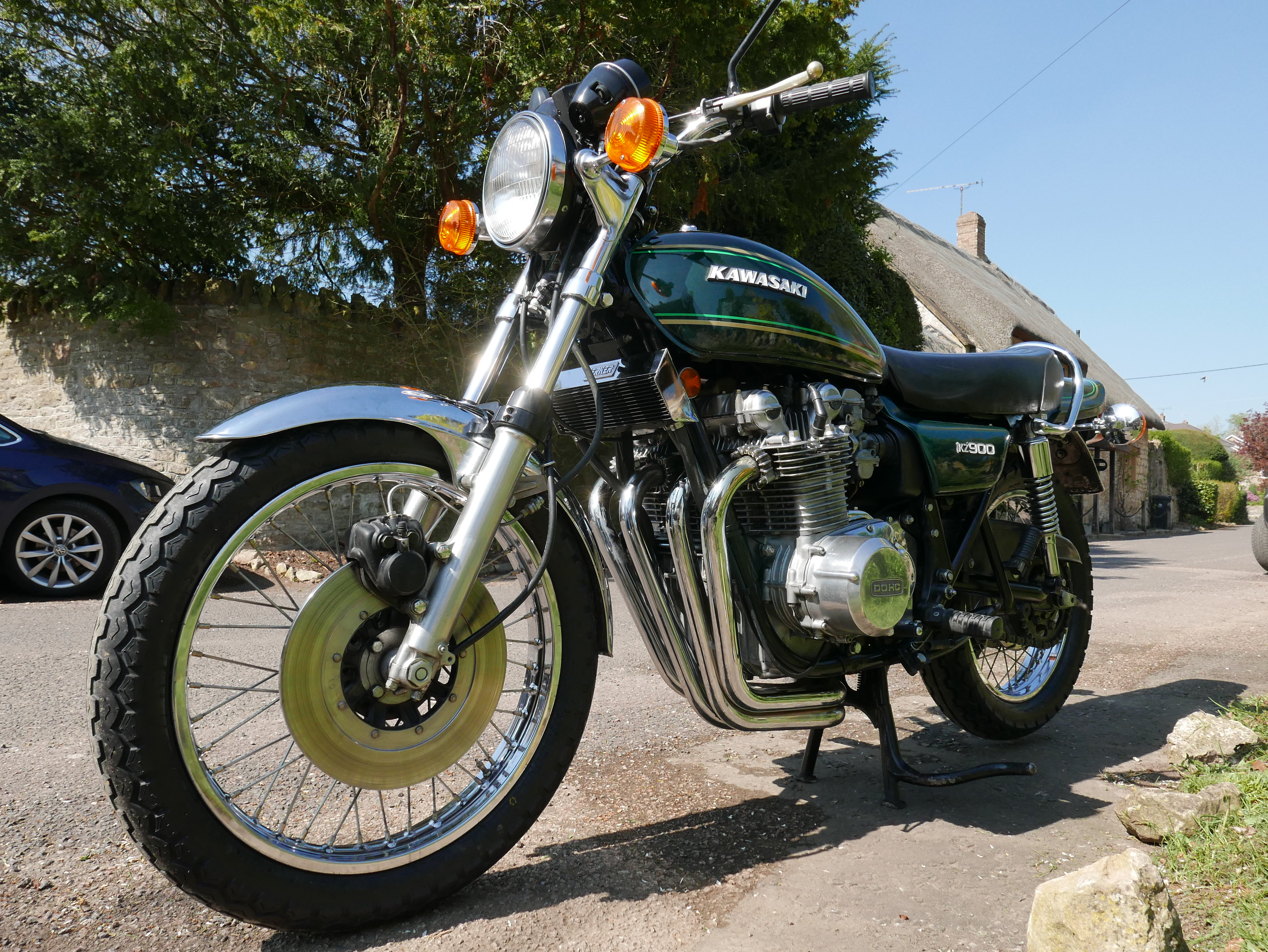

#5 PostAuthor: Julian_Boolean » Tue Jul 23, 2019 4:00 pm
They look very "period"

#6 PostAuthor: Pigford » Tue Jul 23, 2019 5:18 pm
Julian_Boolean wrote:They look very "period"
Yep had them on my A$ back in early 1980's. The track true & grip well, so get my vote for the old Zeds.
There maybe other tyres that perform a bit better, but the tread patterns look too modern to my eye.

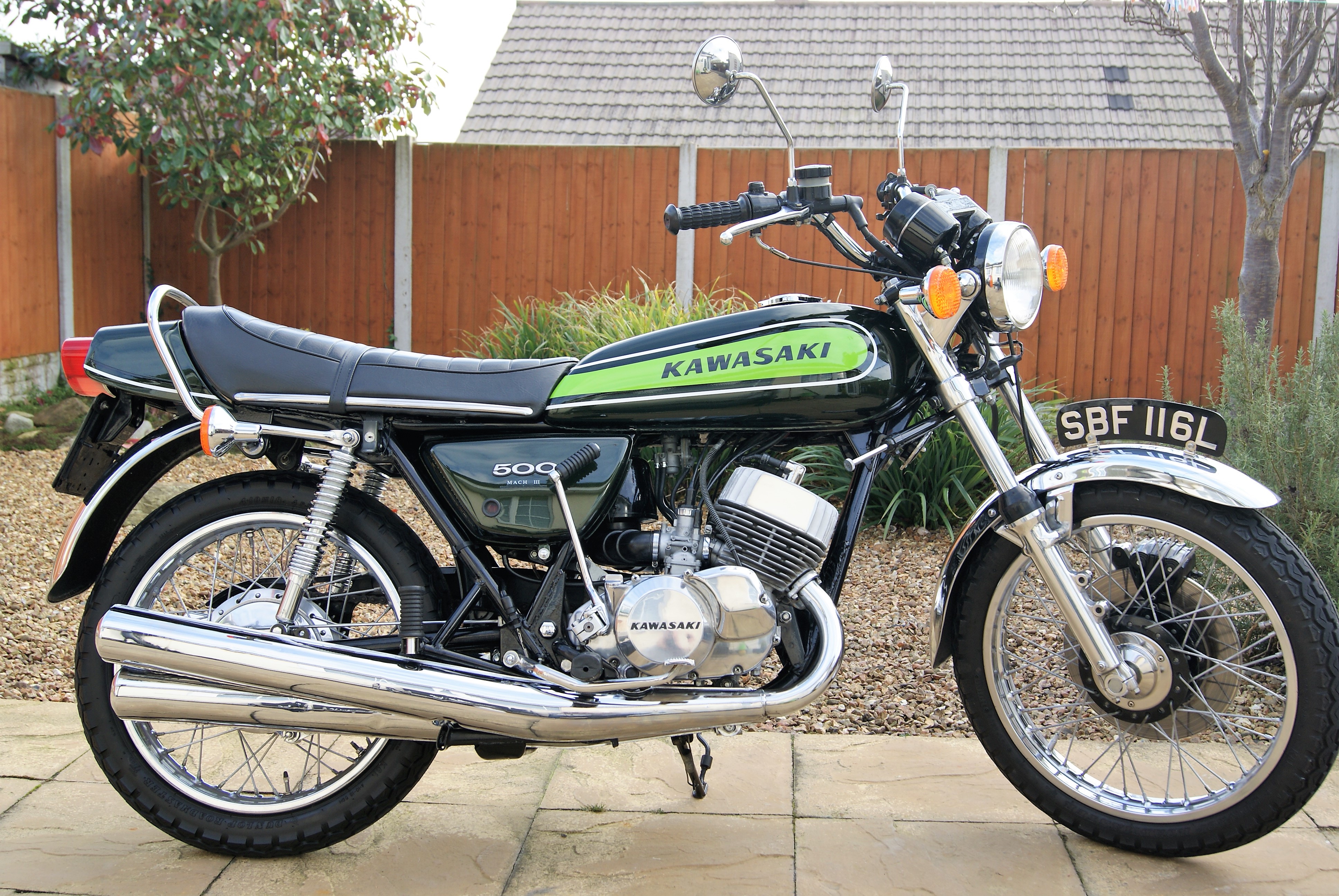

#7 PostAuthor: Garry.L » Tue Jul 23, 2019 7:30 pm
....... and Triples.
