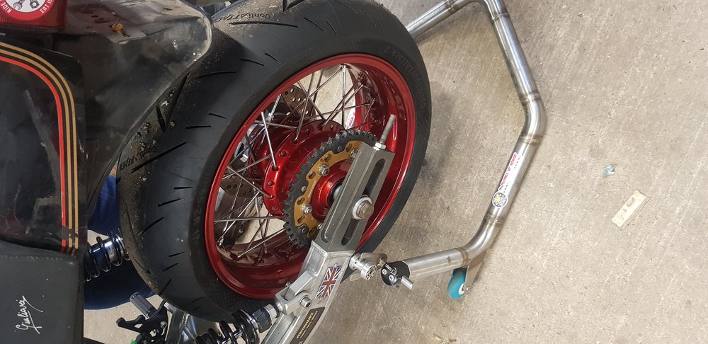

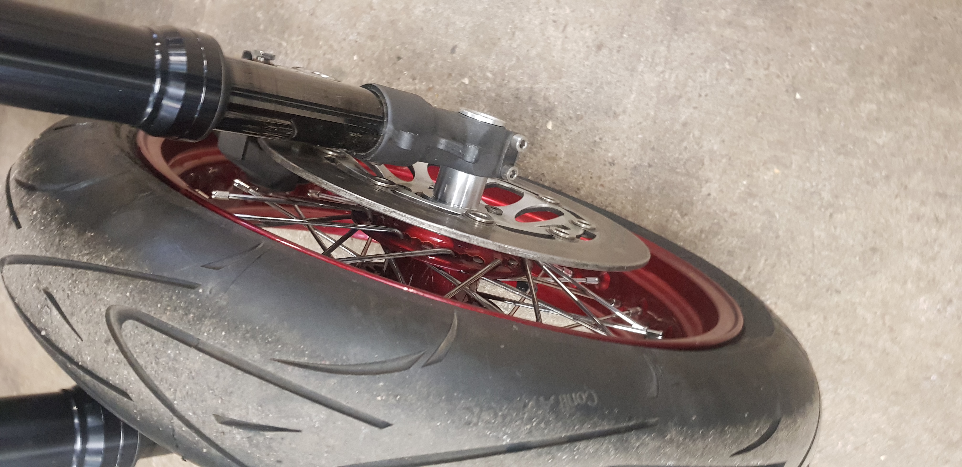

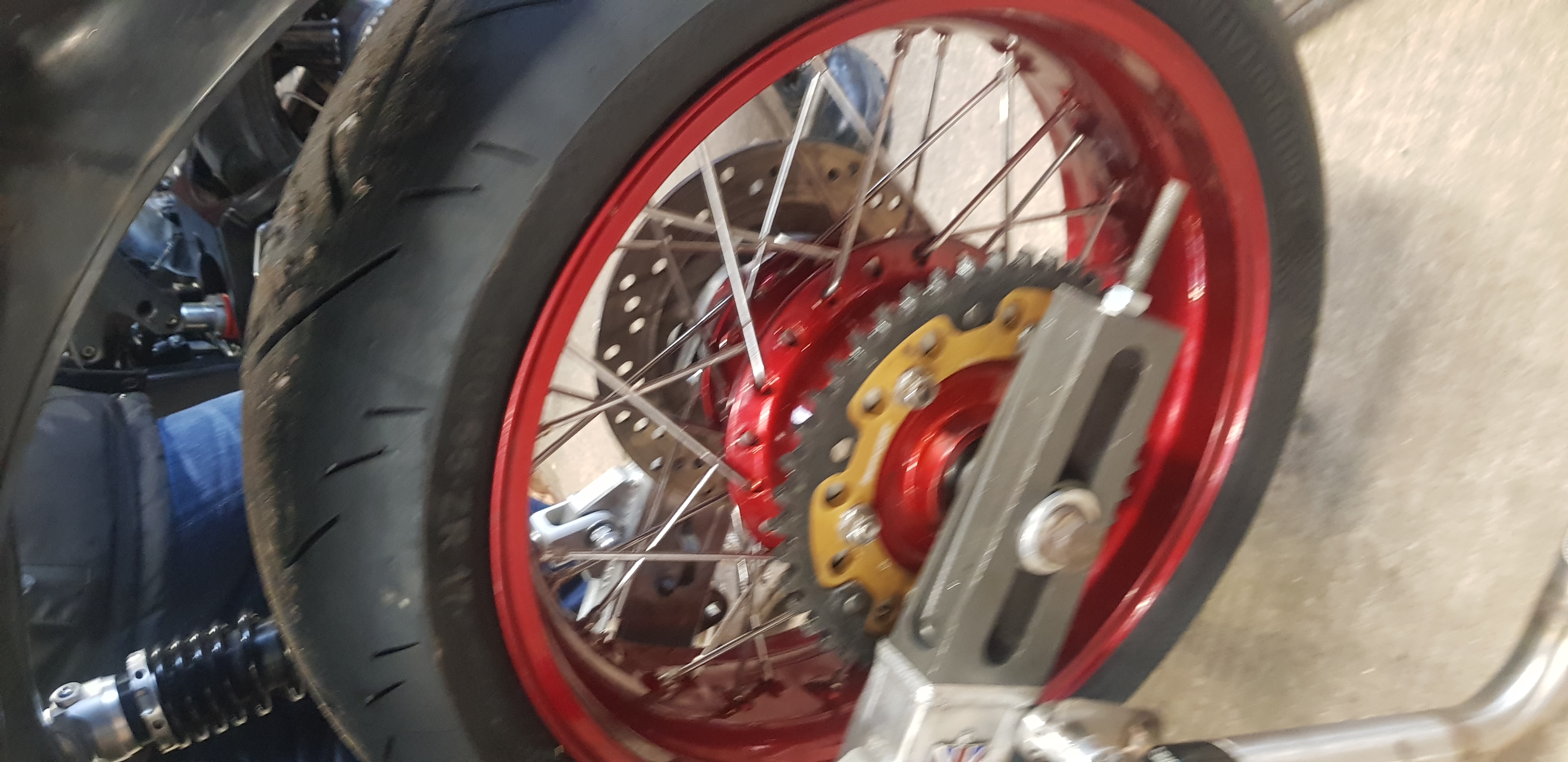

I've emailed central wheels over the weekend with some daft questions with some pics of what I'm trying to achieve, will await there reply, my mates GS has spoked wheels I'll post some pics for you to drool over, and my bike crazy boy. :D

#11 PostAuthor: oldzed » Wed Apr 15, 2020 6:52 pm
Now that is what I want.
What I end up with however may be a different story.
