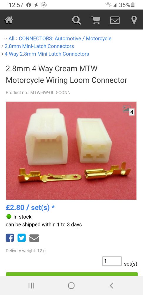

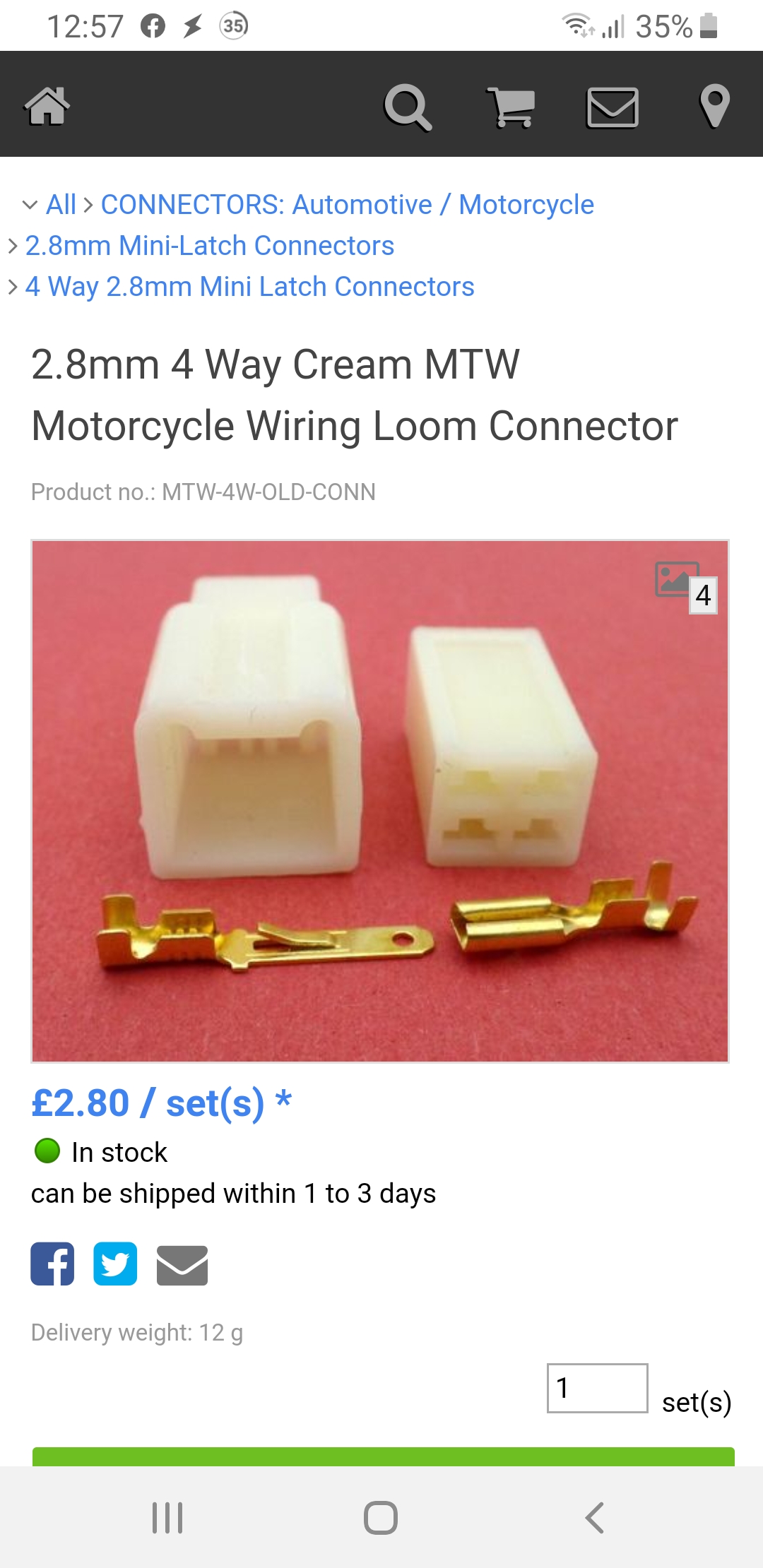

#3 PostAuthor: MikeP » Tue Apr 21, 2020 12:03 pm
Most have a clip to stop them coming detached but this is what I'm after:

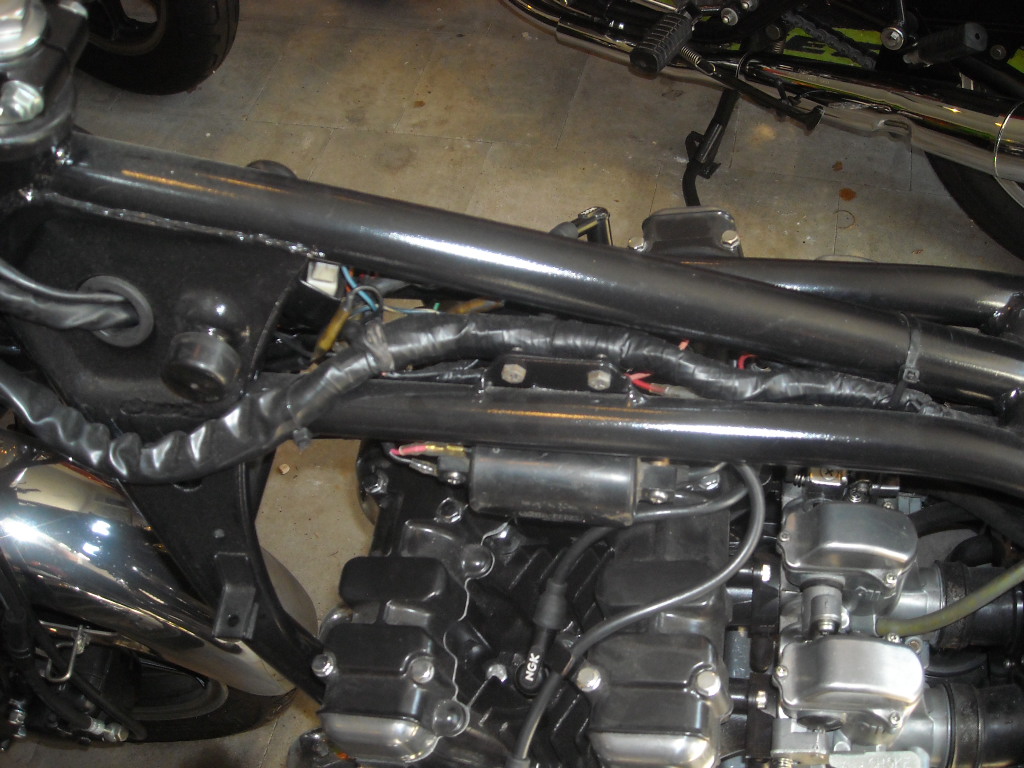

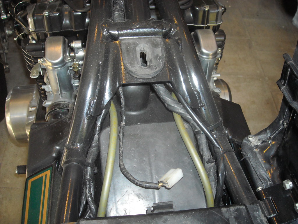

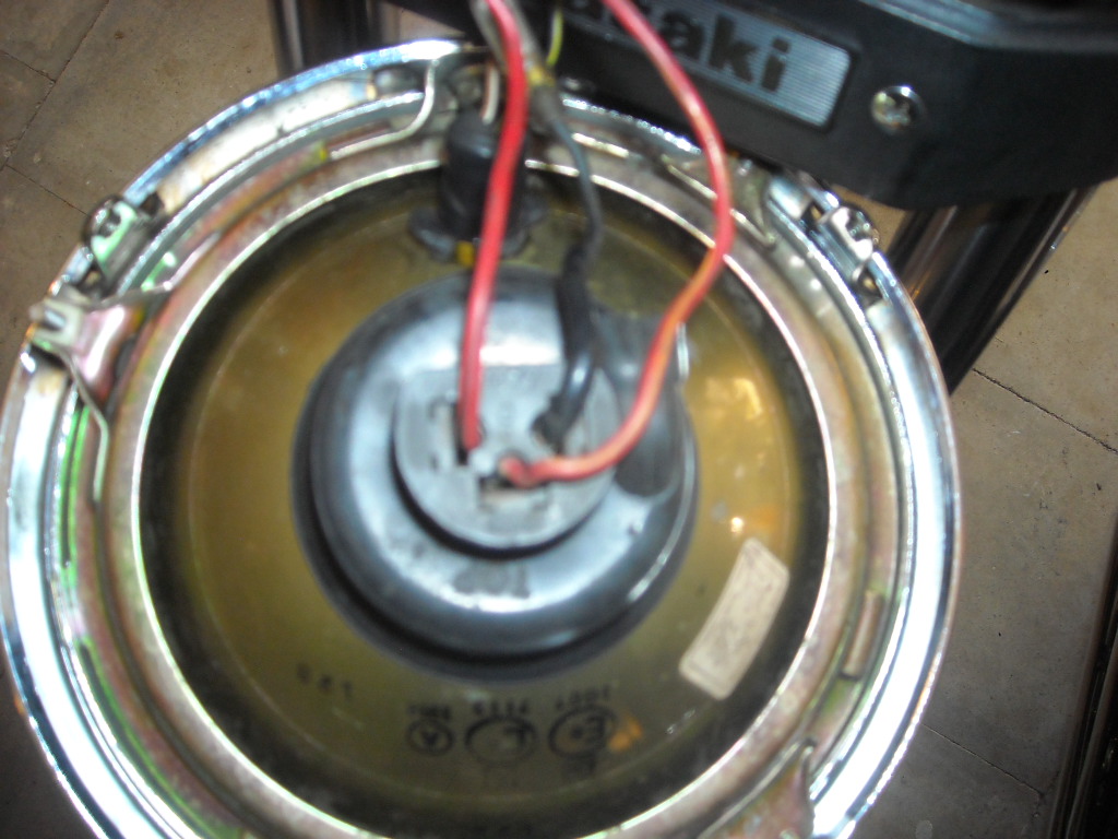

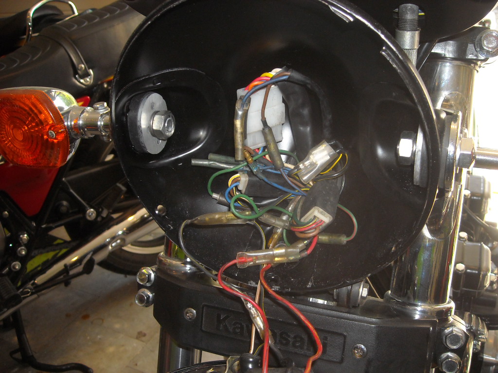

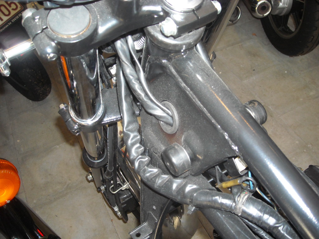

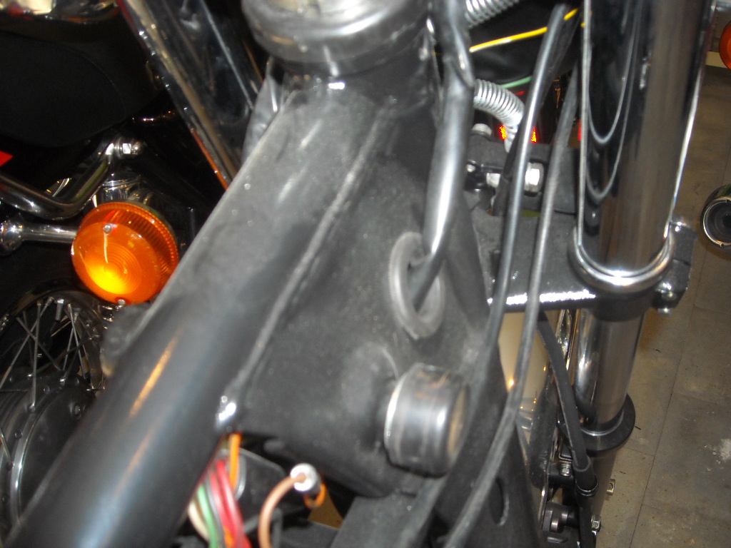

#14 PostAuthor: Philippe » Tue Apr 21, 2020 4:21 pm
Hi Mike
as promised some pictures of the routing of the ST loom. I put them here so the other guys can see them too and when answering with a personal message I can only attach one picture at the time...I'm not a computer wizzard after all. :D
The "start" of the main loom...
and where it leaves the upper frametube
the left hand side of the headstock
and the right hand side
the inside of the headlamp bowl
the connector of the lightbulb
I hope the pictures and the little explanation under them is clear enough.
As you can see the left hand switch loom is routed on the left hand side of the headstock on this bike but it's long enough to go around the headstock and enter the frame from the right hand side, the choice is up to you.
Good luck!

#15 PostAuthor: MikeP » Sun Apr 26, 2020 3:04 pm
Philippe wrote:Hi Mike
Good luck!
Thank you once again Philippe, for those great photos and the explanation too. The looms have been re-sleeved and now routed in readiness for the new original style multi pin blocks - slowly coming from the States.
