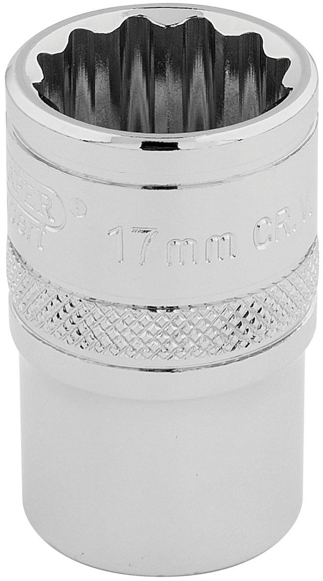

Cracked it folks, got it off - 30 seconds of a little heat, my 18" extension bar and a 12 point socket did the trick!
Thanks for the offer Chris, thankfully I don't need to take you up on it.

#9 PostAuthor: Andrew_s » Tue Apr 28, 2020 9:38 pm
Steve Cooke wrote:Andrew did you mean a six point socket?
No Steve, a 12 point for more bite than a 6 pt - like this one: https://www.ebay.co.uk/itm/1-2-Square-Drive-Hi-Torq-174-12-Point-Socket-17Mm-Draper-33167/312392840395?epid=927811778&hash=item48bc1074cb:g:IzIAAOSwYwZcHTT9

#10 PostAuthor: CAT3 » Tue Apr 28, 2020 11:06 pm
Not that it matters now, but I would have thought a good quality 6-point socket would be far less likely to round off an undamaged nut or bolt than any 12-point socket.
12-point sockets are really for 12-point nuts/bolts.

#11 PostAuthor: Steve Cooke » Wed Apr 29, 2020 8:27 am
That was my thoughts, a good quality six point socket is far superior to a twelve point, it did the job though so that's the main thing.
