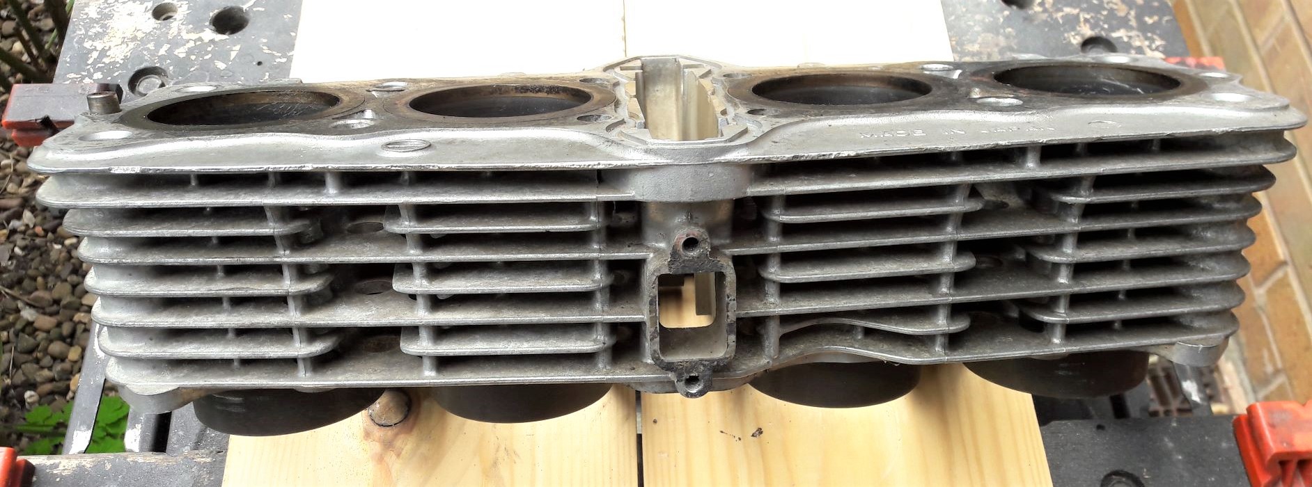

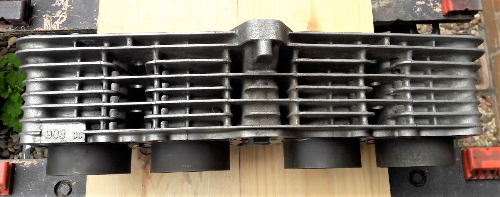

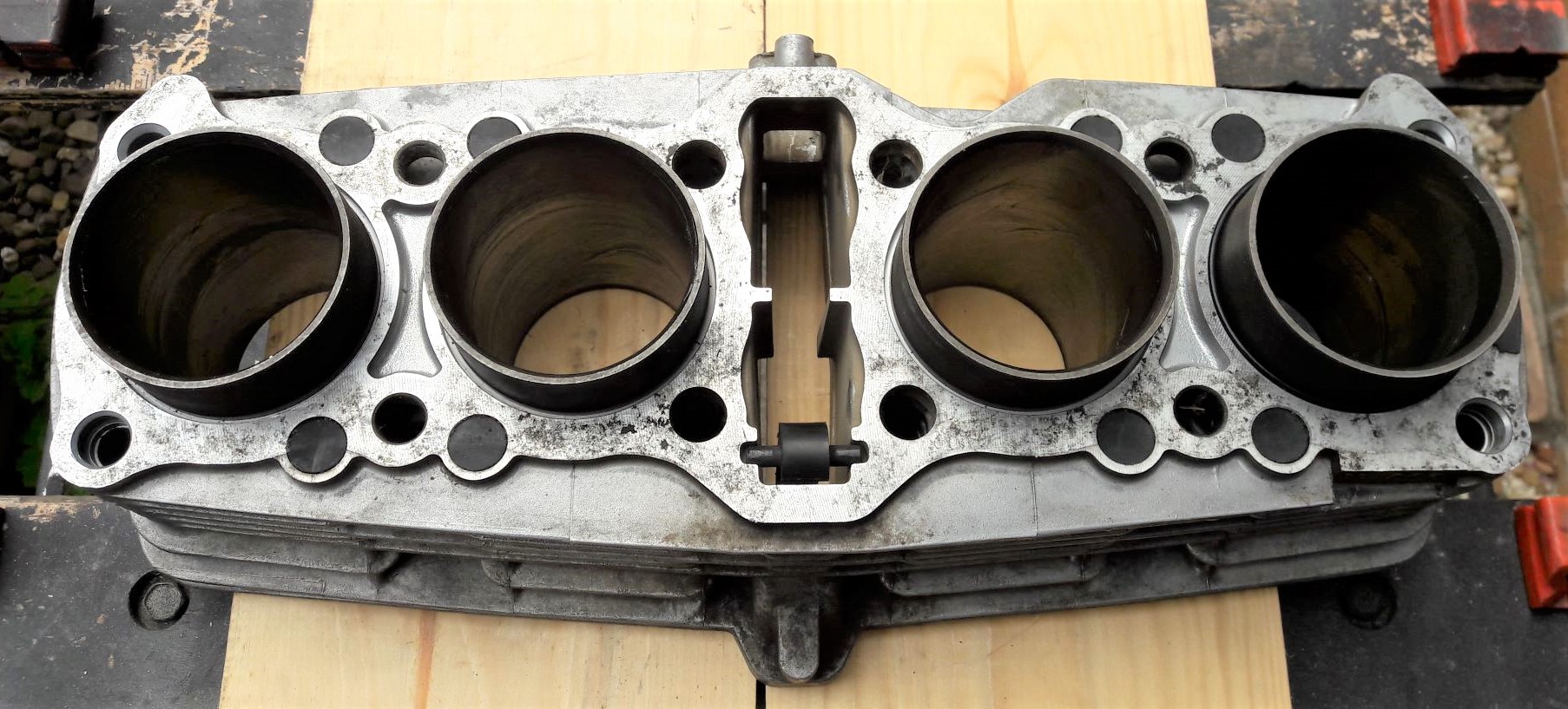

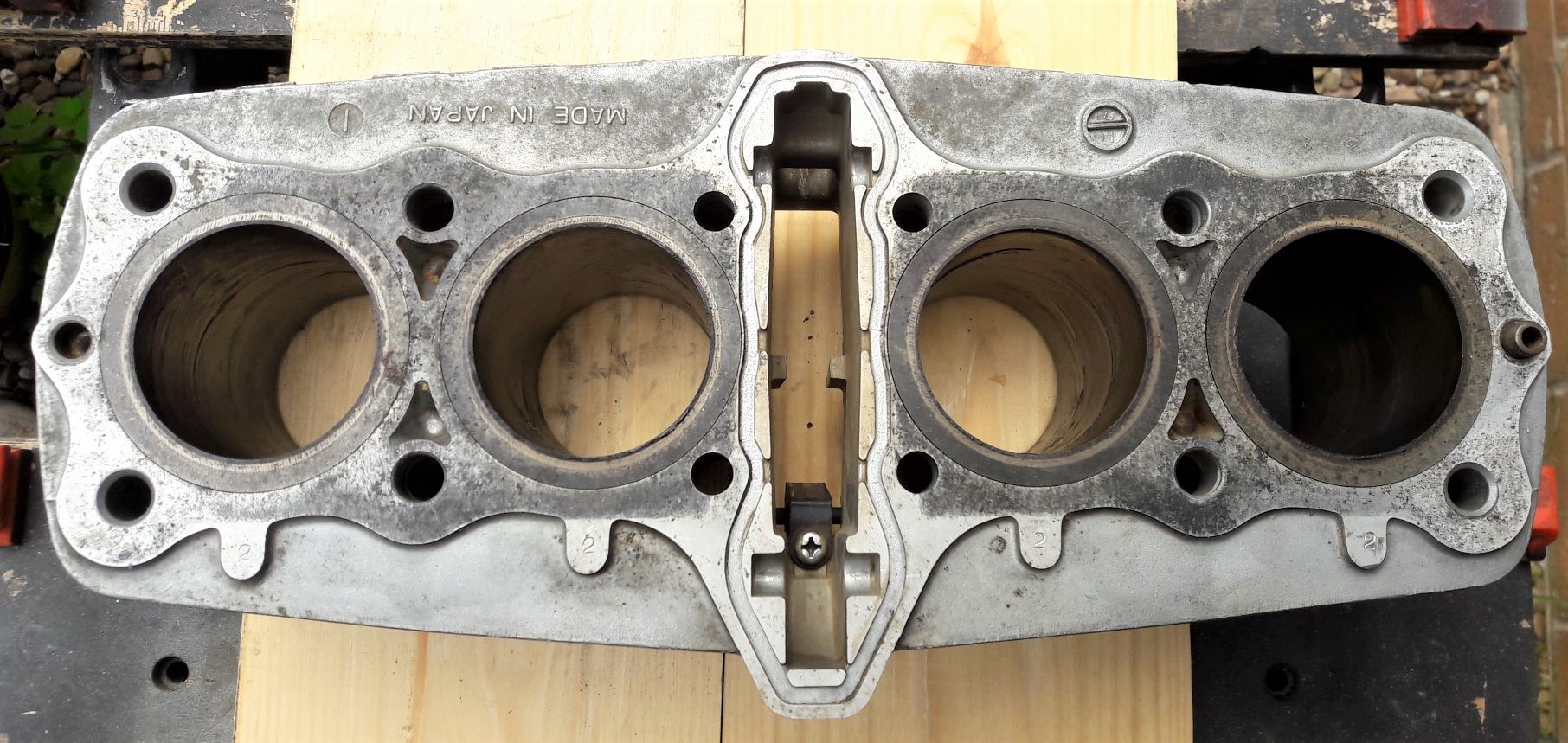

Can anyone help identify the model and or year that the following 903cc block comes from? Thanks for looking.

Z1A or Z1B (and some late first model Z1)

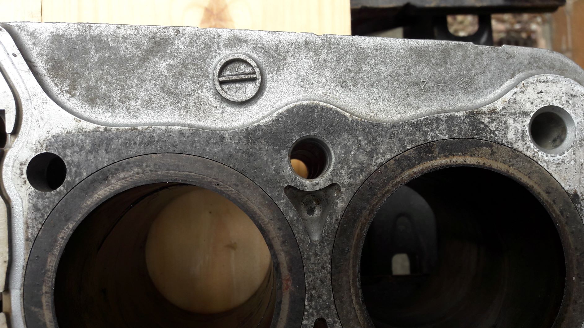

Thanks for the info John. Which are the date markers to look out for on the block?

I'm not aware of any date codes on the block but other owners may have some views on this.
If there is one I would imagine it is in the characters in the split circle.
