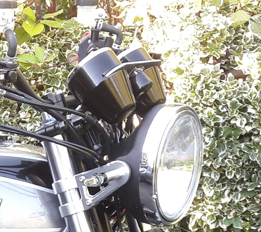

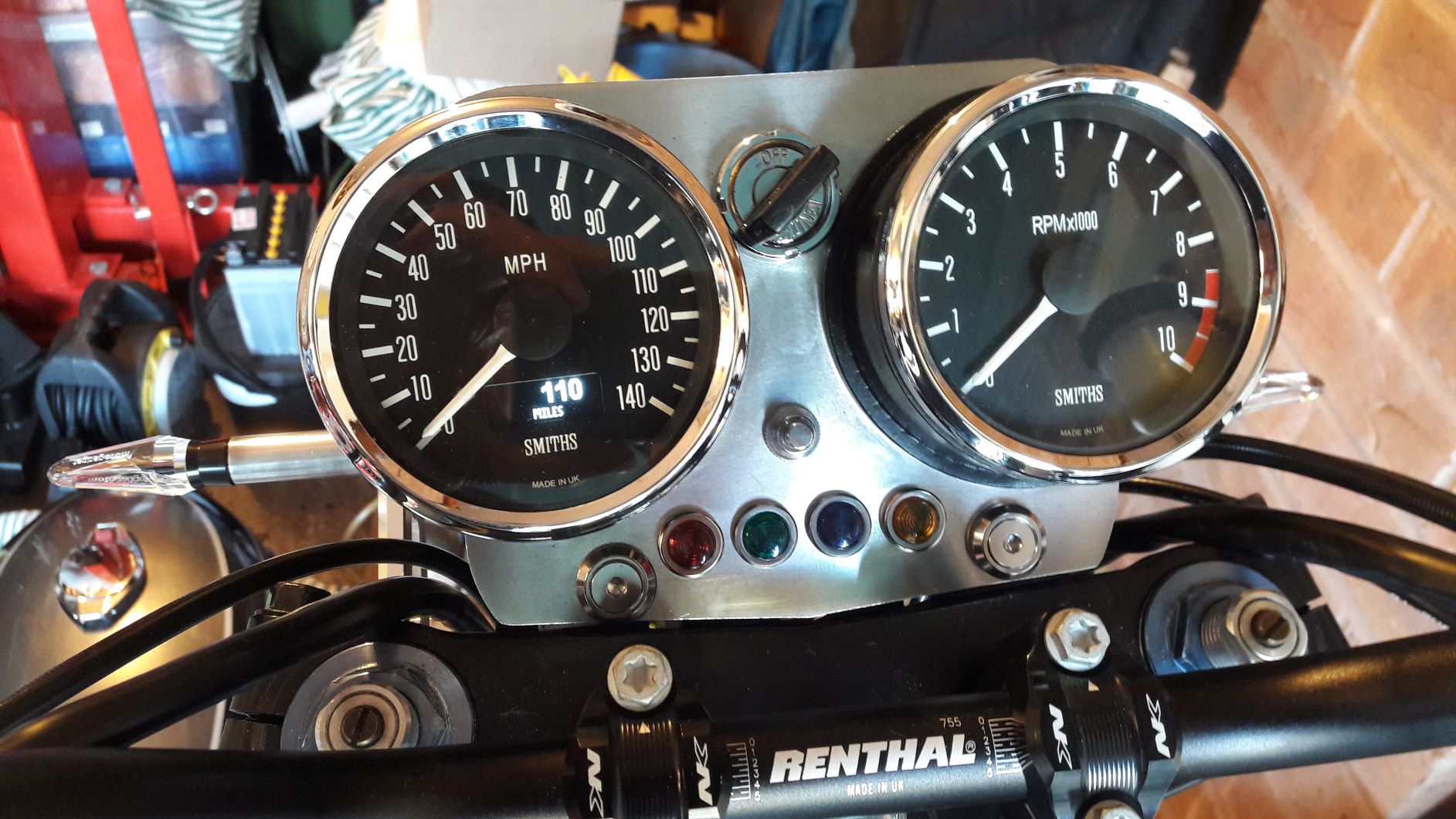

I went for all electronic clocks and plumped for Smiths given price and a matching pair and 1970's period look, can't comment on reliability yet, but they are still working after 12 months, but very little use.
I ended up making by own mount for the clocks and made the pods with 3D printing, all a bit of a fiddle but definitely unique. Speedo needs magnets on a wheel, I went for rear wheel and needs sensor and wiring to be mounted.

As per my earlier post I have Smiths fitted for both speedo and RPM. The only thing I found was that the manual on the set-up was a little vague and the defaults stated were not correct. It is best to assume nothing is set correctly and go through all the setting sequence. When adopted this approach all is working fine. Making a re-set button is much easier than touching a wire to ground whilst doing something else.
