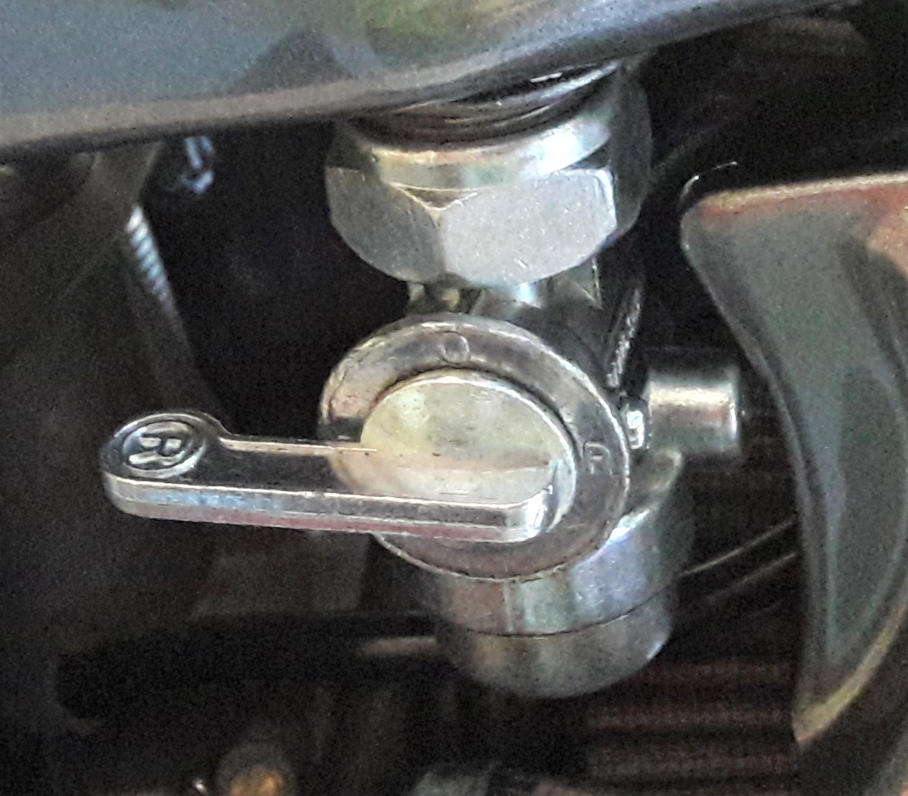

I replaced my original petcock 3 years ago due to it being so tight that it couldn't be switched to reserve by hand while moving. I replaced it with a non OEM part from Z Power. After a year or so, the replacement started leaking. Replaced the o seals last year and all was fine, laid the bike up in November. Fast forward to now, fuel leaking from the tap when in the "On" position only (OK in OFF and RESERVE positions).
So, Do I: a) replace all O seals again, b) replace the petcock with another from Z power(although out of stock presently), or c) do I pay 3 times as much and install a Pingel? - anyone experienced similar problem with these petcocks?

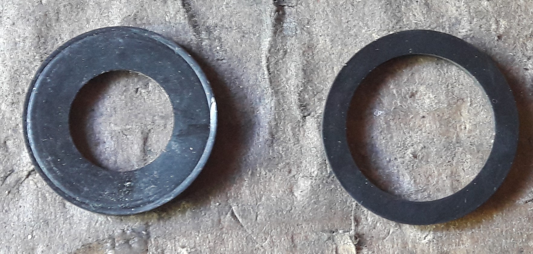

Hi, that sounds like a very familiar story. I bought a replacement petcock a while ago and yes it was leaking like a sieve when turned on a few weeks ago. It looks like it had been leaking previously when used since there were marks on the K&N filters from the petrol. I located the problem to the seal in the strainer bowl and in fact the original seal as fitted was not correct (too large). I bought a seal kit from Zpower last week and fitted the new seal in the strainer bowl and no leaking at all. Very happy. (£8 for the seal kit or bottom seal only £3)

here is a picture of the offending petcock and the poor strainer bowl seal alongside a new seal from Z-Power.

Yes, it's for Z1R, the original oem tap is the one that was too stiff to operate, the current one is from Zpower and is not oem.
I'm wondering whether to replace the second one now, and if so whether to go for the same again (£45) or spend £150 on a Pingel which looks nothing like the original kwak one..... but is it less likely to leak after a year or two?

Mine is not the same as the one pictured, (no strainer bowl), leak only in ON position, and is OK in RES and OFF positions....
