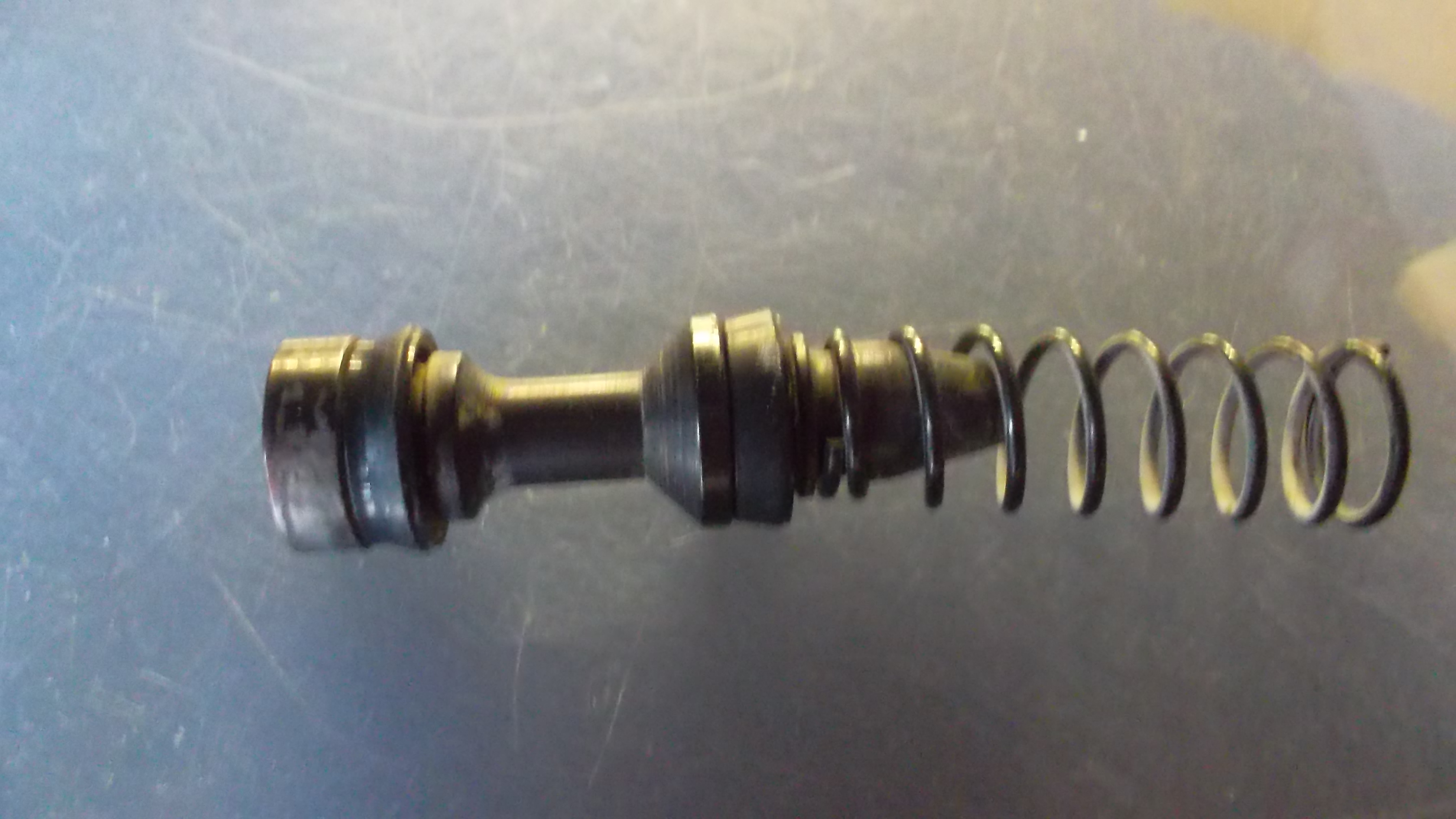

thanks guys, I am beginning to wonder if there is confusion about the part, I have been looking under repair kit, it is listed as a "piston assembly" on some sites which seems more correct and I think I may be getting closer to finding it.
What I need is a nice clear parts diagram for the Z1100R and the Z1000J as I am told it is definitely the same part used on these bikes in particular but I can't read the part number!
This is a picture of the original one which was apparently faulty, beginning to wonder now

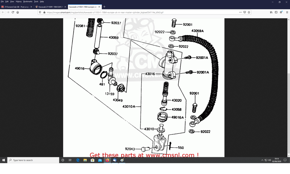

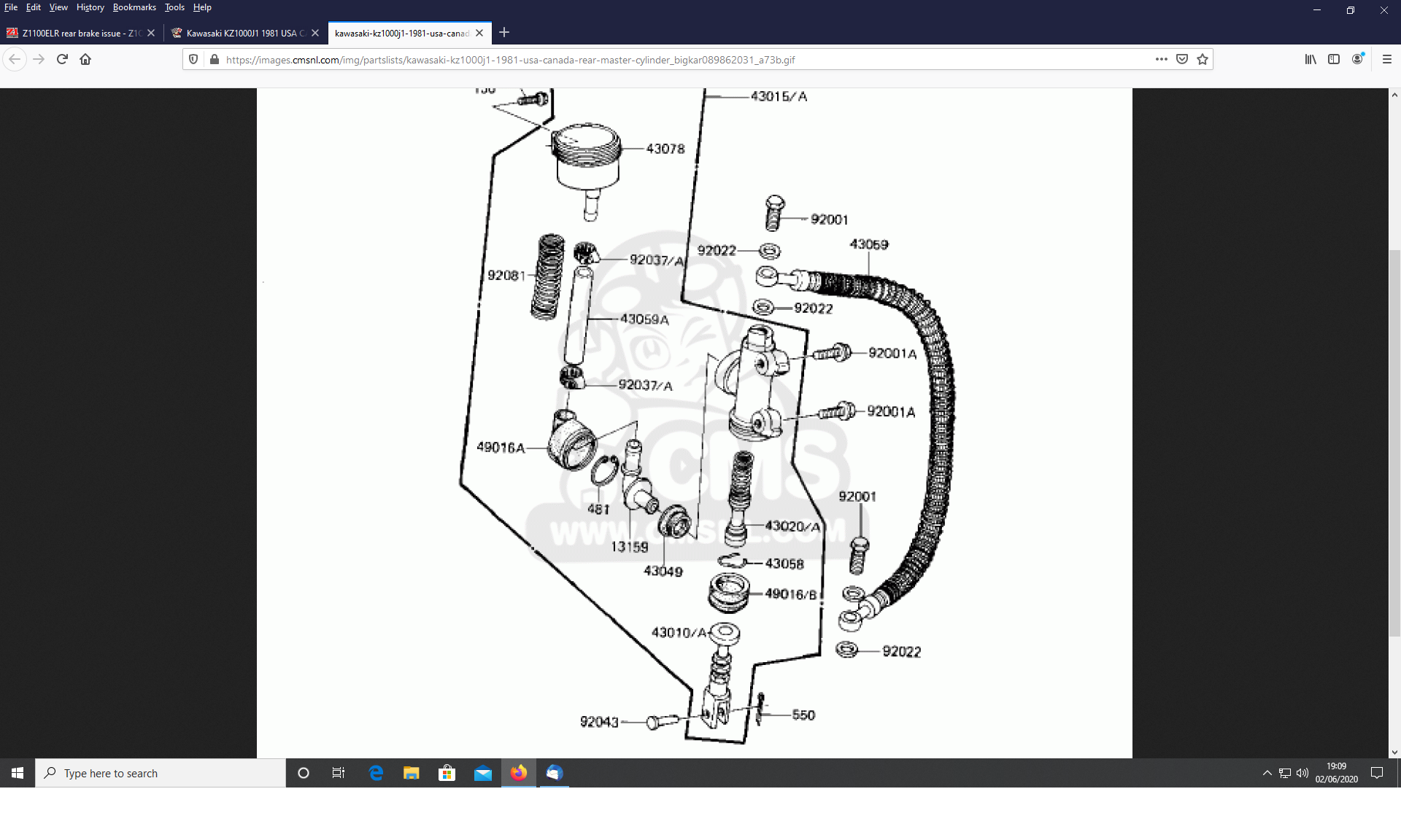

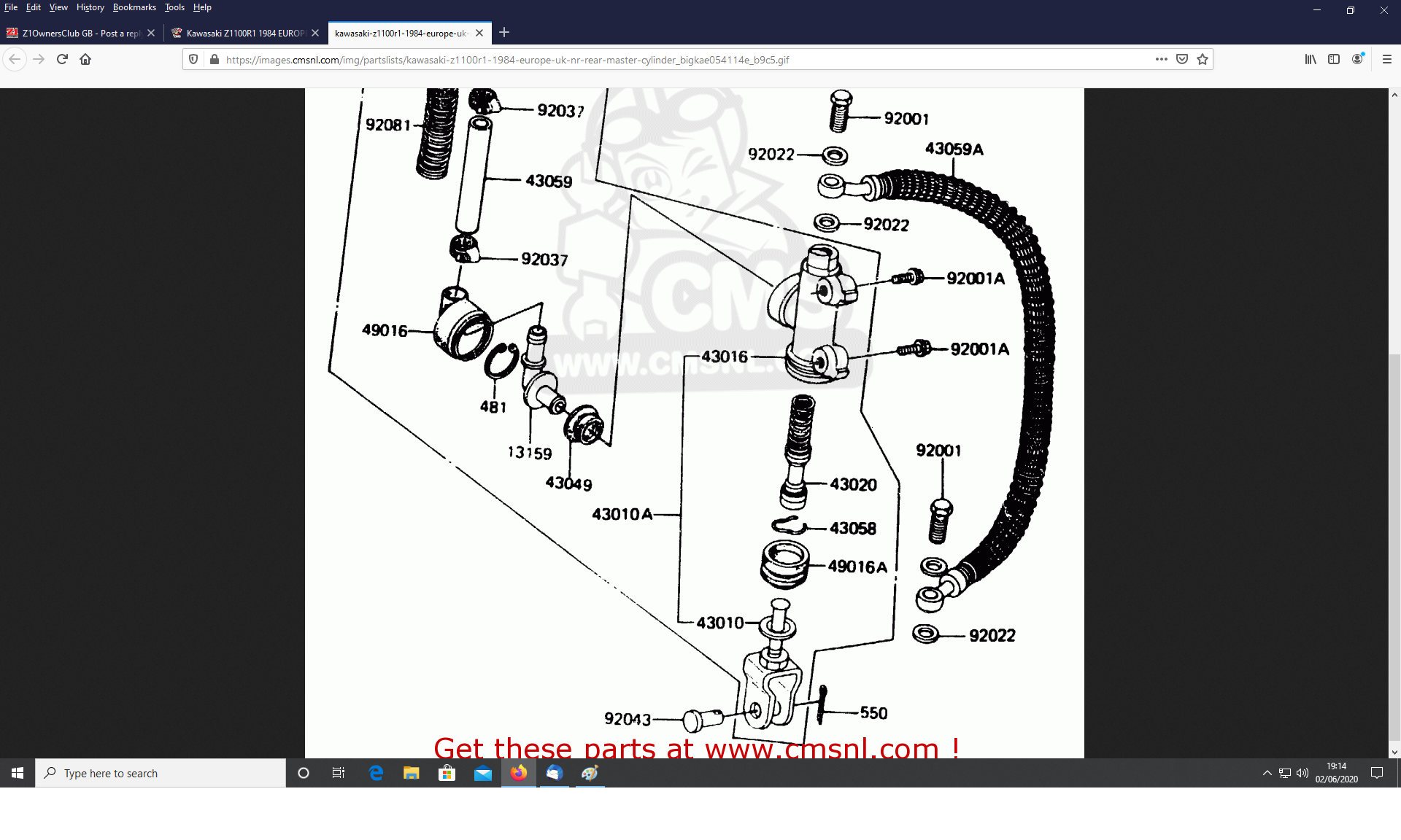

Re: Z1100ELR rear brake issue
USA J1 1981
https://www.cmsnl.com/kawasaki-kz1000j1 ... 62031.html
1100R1
https://www.cmsnl.com/kawasaki-z1100r1- ... t/14E.html
My rear brake on the J1 jams on frequently because of the anti-rattle sleeve on the rear sliding pin. Despite having replaced it with several genuine K ones and used; green grease, black, yellow, red rubber grease and vaseline and nothing at all it still swells up and buggers it. Dumbfounded and have gun drilled the sliding pin and the rear of the caliper and no change!!!!!
Thanks for the lovely clear diagram and to 8 valve mark for the offer , I will post an update , but looks like I am not alone with this

Got down to the bike shop today and had a proper chat with the owner who was pleased to find I still had the original piston as he was unhappy about the quality of the pattern kit originally, but hoped it would bed in, I just never got round to using the bike last year due to holiday job.
So the pads apparently wont push back properly for reason you suggested Philippe?
He is convinced he can get a toolmaker friend to machine one, and refit the seals and take it from there, so happy to see how that goes.
The OEM part it still a source of uncertainty with the best option being part no 43020-1019 but no certainty it will be the same, very very frustrating trying to get to bottom of all this, thanks for all replies in meantime.

So today,
I got my bike back, the guy I use has finally satisfied himself that the problem is the master cylinder body is corroding away, and that the seal kits are not addressing the issue, but he has cleaned it all up using original piston and it is all freed off, with no leaks.
Given that it is a 35 year old bike, I can see his point, and BTW I was charged £46 for his time and trouble for a caliper rebuild, all new copper washers, clean as a whistle.
I have sent Oz at Z-parts ltd a piston supplied by 8 valve mark which he may be able to replicate for future rebuilds, I just need to get the low speed fouling issue sorted, thanks for all help
