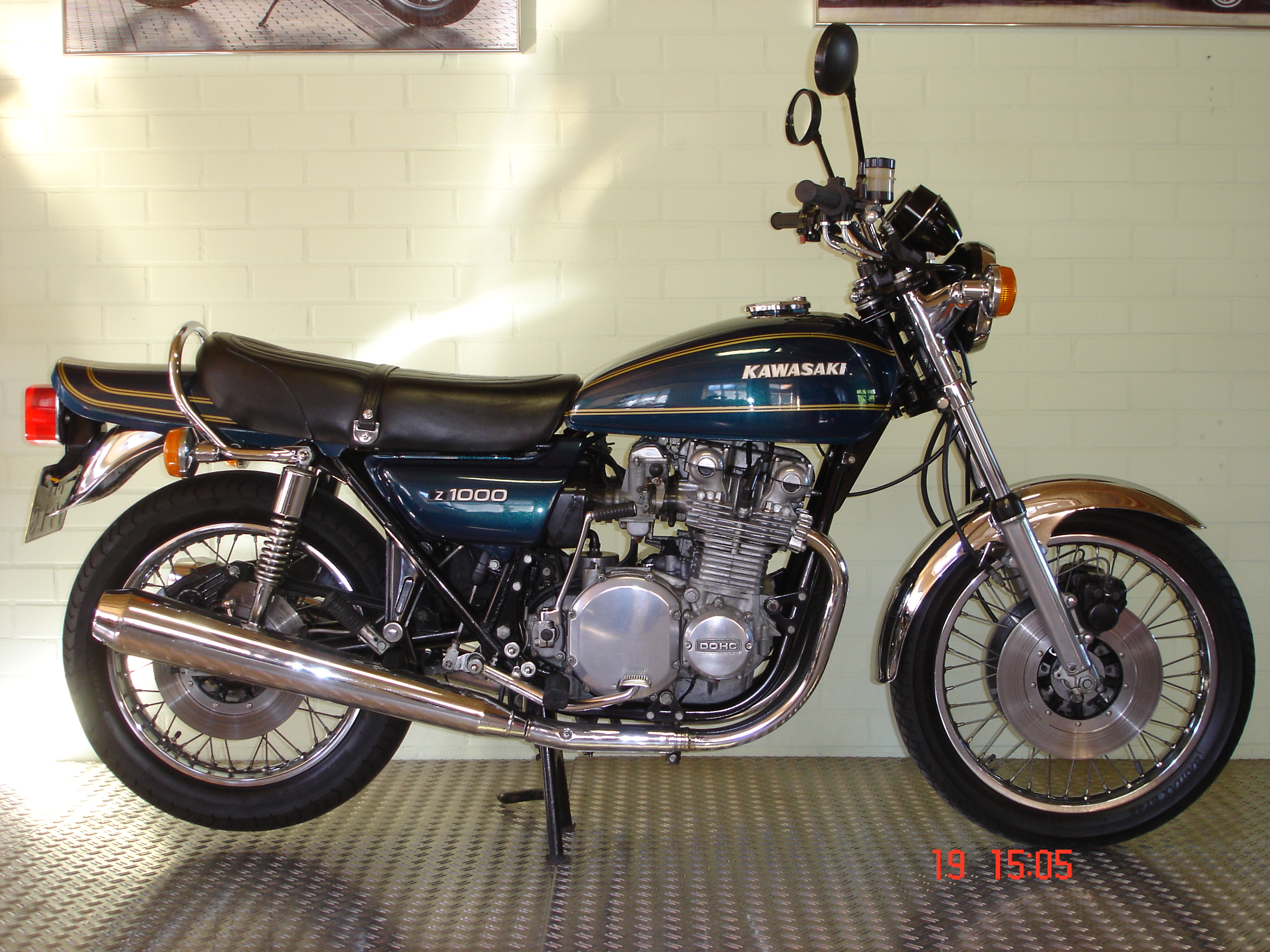

Actually found this in another post that is in line with your suggestion.
The A1 colours are a thorny old issue. I went to see one the other week that had the original paint and stripes and it was midway between green and blue. I gather the colour was achieved by spraying a 'candy' tinted lacquer over a silver base coat - hence the huge variation - so there really isn't one 'definitive' colour. i have a theory that they achieved the colour by spraying both blue and green candies?
Anyhow, here's a pic of the A1 KZ I own in the States - original paint and VERY green - though you can see the blueish hue on the ducktail - if you squint! Ignore the brown patches - that's the colour it fades to after prolonged sun exposure! Kwacker paint is wierd.
Hope that's confused things for you...

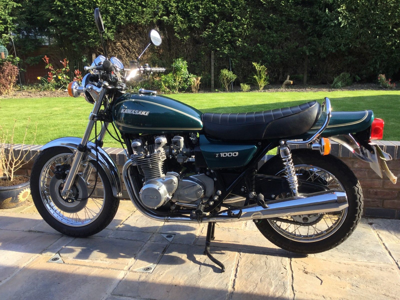

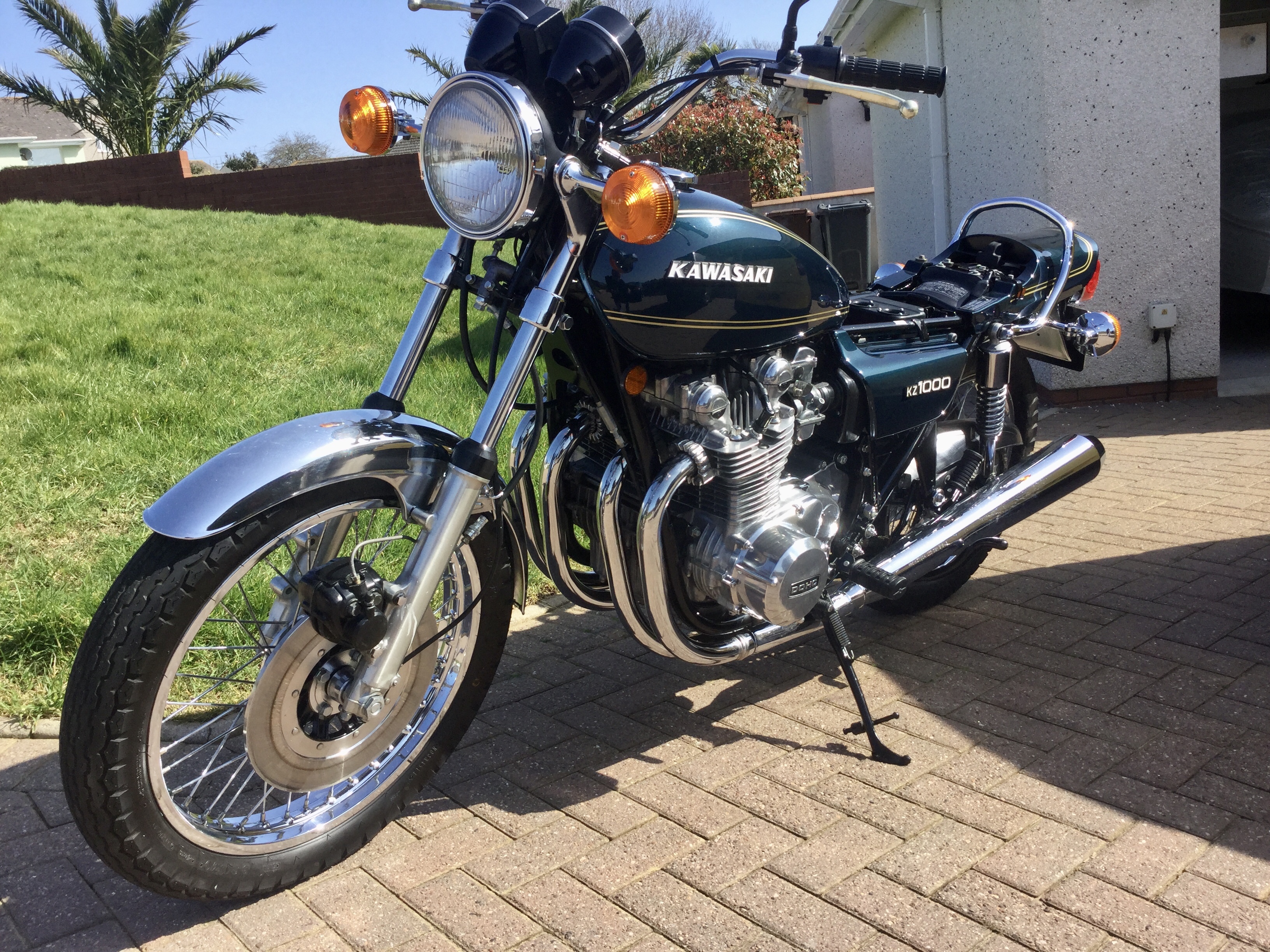

David, my A1 is original paint. But post a pic is a bit useless as everyone has their screens set differently so it looks different to every veiwer.
Heres 2 pics of mine. Looks very different in different light.

warren3200gt wrote:David, my A1 is original paint. But post a pic is a bit useless as everyone has their screens set differently so it looks different to every veiwer.
Hi there
Wow! that is just the perfect shade IMO. That's how I would like to do mine.
What a beauty.
It is remarkable the variation in colour hue between A1s made in the same year.

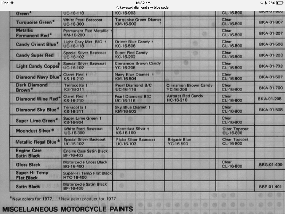

Re: Z1000 A1 - Metallic paint or regular?

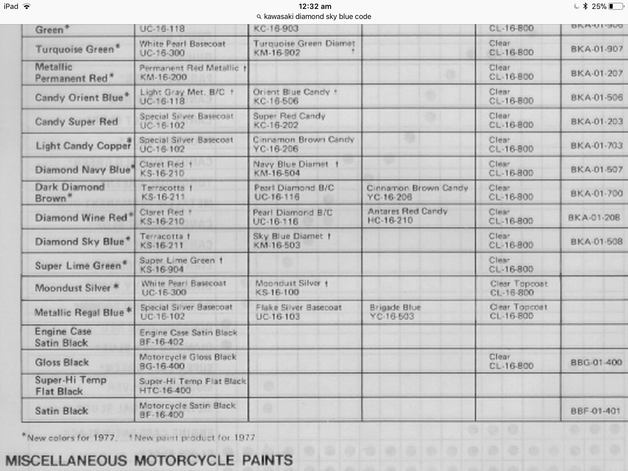

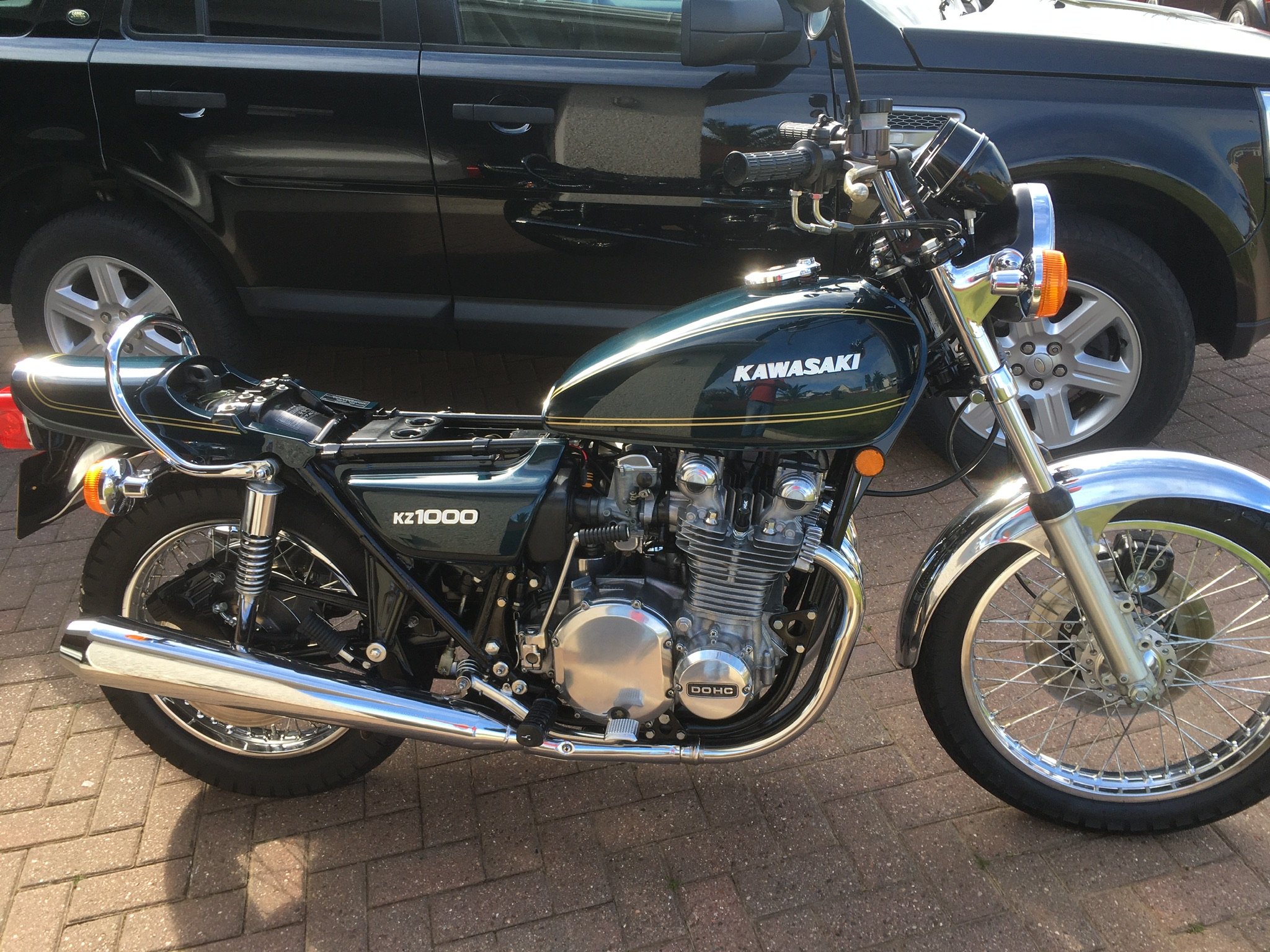

Just had mine repainted, so many different versions of diamond sky blue out there, really happy with mine, I did find the paint codes for original finish but I ended up having made up with a matched colour and a blue fleck lacquer ..
Pic of my finish which can randomly look blue green and black plus the paint codes chart
