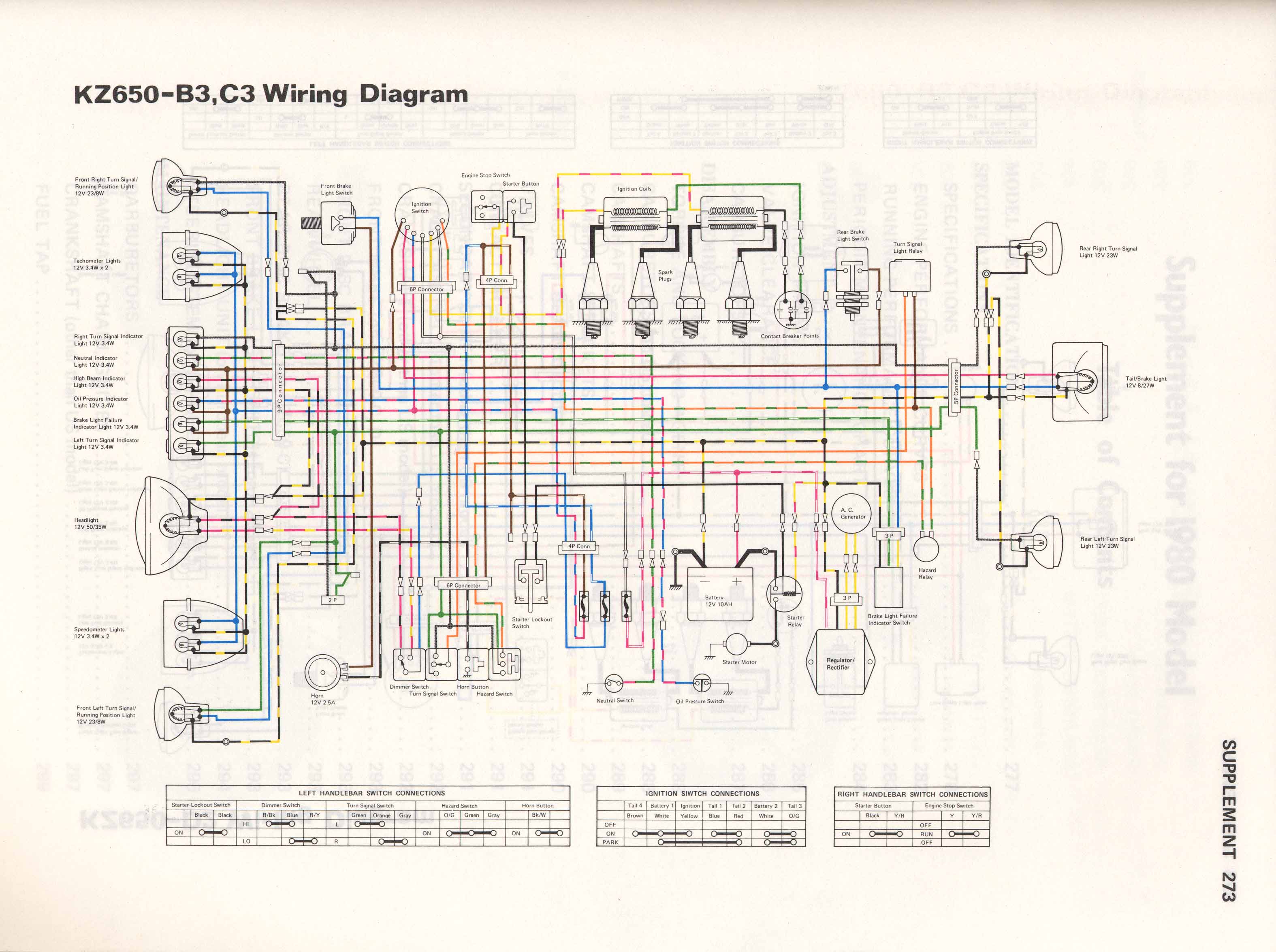

Quick Q - Reg/rec has 4 wires for the single phase alternator. Two yellow wires to the stator wires, red/white for the feed and a black .
Is the black the earth for the reg/rec?
If s,o I may have a bad earth here - which may account for the problem.

Warren
That wiring diagram is superb - very many thanks. Will also come in very handy during the restoration. The Haynes diagram is total pish. Tested the now confirmed earth wire - closed circuit to earth, so all seems OK there. Bought a second hand Shingenden reg/rec off Fleabay so hoping that will fix it. if not - could be alternator!.....
