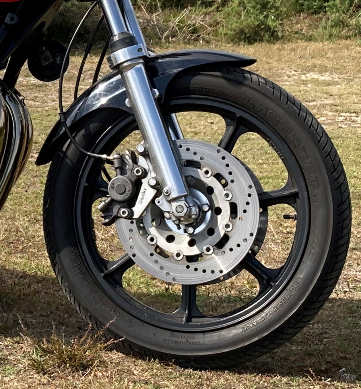

#11 PostAuthor: ADRIAN H » Mon Aug 31, 2020 9:29 am
Have AP Calipers, with a mounting bracketS on the front end of my Z1000. A bit of a bugger to bleed, but good stopping power.
