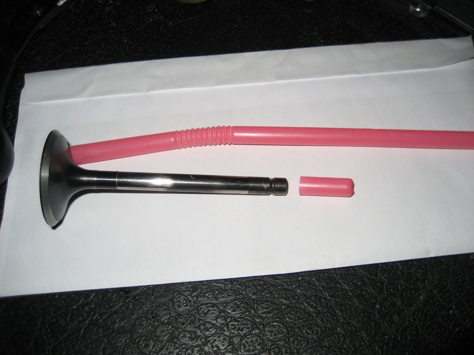

It's a long time since I did it, but I rebuilt a Klr 650 Tengai engine and from memory, the valves are inserted into the head and sellotape or similar tape wrapped around the top of the valve stem, then oiled and the valve guide oil seal slid down to avoid damaging the seal on the collet groove. I don't remember having a problem. Sorry if you already know this, but if you don't, it might help. I don't know about the oil compatibility.
