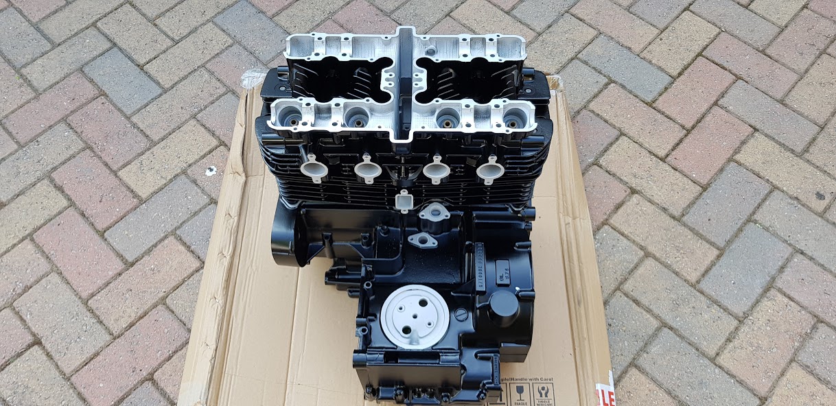

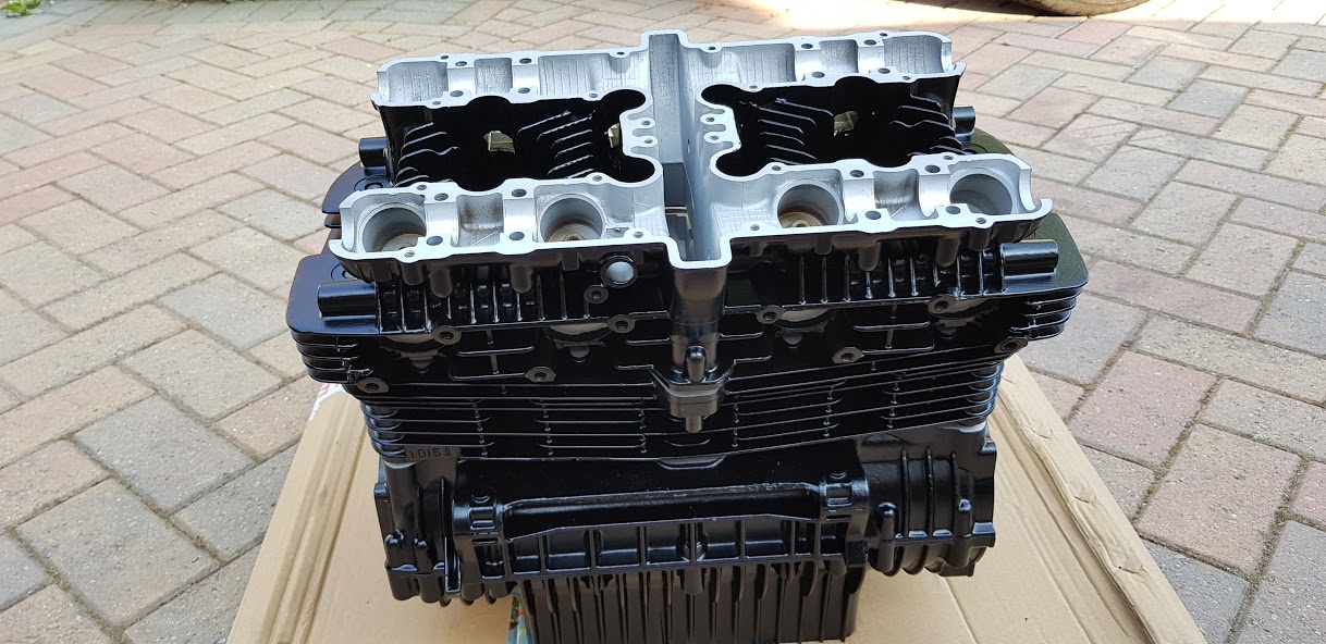

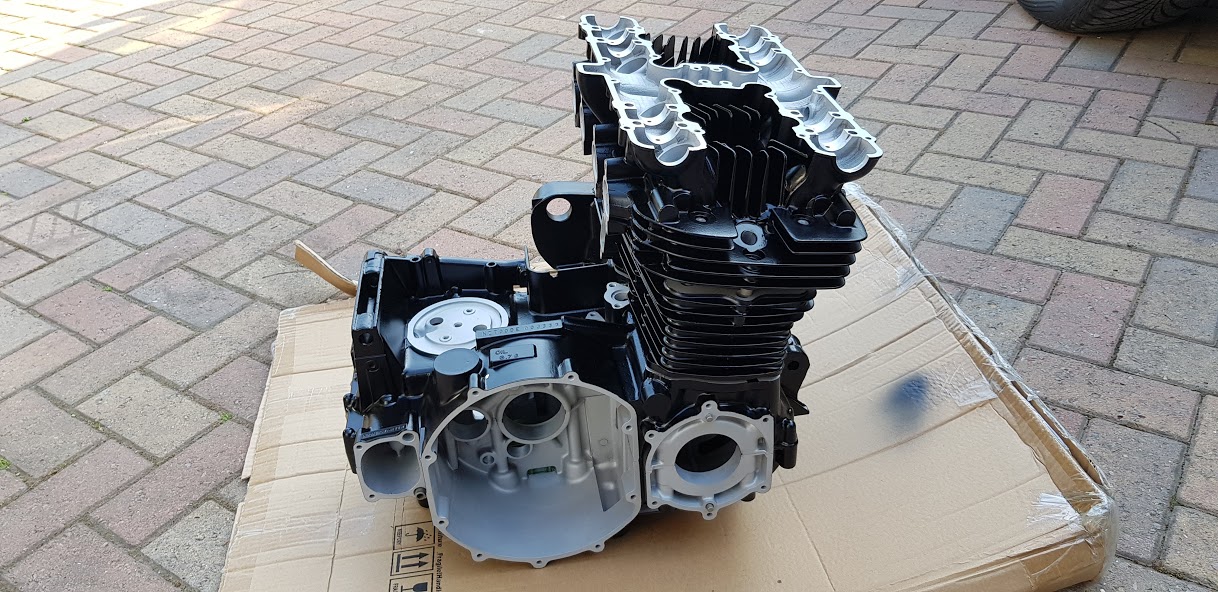

I have recently done a Z1R engine, to look like this after vapour blasting and painting with 2 pack satin black. This would be the top/bottom crankcase halves, barrels, cylinder head and cam cover except for the polished end half circles.
Whilst getting the engine done in satin, you could get the top yoke, switchgear cases, master cylinder, brake calipers and rear light mount done. If you get a copy of John Brookes excellent restorers book for the early Z1's, this will show you exactly what is what regarding originality. (1972-73 Restorer's Parts Book).
The cases need a THOROUGH cleaning of all the oilways and passages before rebuilding. The edges of the cylinder fins will also need to be rubbed back to alloy and polished. Get all the screws and bolts replated (except the internal crank ones). Use the parts manual to identify all the correct screw lengths, especially the ones that screw into blind holes. Oh, and clean every single thread out with a tap before rebuilding. I left my barrel studs in for the blasting/painting. You can protect the centre studs from road grime by putting heatshrink over them before refitting the barrels.
