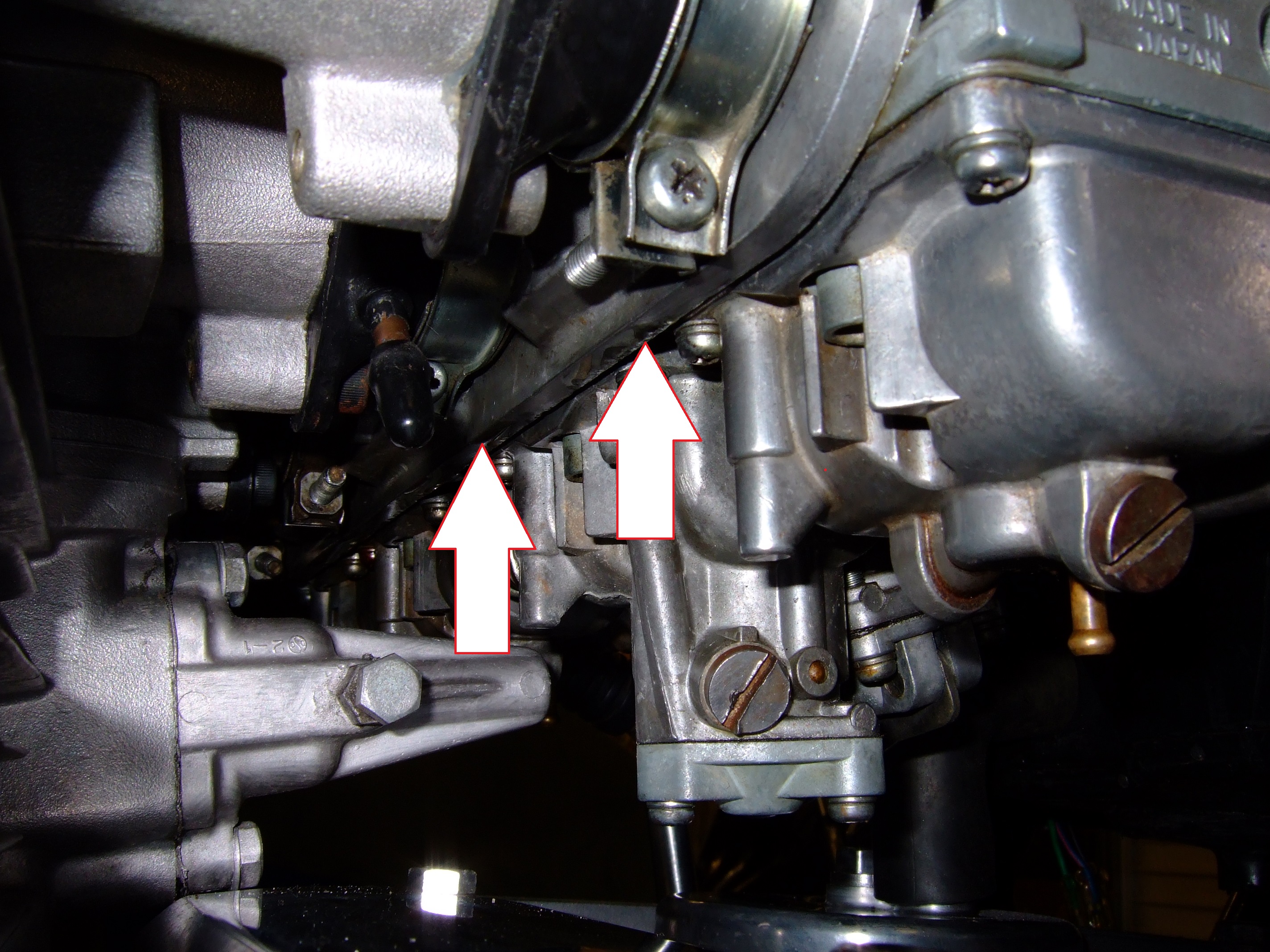

Is it possible to remove the float bowls in situ? Don't fancy taking the carbs out - a real pig with all the air intakes.

You can do Oggers they will come off ok but they are a bastard to get the bowl screws all back in and tight.

Agree with Warren, you can take the bowls off in situ, 2 outside ones not too bad, inner 2 can be a bugger to get screws in .

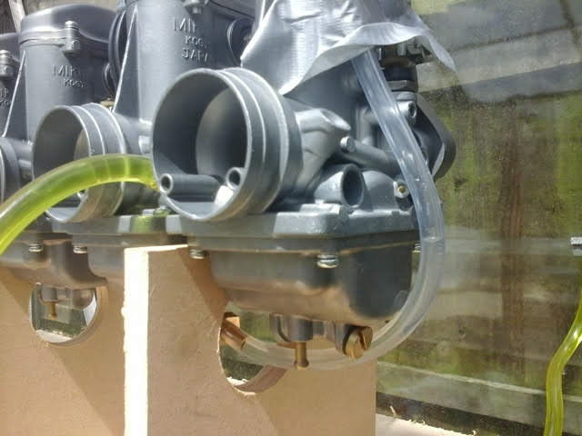

Presumably you bench sync'd the carbs? Now its running you need to live sync them. Evens and smooths things out hugely.
Have you wet tested the float fuel levels with the clear tube method
Getting the carbs set correctly on these bikes is critical to good and smooth performance.

Float fuel level makes a big difference aswell. Easy to check, not so easy to adjust but well worth at least checking or doing whilst they are off the bike.
